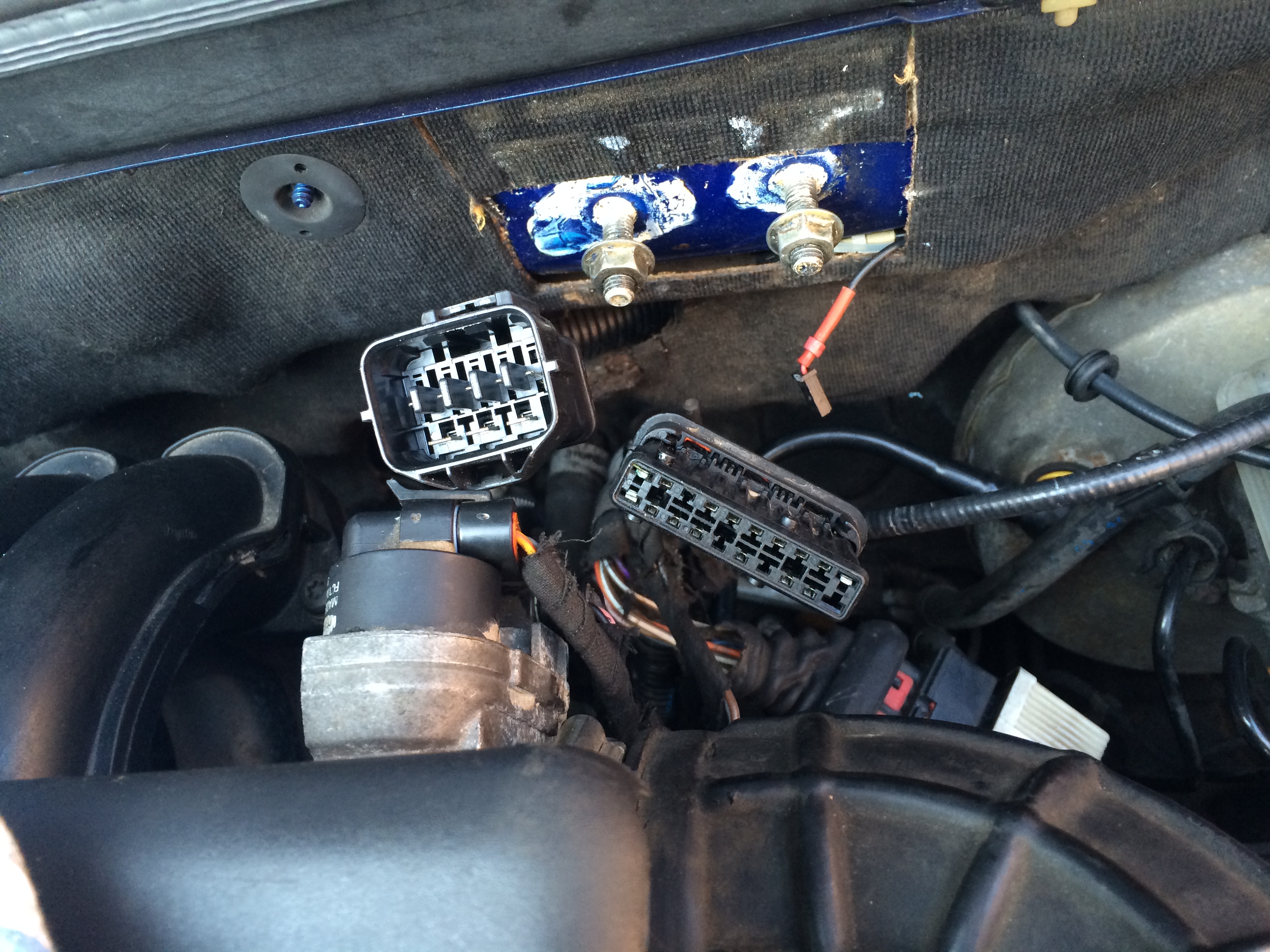

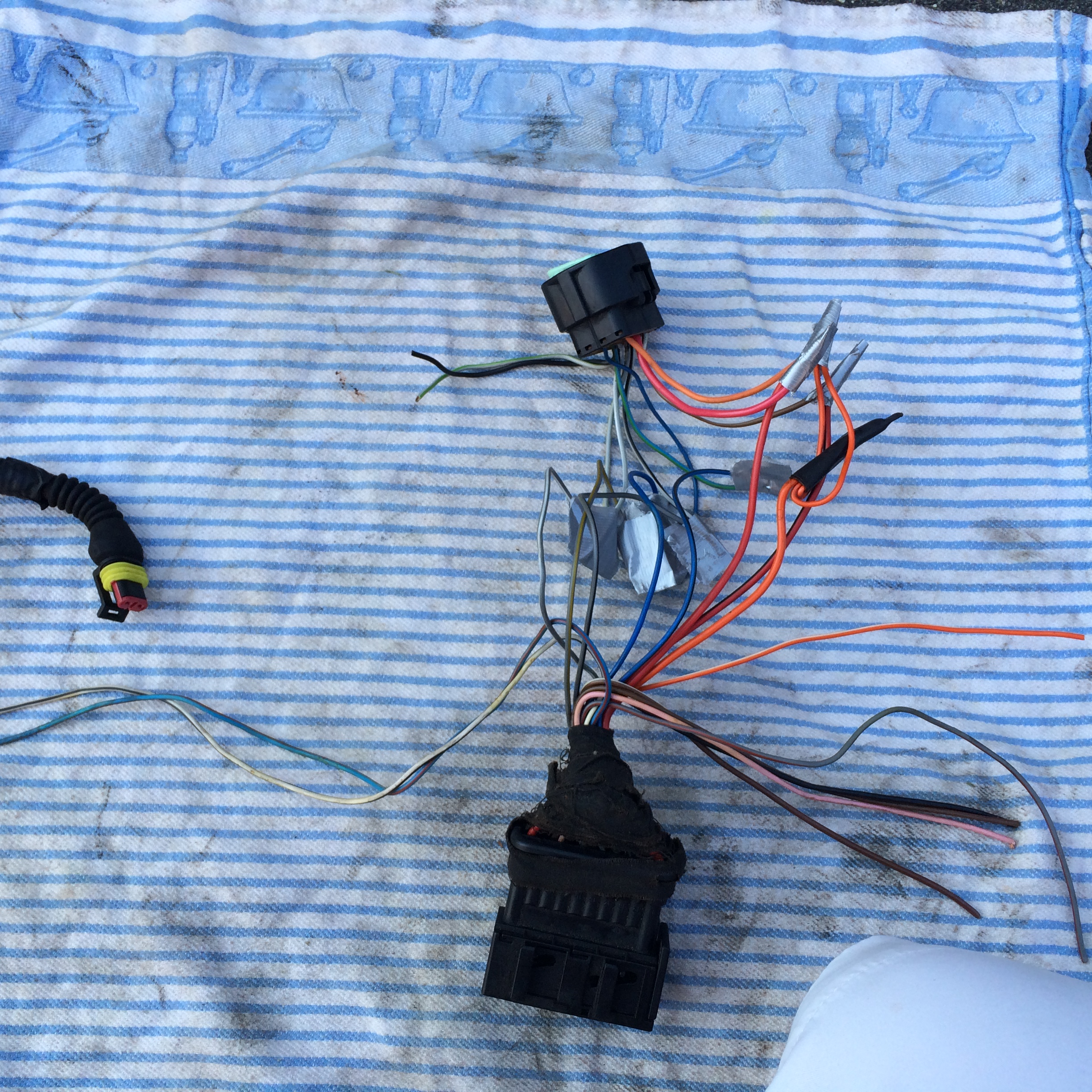

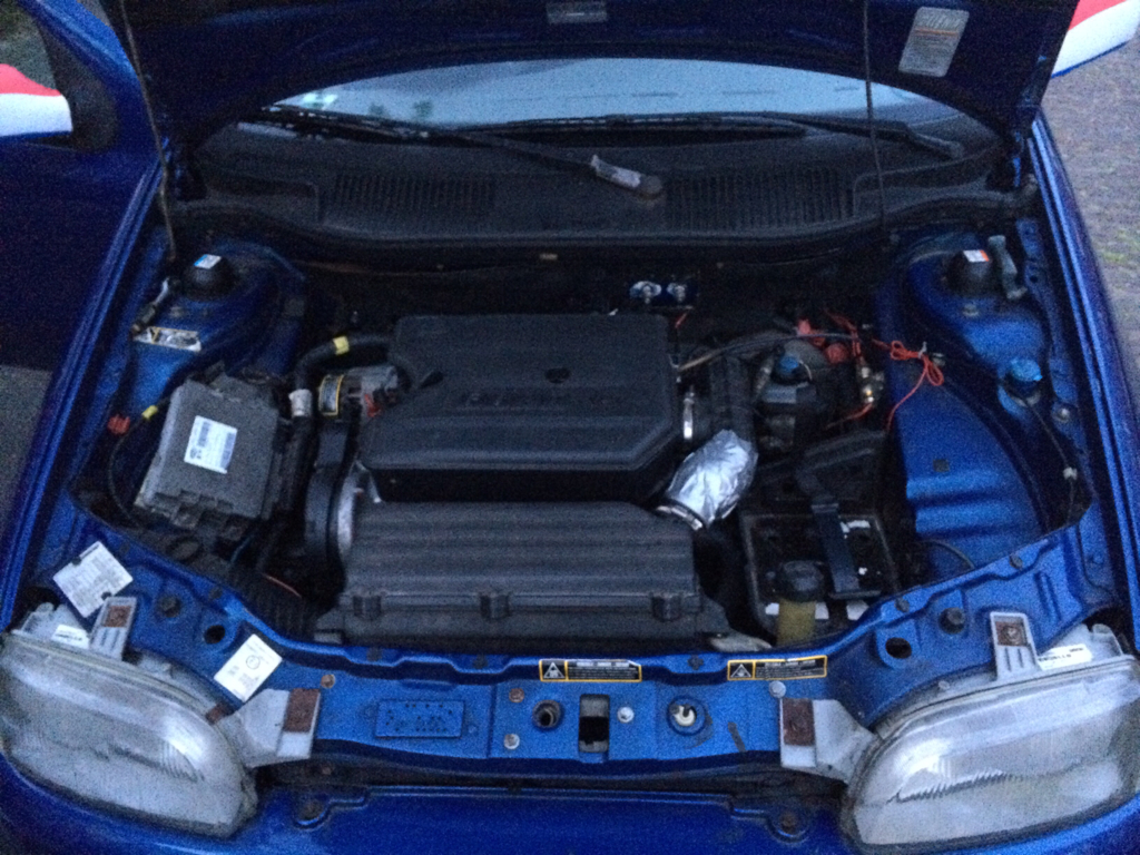

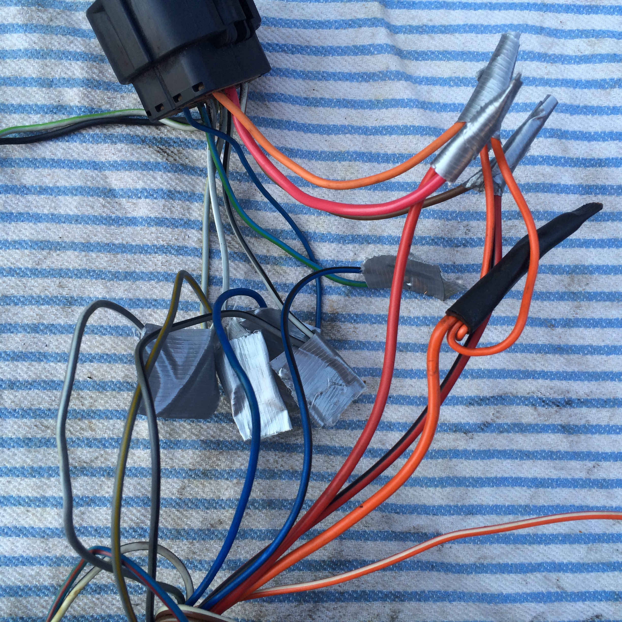

Hello i'm putting a 16v in my 8v punto mk1. And i don't get it to start. Here are some pics. Off the wiring. Can somebody help me with this?:bang:

P85 uses codebox too, same series, all plugs onto the same plugs as 8v. codebox needs to be from the same car as p85 ecu and also key is needed too, unless you get the ecu blanked/virginised which will allow you to use your old key and codebox
Hahaha thanks everybody for the help. The/my P75 has no imobilizer. And the P85 does. So i have to make it my self. I think. I have the key + ecu from the 16v engine. So i got what i need. To make it work. I'm going to the breaker this week to find the parts/connectors that i need to make it work. Gonna let u guys know how its going. And hopefully it will stop raining. Cheers!ImageUploadedByFIAT Forum1404816189.752038.jpg
