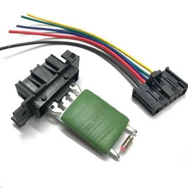

Hi guys,
help needed with heather/ac blower under the glovebox.
Few weeks ago found burt contact on the controlling electronics (near the fan). Changed it for new one and still don't work. Fan works, fuse is new.
Don't know what's next. Maybe relay? Can't find which one.. Anyone help?
Thank You

Fan works (tried to connect it on 12V and it's fine), speed regulator is new so as fuse..
Separetly works everything perfectly fine, but together when I turn on heather/ac fan wont start.
Fan inside the car, under the glovebox is not working. Works separetly, but all together it wont blow the air..

Does sound like a new fan control switch and maybe the wiring plug also required.
It may be worth checking that the fan is working freely and not overloading the circuit causing extra heat in the wiring plug/switch area.
In the past the heater fan speed resisters fitted to the side of the fan housing used to fail on Fiats, now they have moved the weakness further along.;)
If no obvious cause then all OP can do is replace damaged parts and check correct fuse for fan is fitted.

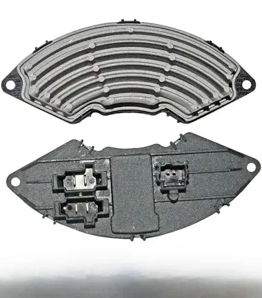

1: Manual A/C
2: Or climate controlled A/C

Fan freely works, everything is new even the connector has been replaced
Second option is mine
Right that's a variable fan controlled by a digital pulse width modulation signal
I have no wiring diagram for you car, will it be close to the grande 199
Fiat usually use a relay and fuse at the front end
And control the fan via the body computer, climate control system, and the fan speed variator
If it was my car, I would start by using bidirectional (wow) software and read the codes and perform an actuator test to switch it on
Not sure if multiecuscan or alfaobd is capable of integrating the climate control unit
