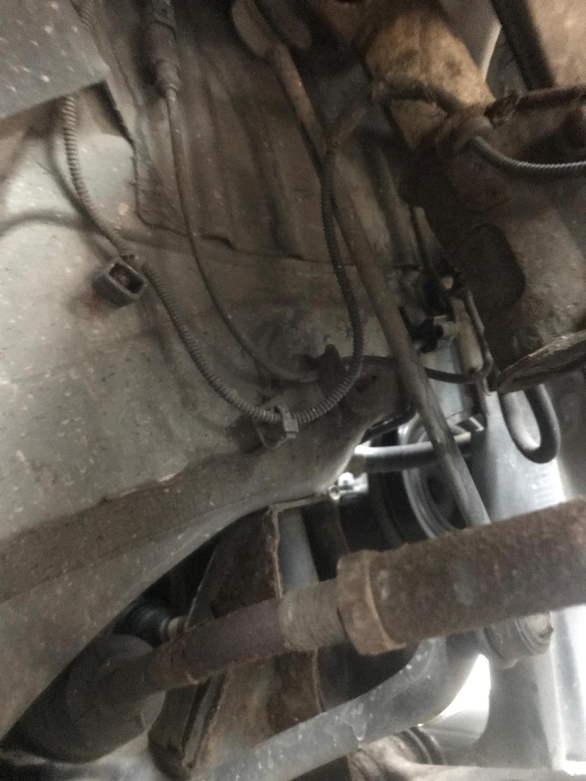

Hi,
somebody last week backed into my son's Punto while in the parking lot. Their bumper went straight into the driver side tire and now the wheels are no longer aligned. It does not look like a big job so I just wanted some feedback from the experts on the boards.
I attach a picture of the tie rod which looks to me like it was bent by the impact.
What else should I look into?

Just an update on progress... got the inner tie rod off. :)
But they sent me the wrong part. Looks the same just mine is a male and the one they sent is female. Added pictures just to show how it's going.

So difficult to advise on this from my living room seat. However I've seen damage like this before and each part needs to be separately assessed. I'm tight fisted when it comes to spending money so will only replace parts that obviously need it. One I did had almost identical damage to the tie rod. couldn't see any obvious damage to anything else so I replaced just the tie rod and track rod end, adjusted the toe took it for a long drive - about an hour on various different roads and speeds - It drove nicely and subsequently showed no strange tyre wear the next time I saw it about a year later. I don't see any reason, from your pictures, as to why I'd do any different here. Steering racks are remarkably tough and, especially if the shock was mostly applied to it along the axis of the rack, no reason why it would need to be changed. Of course check it for smooth operation lock to lock and for play in the bushing on the N/S end and against the pinion and bush on the pinion end.
Whatever you decide, the only way to be really sure it's ok is to get it on a chassis bench, like a Hunter, and check all the angles. A check like this, if nothing needs done except maybe a wee "tweek" to toe settings, will probably be in the region of £80? Been quite a while since I've had one done.

Update on the situation. So, after having to get new parts, we found a few dry days where we could work on the car. To be fair, this was not a really difficult job. I did have to purchase a special tool though to remove the inner tie rod end (see picture and link below).
We approximated the distance for the outer tie rod as the old one was totally bent out of shape. Also, had to cut the old tie rod with an angle grinder to get the rubber boot off (couldn't take it apart because it was way too rusty and bent).
For the moment, I put an adjustable metal clamp on but I will put the same type like the original in the future. They have the tools on Ebay/AMZ like @AnthonyH and @Pugglt Auld Jock mentioned, but we just didn't want to wait longer.
My son saw the link the @Pugglt Auld Jock shared for the alignment and decided to go to a local shop to get it done. :)
Needed to replace a tire anyway so got it all out of the way at the same time.
So from a steering perspective, it seems this was the only broken item linked to the accident. However, as some of you may have seen from my other recent post, there was also a problem with the alternator (needed to replace it in the end) and changed the belt size and the tensioner while we were at it. That seems to work great.
