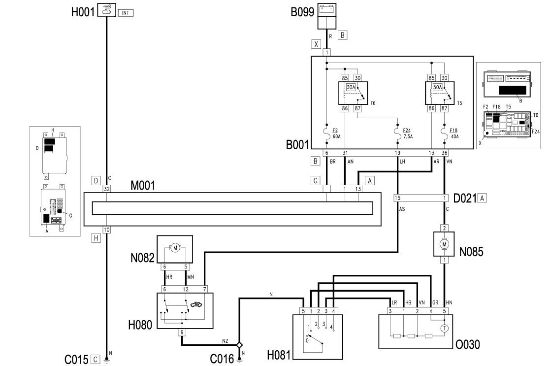

First thing...
The switching is on the Earth side so you won't get Live on the resistor.
Live goes straight to the motor and then the Earth runs out through the switch and resistor.
Now the main point...
These Heater Motors decline with age and then overload the Resistor. So the real fix is to get a new Motor. Yours has burnt the resistor then seized so it won't even work on position 4
The wiring diagram
N085 is the motor. C016 is the Earth point

Thanks for the explanation, That explains the voltage showing on the plug into the fan but not the resistor. So replacing the resistor was worth while also as its probably cooked the old one. Can the motor be changed or is it the whole unit that needs to me changed?
