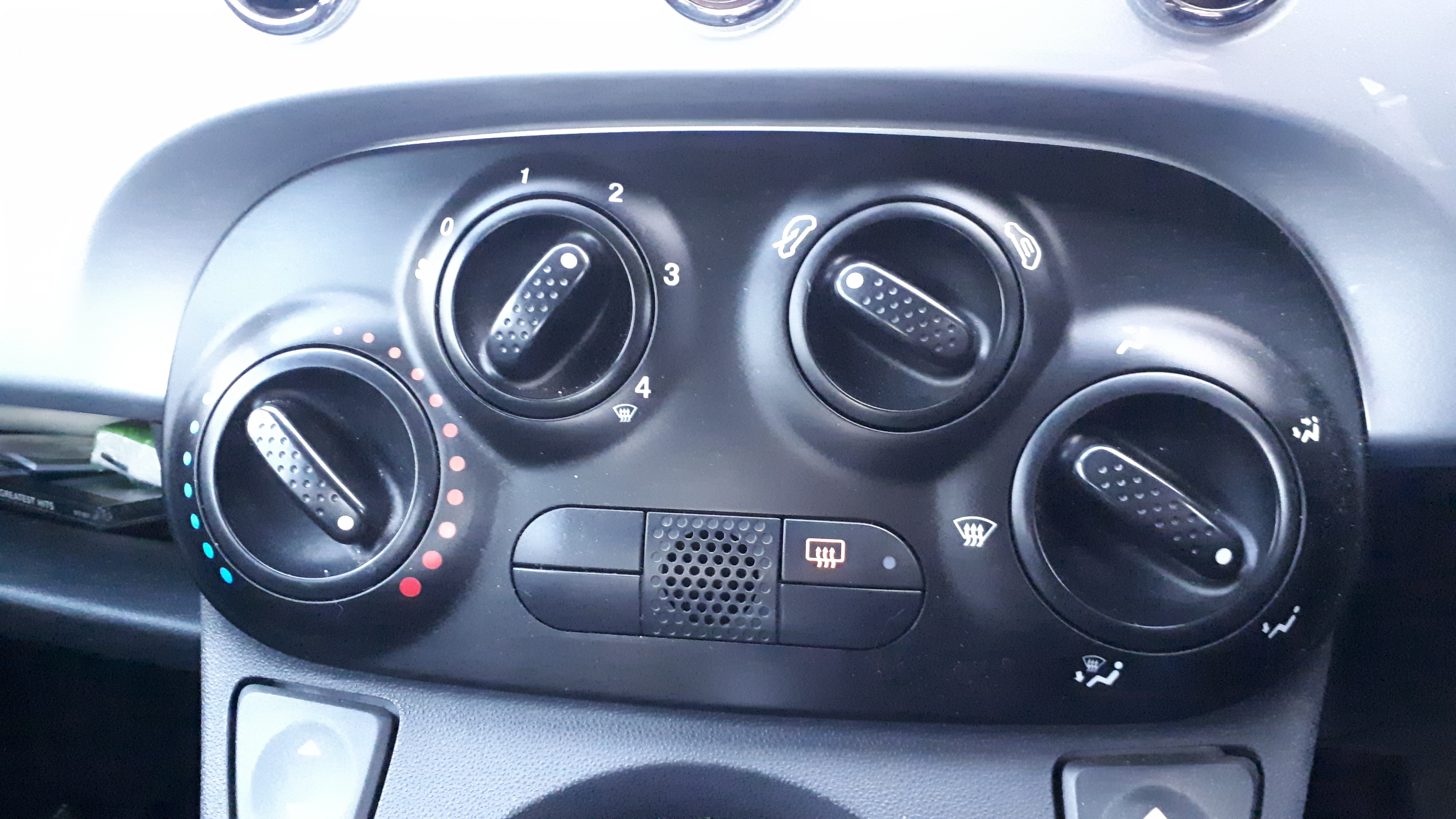

You should have 4controls for the heater
First one is temp with a red and blue bar to set temp left is cold right is hot
Second dial is fan speed 0 is off 1-4 is fan running at various speeds
3rd is for if you want the car to recirculate the air or not
4th
dial is for where the air is directed to e.g windscreen feet or face
If its any help this is how ours is generally set in winter after defrosting
