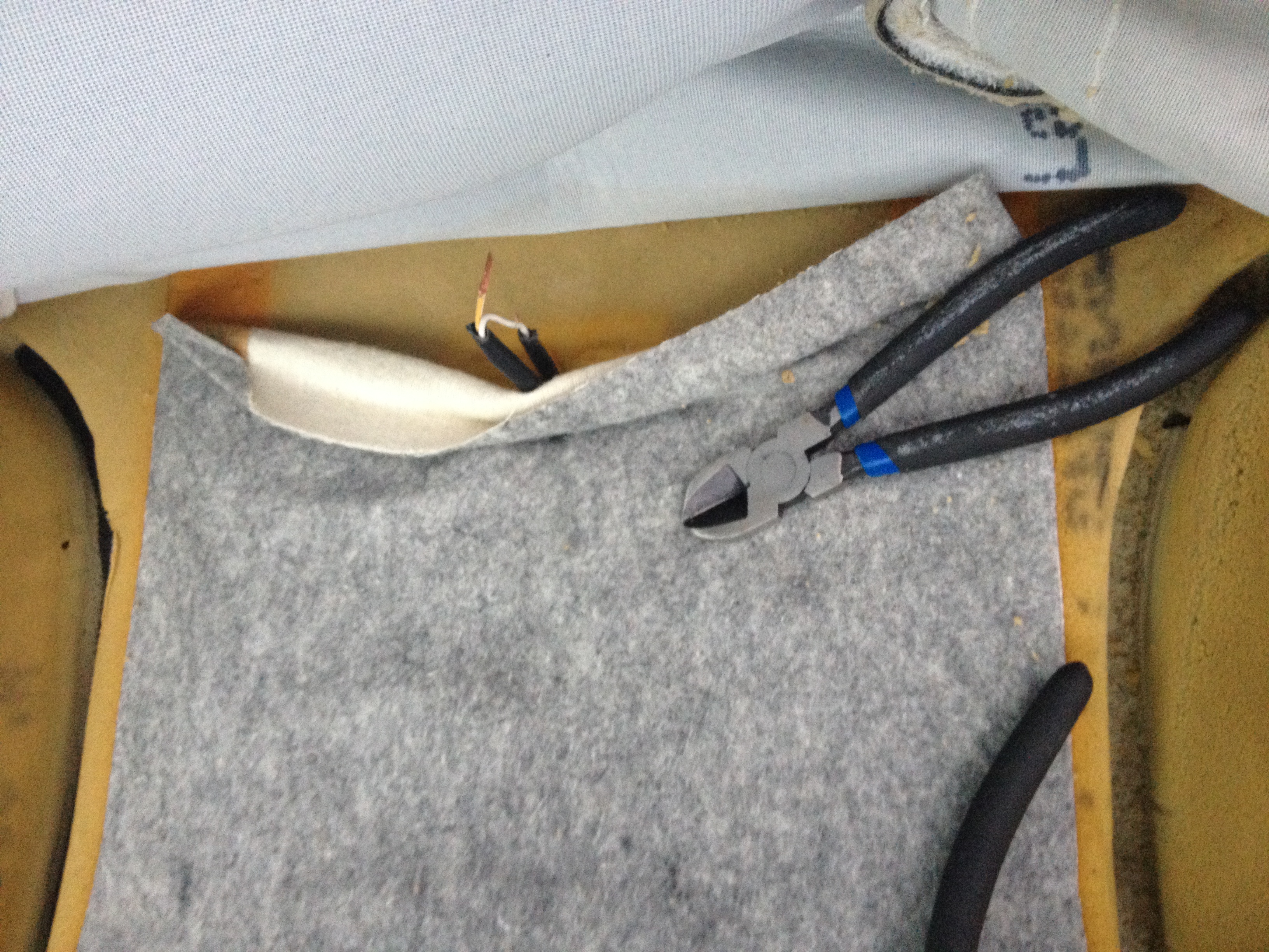

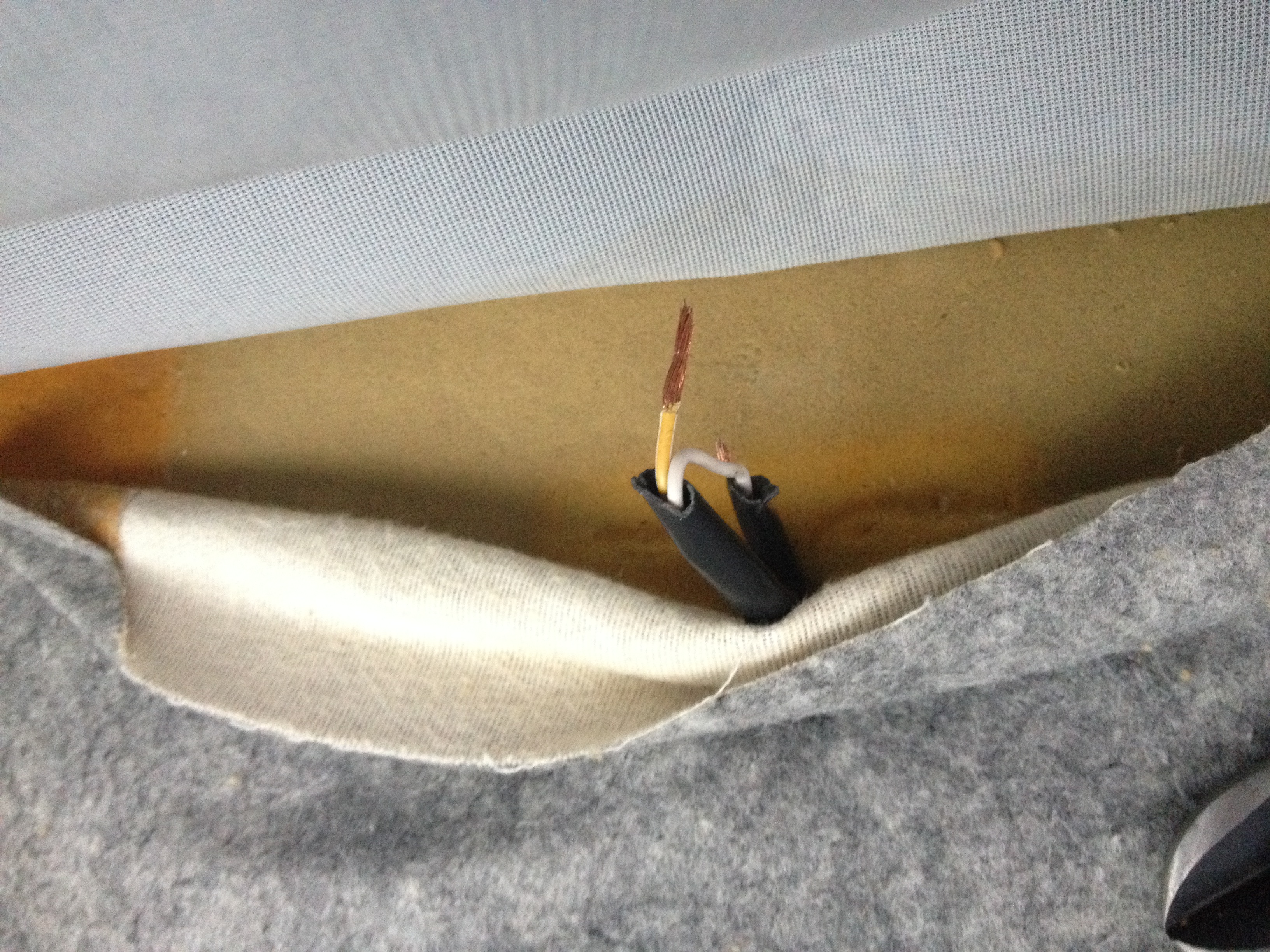

Yep had this problem on all three of our stilo's in the family and its a dead easy fix!
Basically take the seat base cover of by peeling it back. You should now see a grey coloured cover over the foam rubber. Feel around at the back of this/underneath there should be a small metal thing with wires on it ( the thermostat for the seat). This is usually where the wire breaks. Stick your finger in the hole in the foam rubber and pull the rest of the wire back up through the seat. Just get a soldering iron and some solder and put them back together. Tape them up to stop short circiut and the job is done.
Now try the seat. You should have anice warm backside again.(y)(y)
I was uttedwhen mine stopped working and it turned out to be this and then it happened on my dads and then on my sisters. We went straight to the problem on the second one!
I reckon that the wire breaks due to the seat being moved backwards and forwards.

could you explain in more detial how you do it?
Would i be cheaky to ask for some pictures????
Unfortunately I didn't take any pics ( NOTE FOR EXT TIME)but it really is dead easy. Peel back the cover on the seat base. its a little awkward but it will peel back, start at the front of the seat. You should now see the foam seat base in all its glory. The heating eliment is the grey felt like material. Push your hand between this and the foam seat. Right at the back of the seat you should feel the small sensor with wires on it. just take hold of it and pull it up gently. . This is usually where the wire breaks. Just reconnect the wires with solder or some kind of terminals.. After this recover the seat and thats it done. Takes about 15mins to do the whole job. P.S the seat cover is held down with Velcro in the grooves. Make sure you seperate them as you peel the cover back and dont just pull it away from the foam rubber.(y)(y)
That does seam easy, i will check it out tonight, and let you know...
Nice One! The sensor you are looking for?can't miss it really its the size of a penny! Hope it works for ya, I know what its like in UK without heated seats so in your country it must be hell! They are sooooooo nice! Keep me informed, any trouble I will try to help you out with some more advice:);):)
Had the same problem and tried your solution. It indeed was a broken wire. The worst part was peeling back the cover, also forgot about the Velcro, but looking OK again and working. THANK YOU so much! Living above polar circle so heated seat is quite a necessity.
