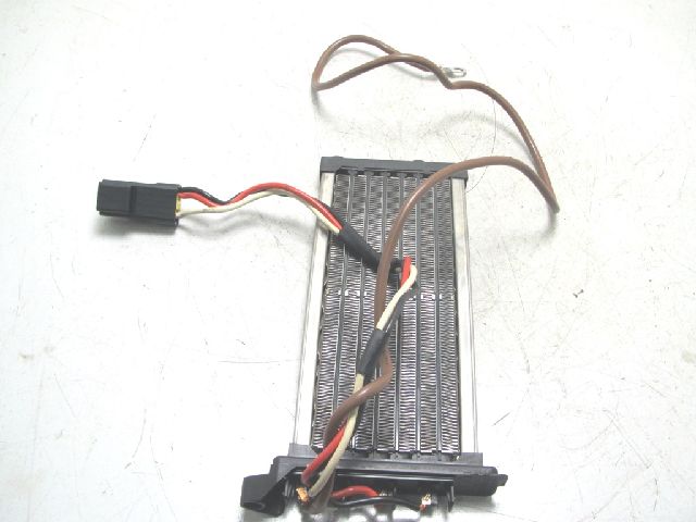

The separate green 30 Amp fuse inside the battery housing is for one element of the optional additional PTC electric heater fitted inside the heater casing of some models. Both of my Stilo JTD MWs have the fuse, but neither of them have the PTC electric heater.

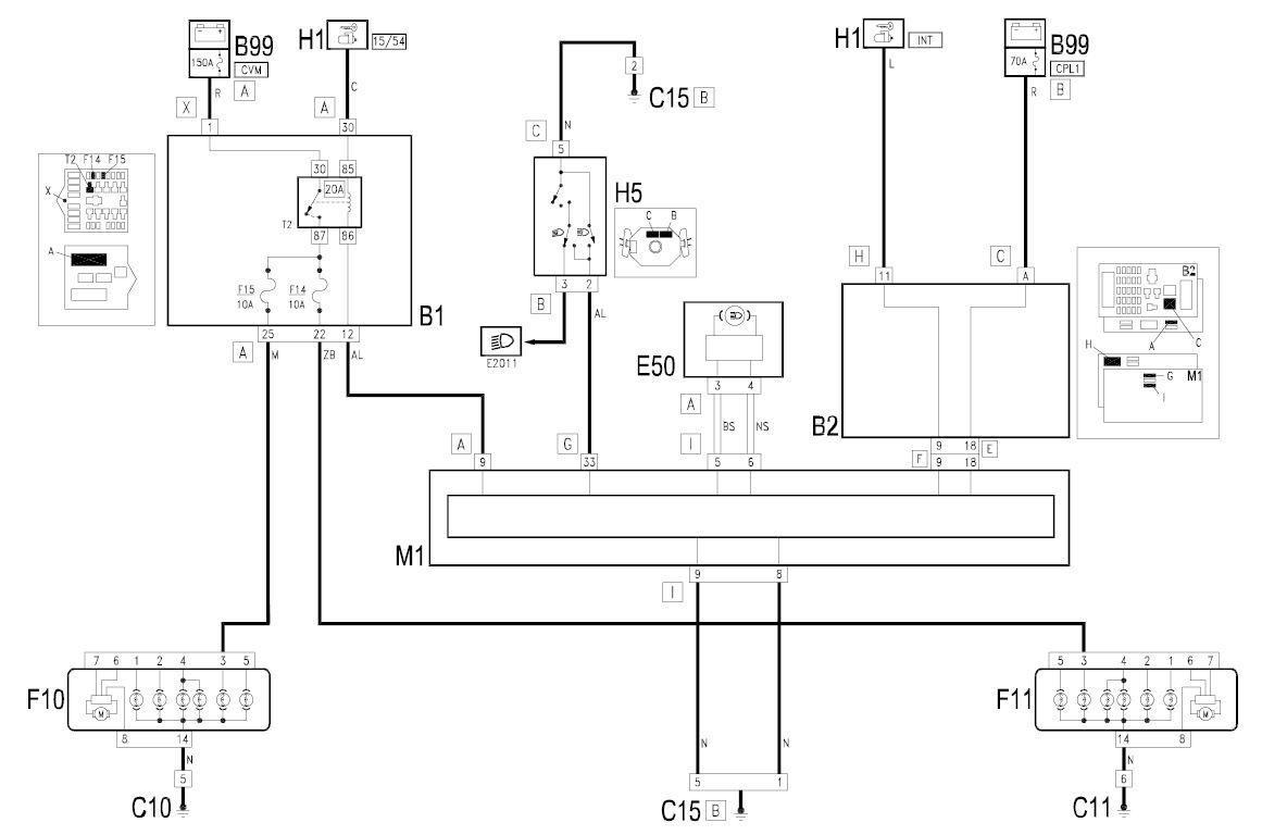

The main beam switch (H5) sends a signal to pin G33 of the Body Computer (M1). The BC then sends a CAN signal to the blue warning light in the instrument cluster (E50), and a separate non CAN signal to earth the main beam relay (T2) in the engine compartment fuse box (B1).
As the blue light is working, you can eliminate the switch and its wiring to the BC. As you say the relay (T2) and fuses F14 and F15 are OK, I would suspect a faulty BC, or the wiring or connectors between pin A9 of the BC and pin A12 of the fuse box.

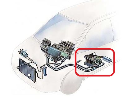

I'm not sure I have the aux heater
It's not for the auxiliary heater, it's for the additional electric heater. The auxiliary heater is a small diesel engine fitted under the passenger side floor. It has its own fuel supply and exhaust system, and is designed to heat the main engine coolant and heater matrix before you get to the car. It can be switched on by a remote control from inside the house, and was only an option on the JTD. Usually, it was only specified for very cold climate countries.

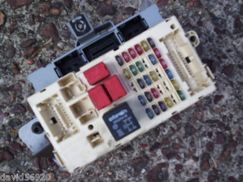

If the worst happens and I have a dodgy body computer, where does that live and if I plugged in another one, would it all work or would I need to re-program things? (My clocks already flash since the old ones died.. but is there anything else)?
The Body Computer is the grey box attached to the back of the dashboard fuse box. They are not stocked by Fiat dealers because each one is programmed to the individual car. If a dealer wants one, they order it from Fiat for the car's VIN number.
If you had one with the same part number as yours, it may work, but would probably need the Proxy Alignment procedure carrying out at a dealer or with MES. However, the car's immobiliser code is stored in the BC. I'm not sure if that can be reprogrammed with MES.

I would be inclined to check the wiring and connectors between pin A9 of the BC and pin A12 of the fuse box before anything else. Get your auto-electrician to check for an earth at pin A9 of the BC and/or pin A12 of the fuse box and/or pin 86 of relay T2 when the high beams are switched on.
