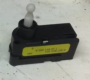

Interesting that your motor numbers are different to the one from my spare headlamp... That's 0-307-853-303.
I have no idea what mumbers the ones in my actual headlamps have... (any idea what the differences might be?). The ones I ordered are 1J0-941-295A which seem to be a match for 0-307-853-304 but also shown as generic "Stilo 2001 - 2006".
Hopefully they're not completely the wrong part.
The dismantled leveller in my picture above, and another dismantled one I have are both labelled 0-307-853-303, and both came from old headlamps in one of my Stilos. I suspect it's just a part number change.

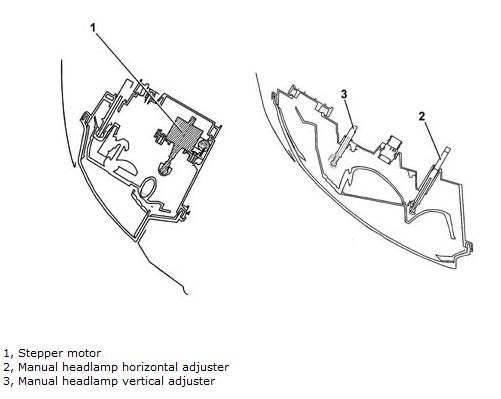

As an aside... Dr Death also noted the headlight beam was a bit high. I poked it at the garage door and the o/s looks about 3cm higher than the n/side. It's never been a problem before.. but then I did say the new guy is a bit moody looking :D).
Which of the plastic rods/waiting to snap off controls the light beam's pitch? I presume it's the one on the "outside" of the lamp assembly and screwing it in makes the beam go down a bit? Plenty of WD40 beforehand obviously... :D

Perhaps one of the beams is higher because the leveller is seized in the high position.
Knowing how easy it is for the plastic adjuster screws to snap, probably better to fit the new levellers before touching the adjuster screws.
Diagram below is from the eLEARN manual, however I've a vague recollection of posting it for for someone several years ago who said 2 and 3 were printed the wrong way round. "Suck it and see" I guess.

Managed to have a go today. The new motors arrived on time and work nice... :)
The o/side beam was if anything slightly higher... so I tweaked the adjuster to lower it level with the n/side one. The diagram above is correct.. the outer lever (shorter of the two) controls the vertical movement.
Looks a bit saucey now...
