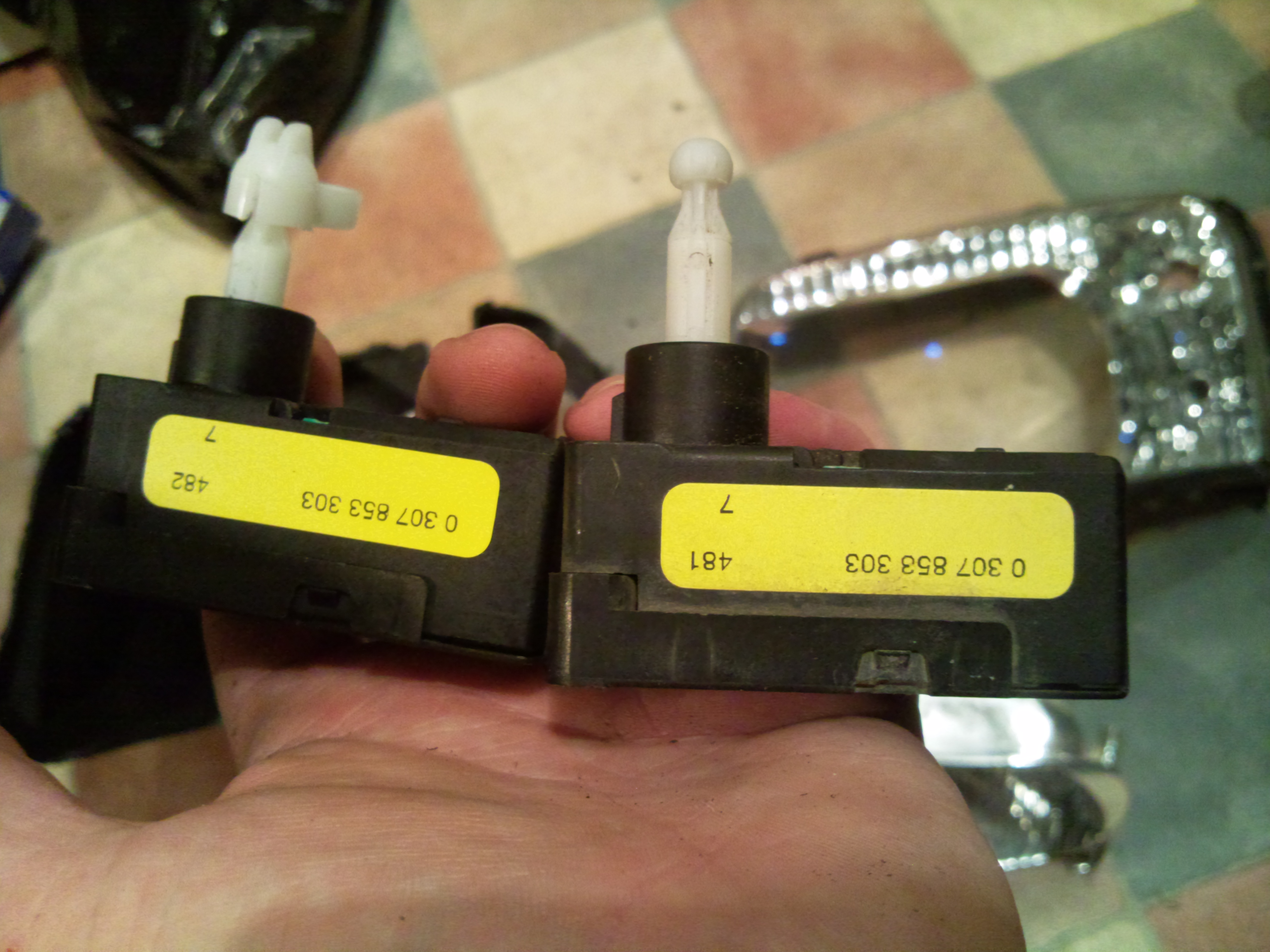

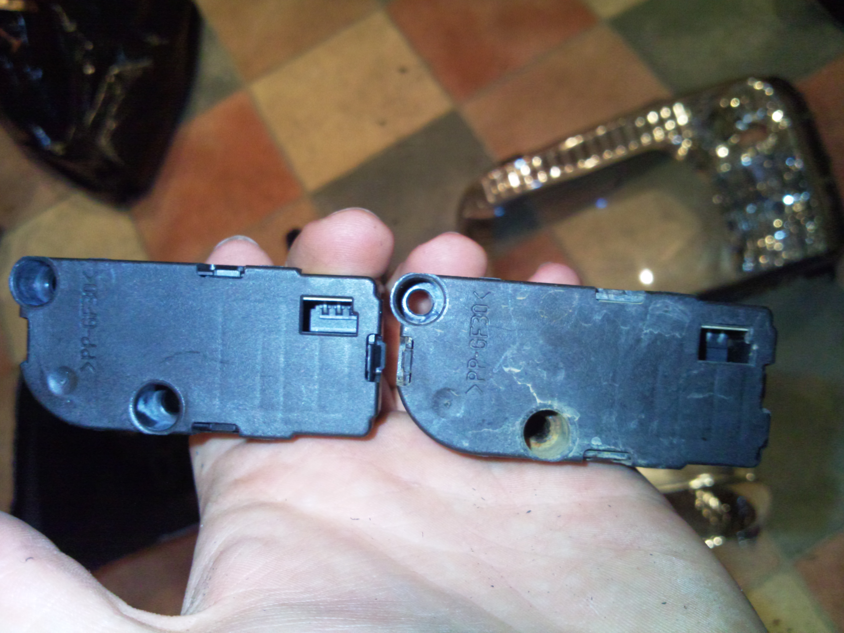

I've got a Panda Mylife 2010 and want to change over the headlamp units from UK to EU spec.
About 6 weeks ago I bought a pair from Germany- made sure they were for the '03 onwards with built in electric servo for lamp leveling.
I tried to fit them today and got them bolted on, but upon trying to plug the electric connector onto them I discovered the connectors are different!
The part numbers I got were 0318028316 & 0318028315.
If anyone could help letting me know which part numbers I should have so that the connectors will match would be very grateful.
Thanks,
RR

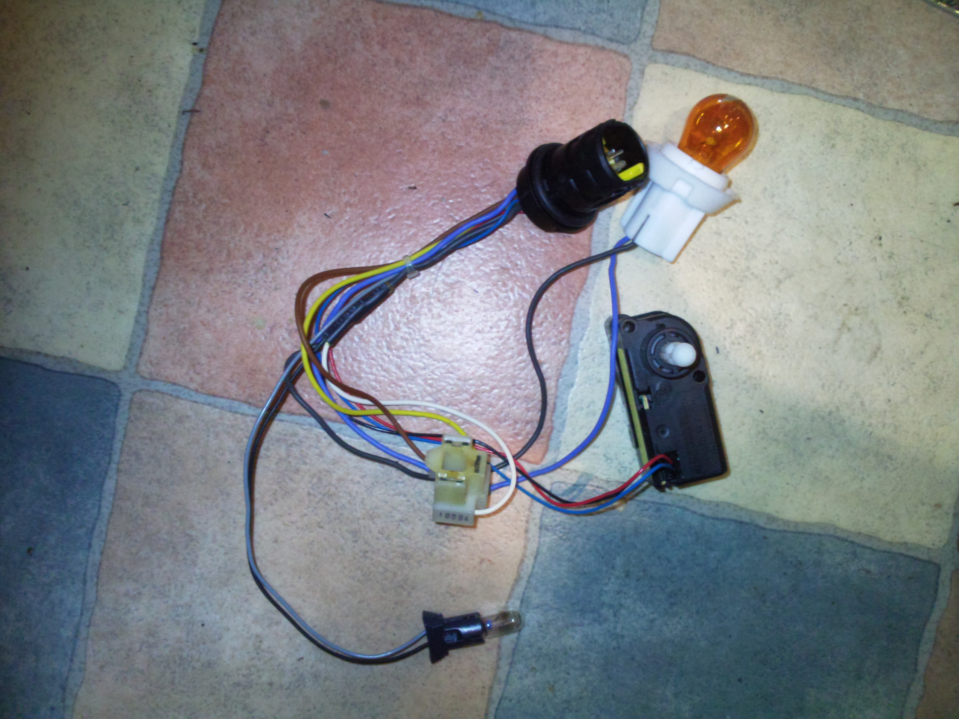

Thanks for the idea :)

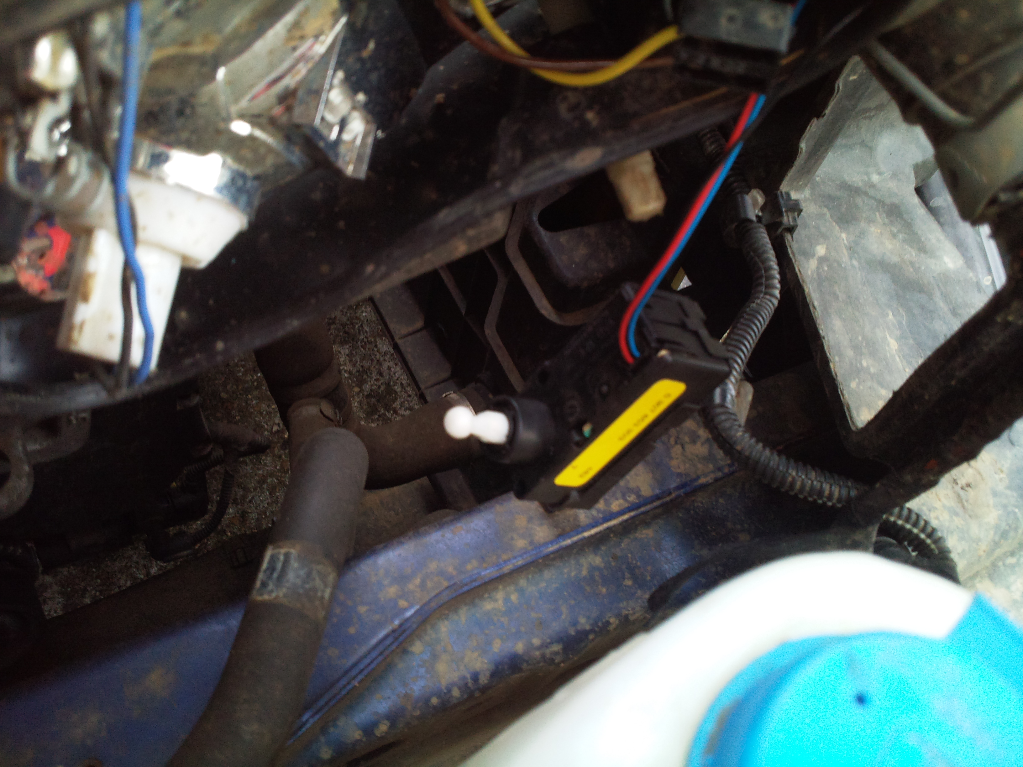

One problem though- the original headlamps- one of them has a wire that has got trapped between the motor housing and mounting post probably during manufacture/assembly. Also I cannot see how you can disconnect the wiring that goes to the motor. Guess a dentists mirror on a stick would be handy.
Thanks for the offer of a piccy of the blindside. That would be a real help :)
If youve the original units still you can simply swap the wiring looms (y)
