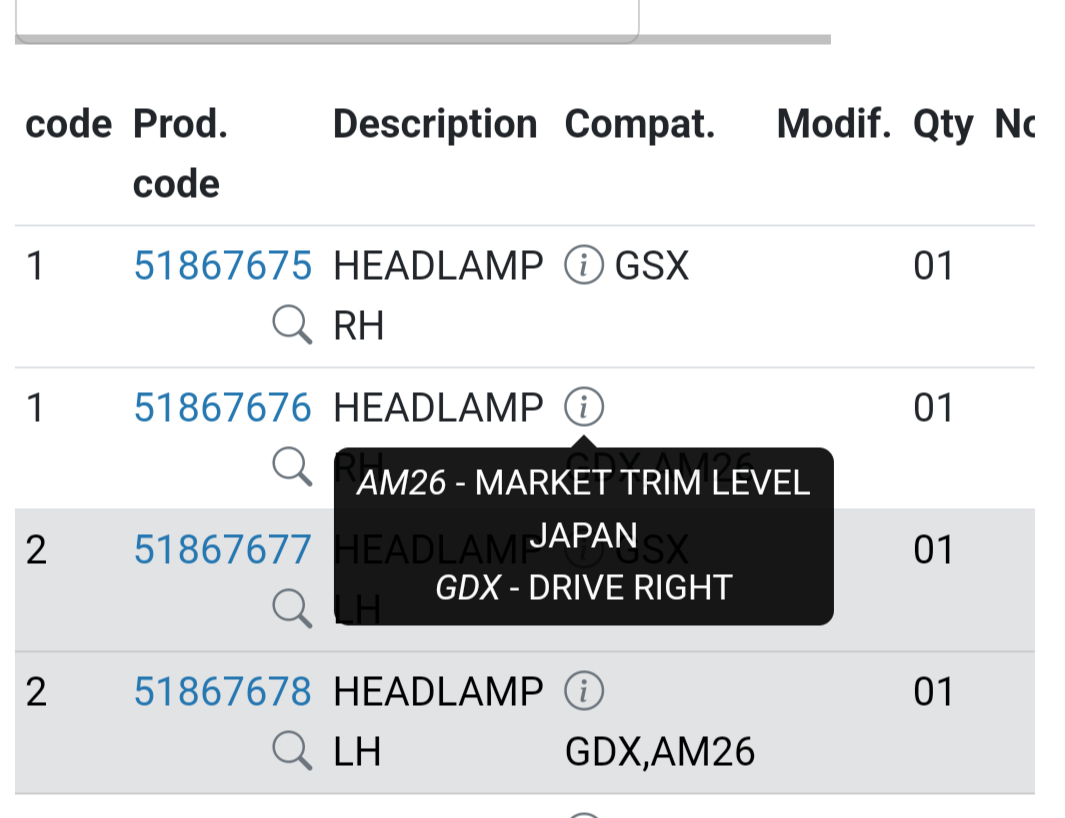

Online sellers often put the part number for right hand drive but that's not what you get

I am only seeing one part number for all the trim levels at this date, except for some of the 4x4's
