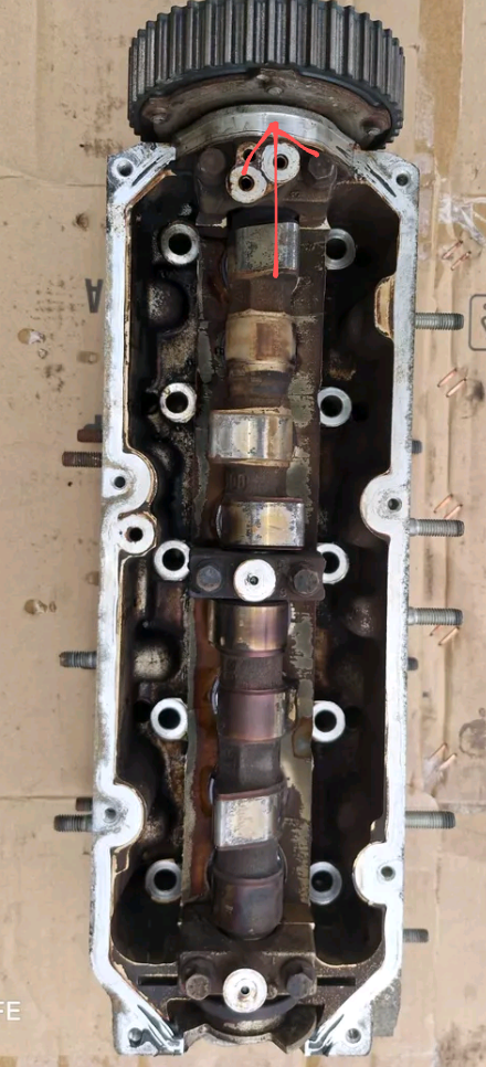

If you slide this little tool along edge 3
Does the pip 1 slide into a valley 2
If yes, you don't need this tool again, you don't need to undo the T55 pulley bolt
If it hits the top of a tooth then you will need to undo the T55 bolt

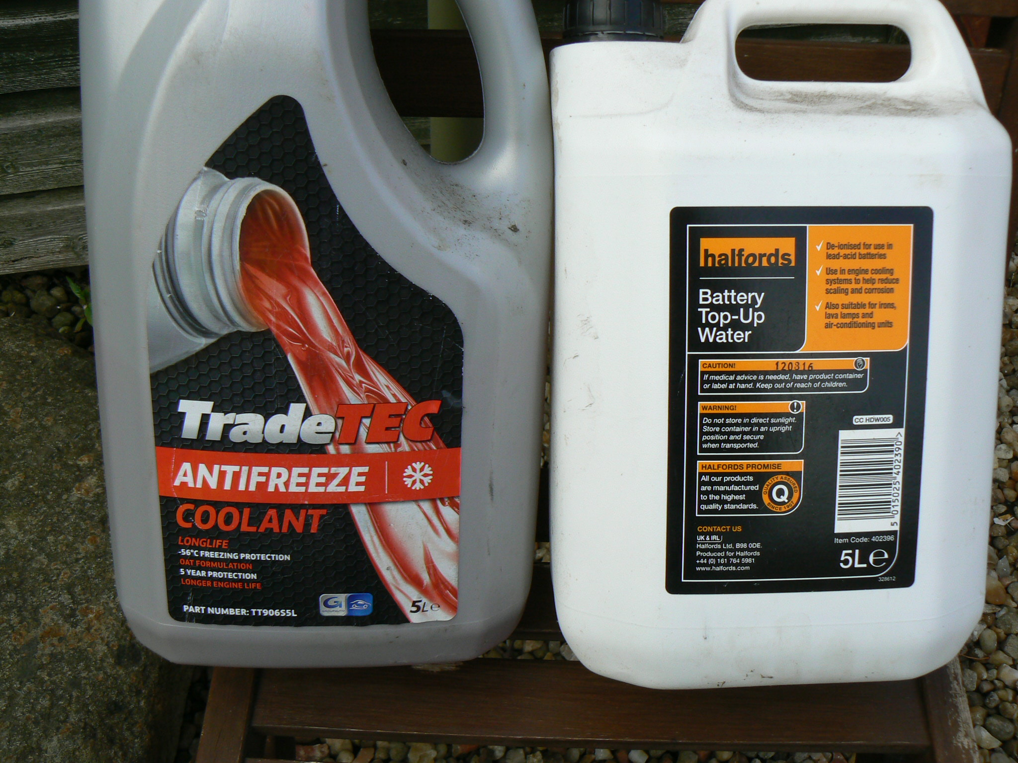

Just remembered I've got some of the stuff left over from last time I changed the Panda and Punto coolant:
Concentrated coolant on the left and deionized water on the right.

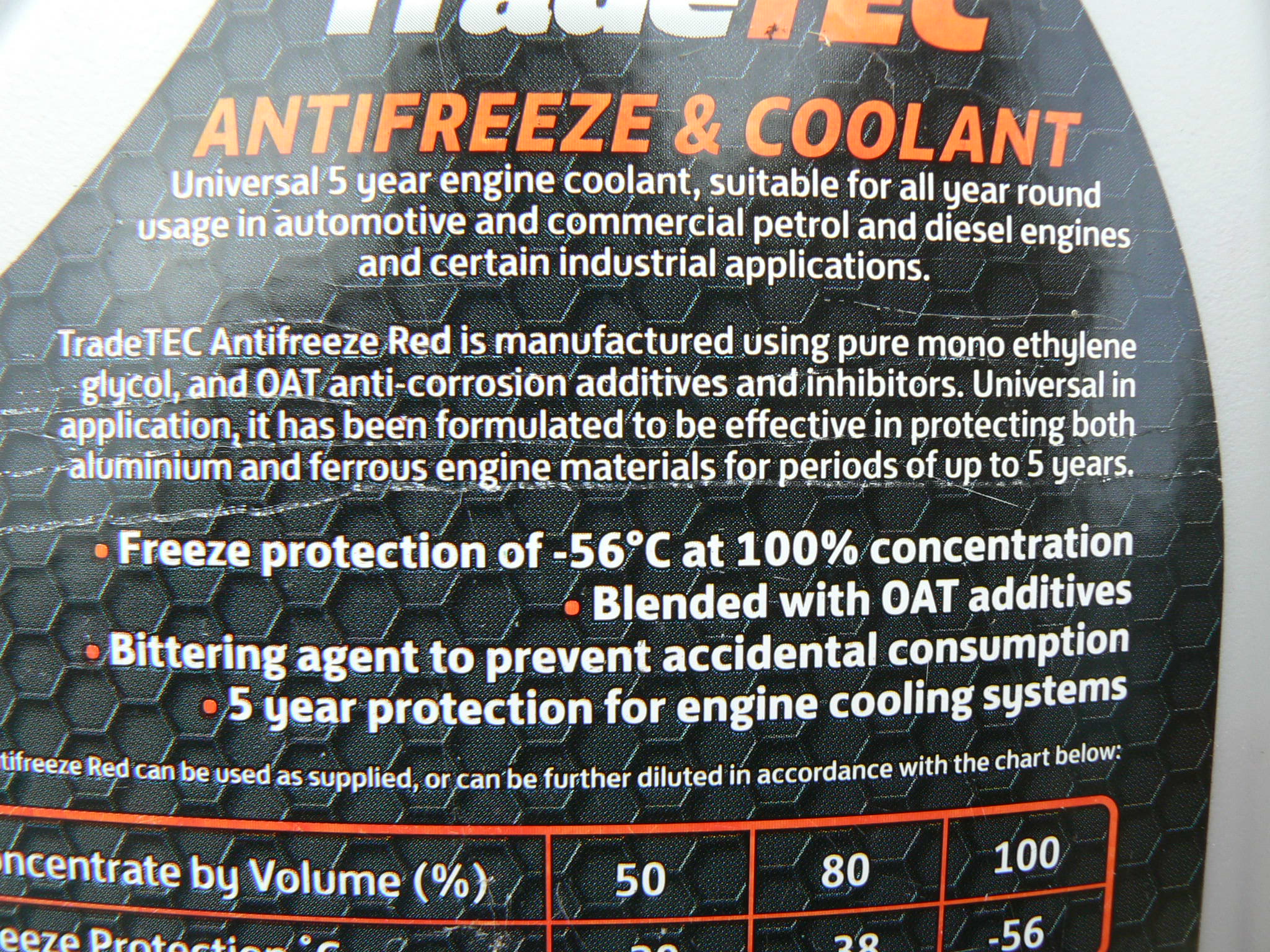

For those of a more technical turn of mind here's the back of the antifreeze container:

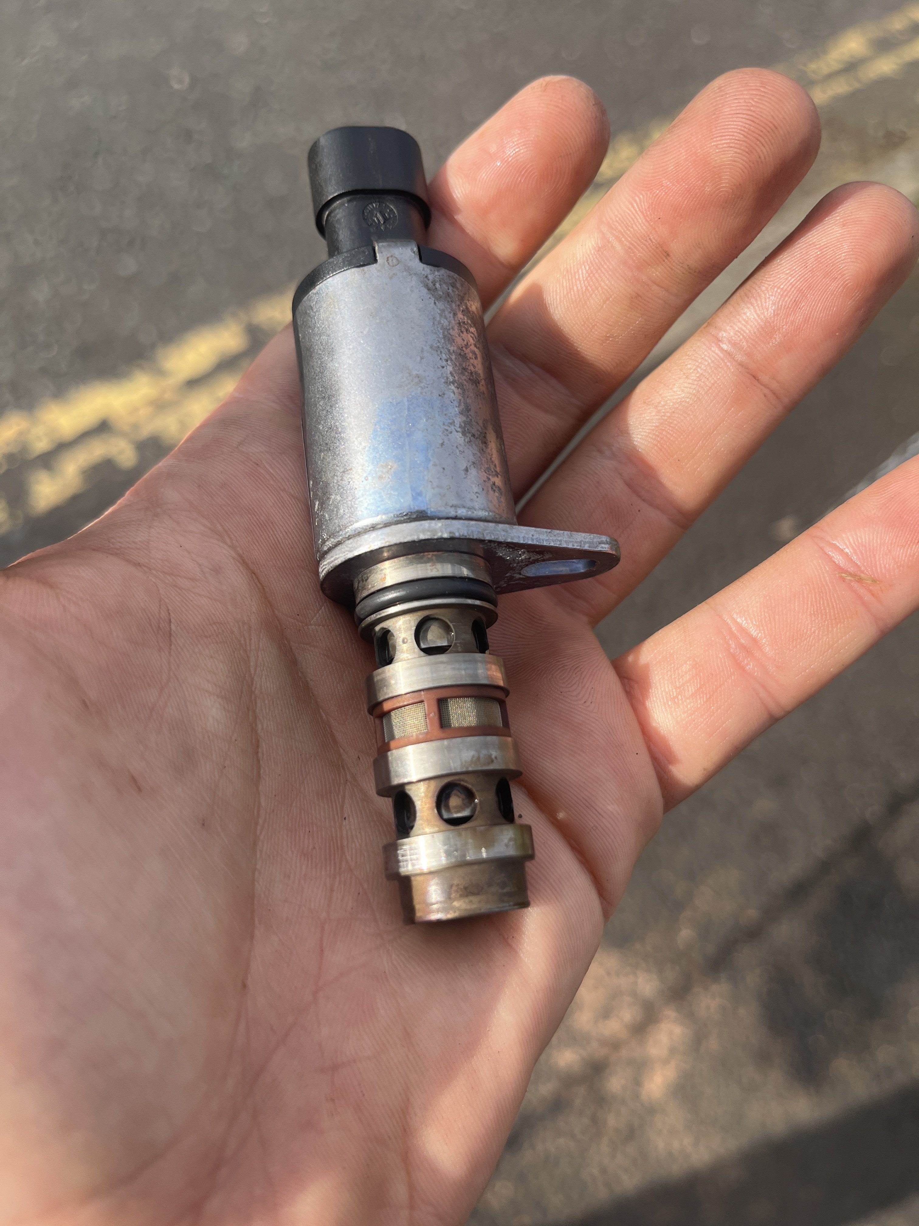

I’m also beginning to suspect the VVT needs replaced, but I’m seeing that it’ll be between £60-100 (I’m already over my budget for repairing the car)
Could I try soaking the VVT in brake cleaner or WD40?
Or is there any way I can clean/repair it like a fuel injector?
(I scrubbed it with a tooth brush and that held off the P0016 code for a few minutes)
Has the vvt solenoid valve mesh strainer been cleaned? Sticky solenoid and or clogged mesh can cause P code you are seeing
