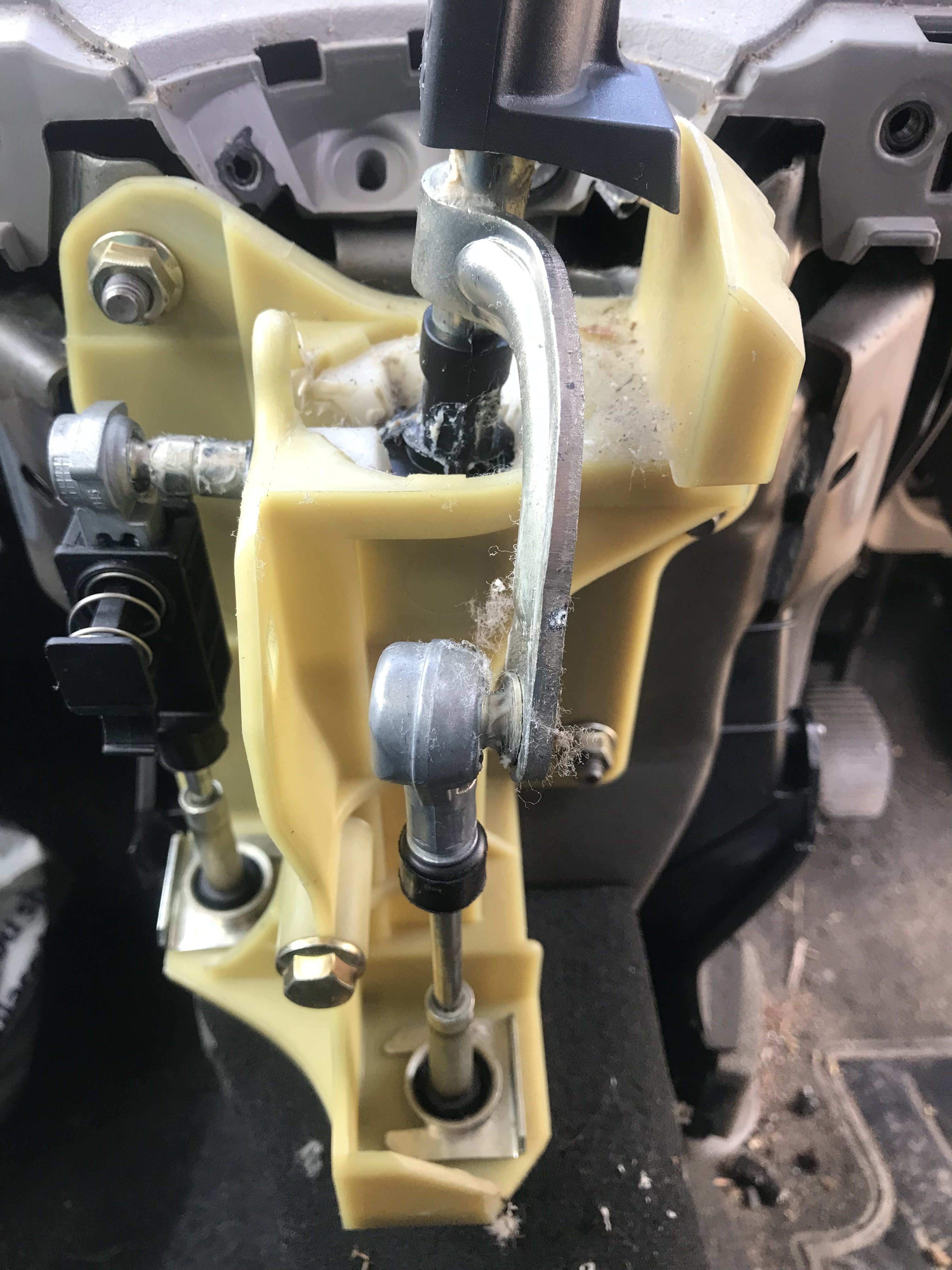

Hi.
I am struggling to select reverse.
Has been getting slowly worse over the past two years.
Not helped by ill health.
Anyway i got the covers off (pic).
For a good look at it.
I can feel some resistance in the LH cable at the collar.
I have used my day's energy ration.
Plan some spray oil next visit.
Any advice greatly appreciated.
Dave
If it’s the same engine off
And especially if the leaver feel a little stiffer to move
It’s likely to need a new cable
I had one where it struggled to select first
I put some light oil down the cable from the gearbox end and that cured it for awhile but did change the cables in the end

Thanks to everyone for the help.
Cables were the job.
Back to super slick again.
