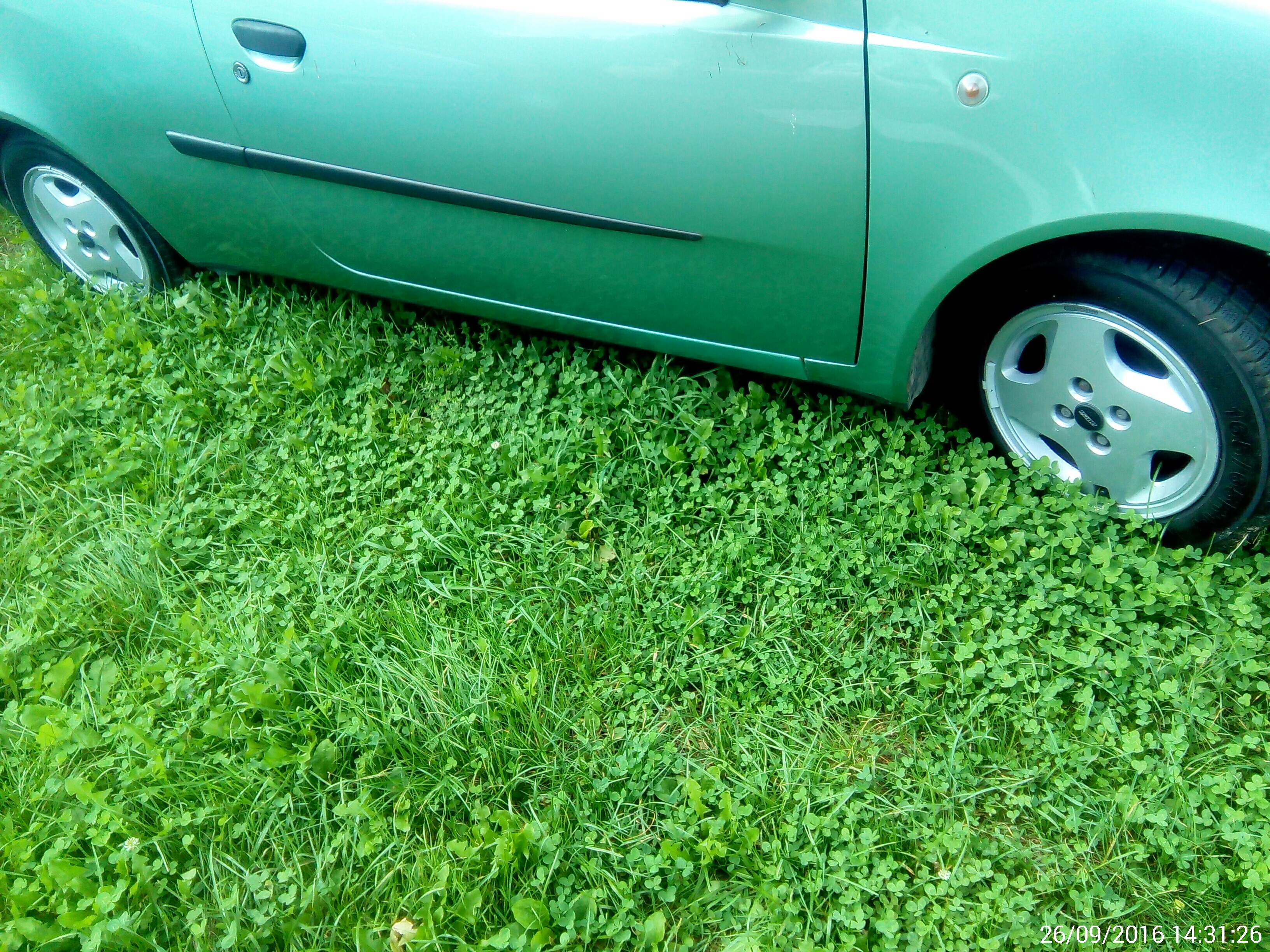

Cinquecento wheels on a Seicento?

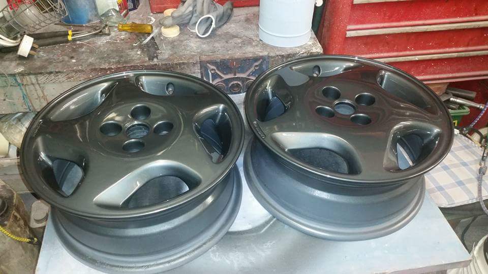

So all fitted and I can't say if having 50mm from the turbo to the intercooler has made a noticeable difference but I hav also fitted some BSA light weight wheels and they certainly have. Steering is lighter, acceleration improved (even though the wheels want to spin on boost) and braking is something you do instead of think about a few minutes before hand. 195-45-15's instead of 205-55-15's have thrown the speedometer out again. 30 is now 33, 40 is 45 and so on. Even though the car is only 10mm lower she feels less like a Land Rover than before. Almost like a car.
