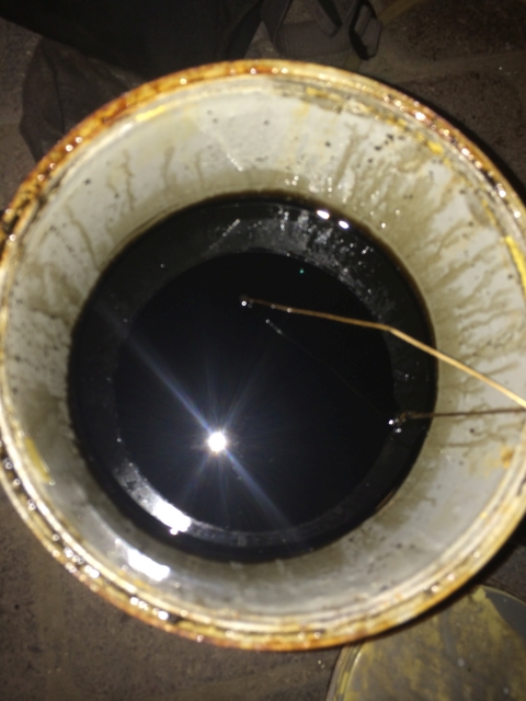

Oil changed and it is less than 5000km old. Black stuff!

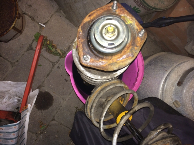

Shocks and old strut mounts - rust really gets to spread from that exact position. Strut mounts are now new and I've cleaned the area they fit onto before adding Tectyl (underseal stuff).

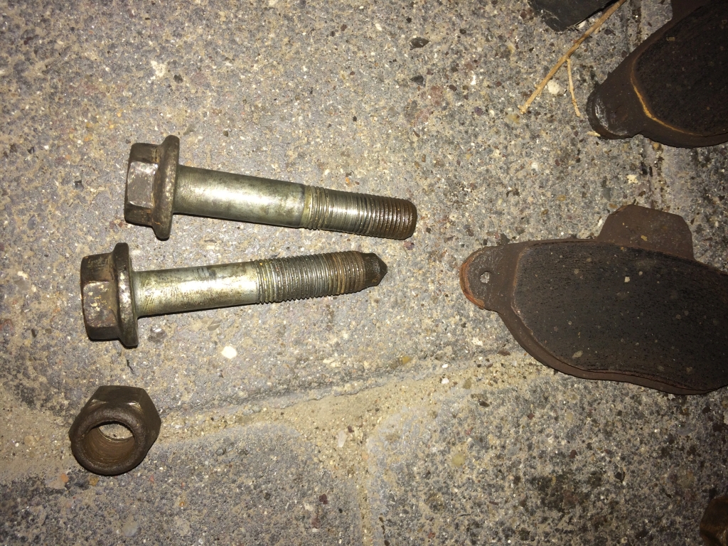

Have ordered four new bolts in order to get the shocks back on. Two of the four bolts (two either side, duh) were truly knackered - trust me, they were TIGHT! :mad: Pulled the threads off both nuts!

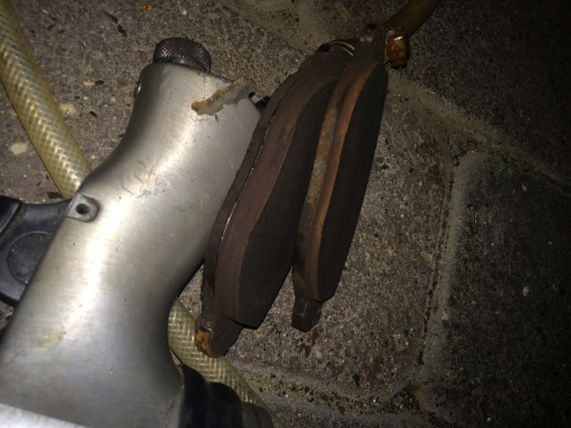

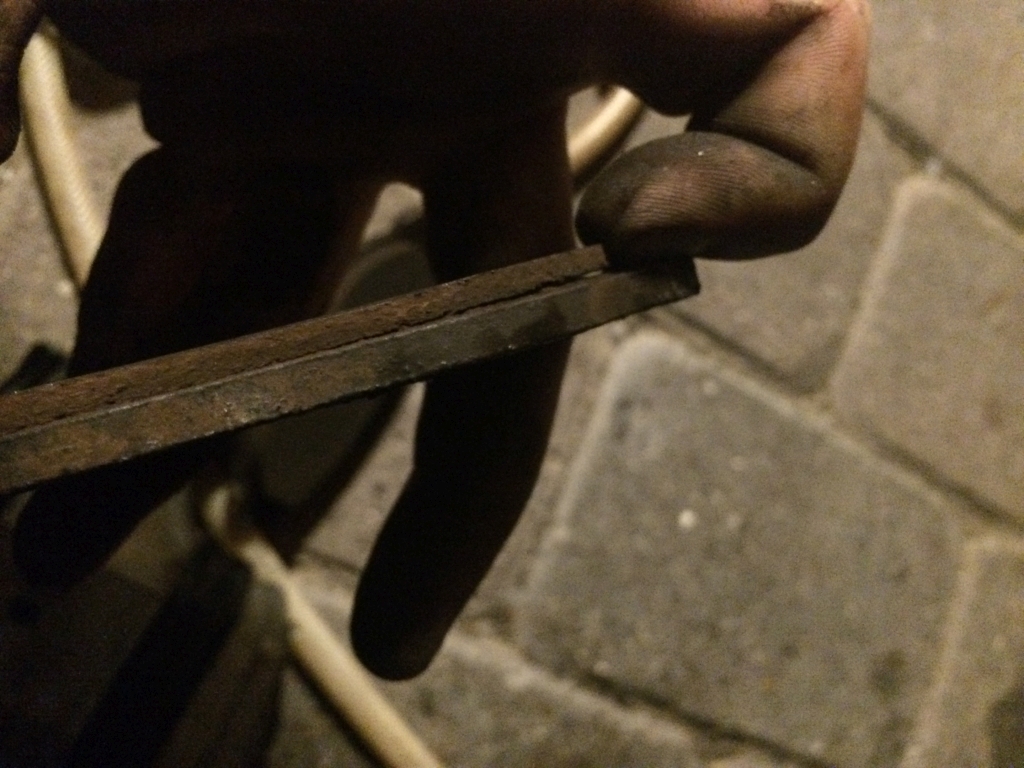

Uneven brake pad wear. Basically, the pads on the piston side of the calipers were stuck due to dirt, rust and old grease. One of the pads was even starting to let go so this was about time. Brakes need to be clean, damn it!

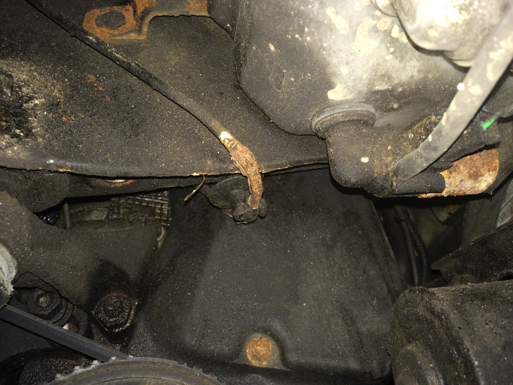

Also a bit for the garage! A truly rotten brake pipe... :bang: On the other hand that made me decide to get SS brake so a set of Goodrich are on their way. If a garage needs to run new pipes, tear everything apart and bleed the brakes, they may as well spare me the trouble of doing it again. ;)

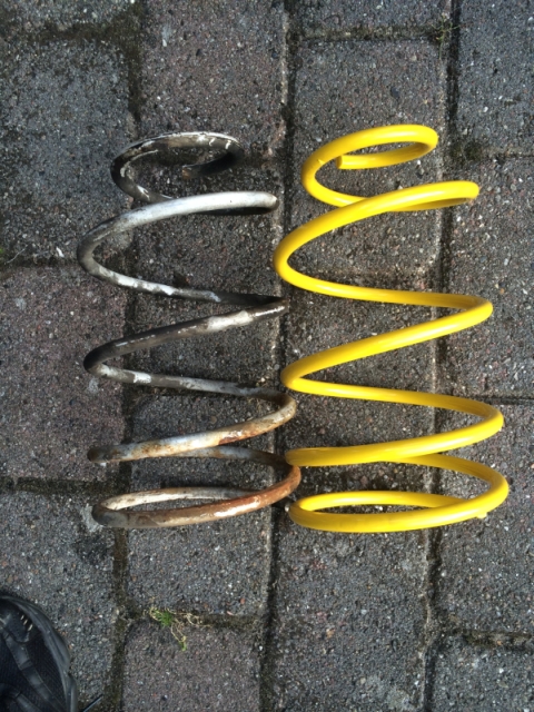

Old spring vs. new spring. Same length, different strength. The taller, yellow springs are a bit stronger and feel much more progressive.

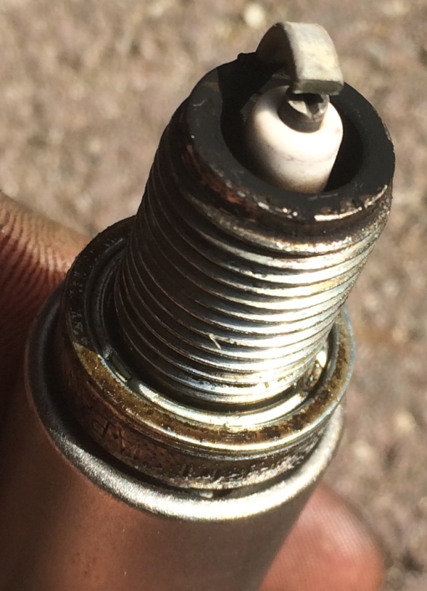

Plugs are mighty clean which leads me to think the engine is in fact running lean. From the middle of the porcelain and into the plug itself, they're all black, though. These are NGK BKR7E-11, regapped to 0,8mm

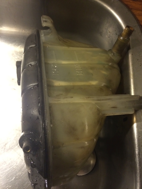

Coolant tank is soaking on the third day now in an attempt to get the last gunk dissolved. It's a mix of old coolant, calcium, dirt, oil... you name it! At least I've found no sand in there.

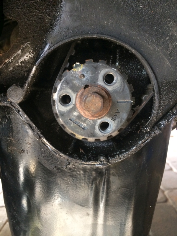

Did the cambelt which is seriously a doddle. I really feel silly to have actually paid someone to do it on my first Sei! Cranked the engine once I was done and it fired up perfectly. I'm rather proud of myself, no matter how easy it was.
Fitting the new and intact cambelt cover was in fact more time consuming than fitting the belt and checking the timing, lol! It merely needs a bit of gentle violence.
Water pump wasn't leaking and it was changed less than 10.000km ago so I left it alone. It runs perfectly and has no play, so it should be good till it starts leaking.

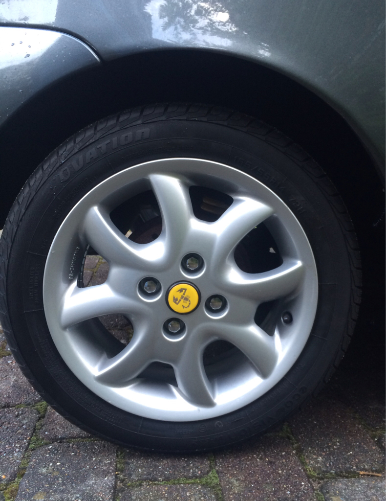

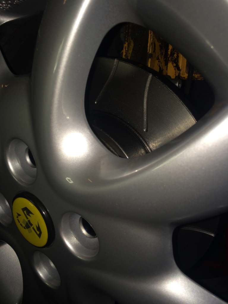

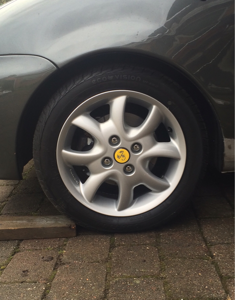

Brembo Max fitted along with yellow caps.
IT'S BACK ON WHEELS!
Still need to sort the temperature gauge and refill the cooling system, though. And of course change the rear springs, but that's really nothing to speak of!
YAY!

Weird thing is... the car doesn't appear to sit much lower, yet the jack clears the front bumper, so something has definetely changed.
I was worried the springs would make the car sit too tall, but that's not the case!
Happy, so far!
Seriously, I think this looks perfect!

The front brakes were sticking slightly and after a good clean with new discs, pads and some copper slip, it's like having another 10HP compared to before!
The Brembo Max and literally the cheapest pads I could find are proving to have very good bite even with just a light touch of the pedal.
