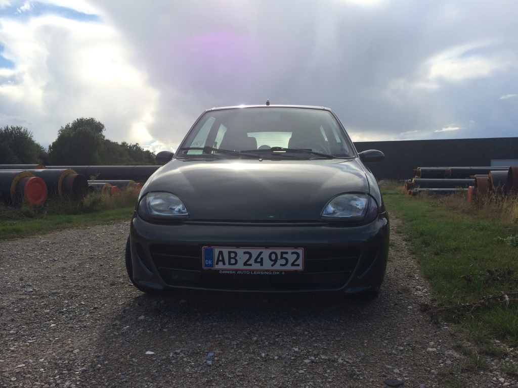

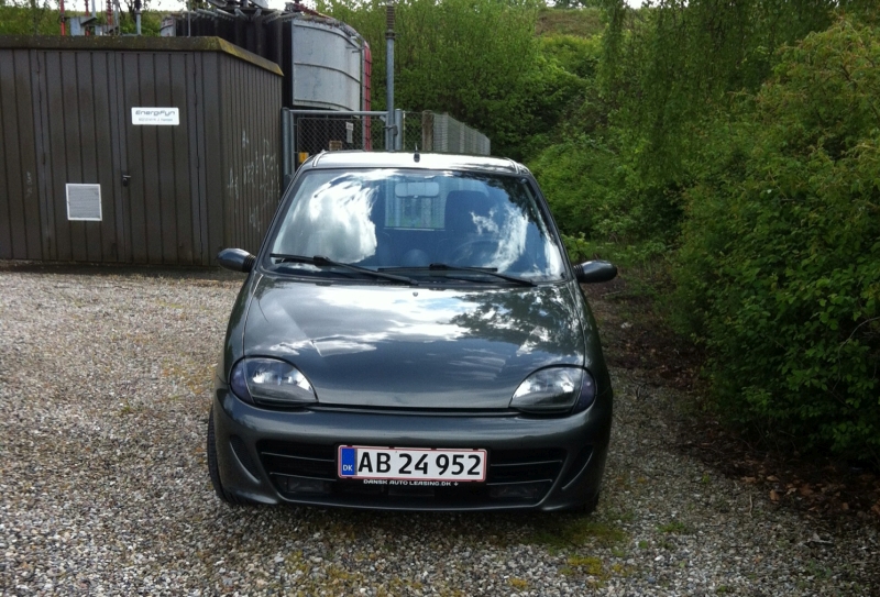

Seicento "Grey Matter" - finally back in a Sei!

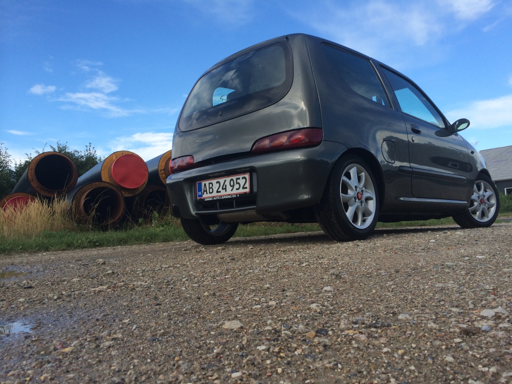

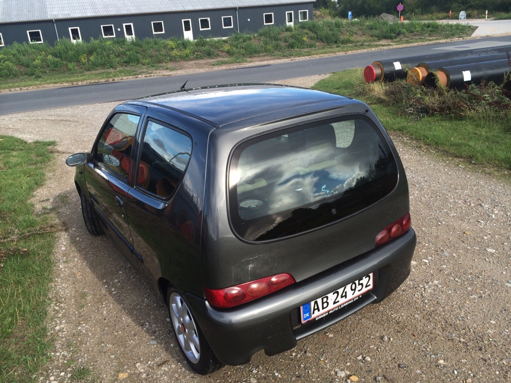

Hi! My name's Jesper and I live in Odense, Denmark. 33 years old and I've been hanging around in here since 2006, mainly lurking in the shadows.
Back in 2005 I bought a money pit of a Sei and now I've gone and bought myself one, again. Same colour, different everything apart from the money pit detail.
I couldn't resist when I got this offer from a acquaintance of mine whom I got to know when I had my first Seicento. He's a good man - I think he just lost his patience and reprioritised to focus on his family and business rather than pouring funds into something which will only depreciate further.
More photos will come at a later point, so this is merely an introduction. CBA to was and polish it, yet - too much mechanical stuff needs to be done.
The engine and gearbox have done 99.600km at this point and nothing apart from brakes, cooler and a few cables has been done, mechanically since 1999 and it has only been driven occasionally three Winters.
Underseal was done years ago and will be done again before I store it for the coming Winter.
The following changes has been made by the previous owner:
Rear arches rolled (proper job)
Yellow Koni shocks
60/40 lowering kit (KAW and Ventura)
6.5x15 ET32 Barchetta steelies @ 15mm spacers with Nankang 165/45 :yuck:
Debadged front and rear + poor job of covering the boot lock :rolleyes:
J&R pod filter (n)
280 degree C&B cam :devil:
Head ported and skimmed
Different inlet manifold
Custom 2" exhaust (loud li'l' bugger)
Gas bonnet struts
Supersprint exhaust manifold
Bosch chip

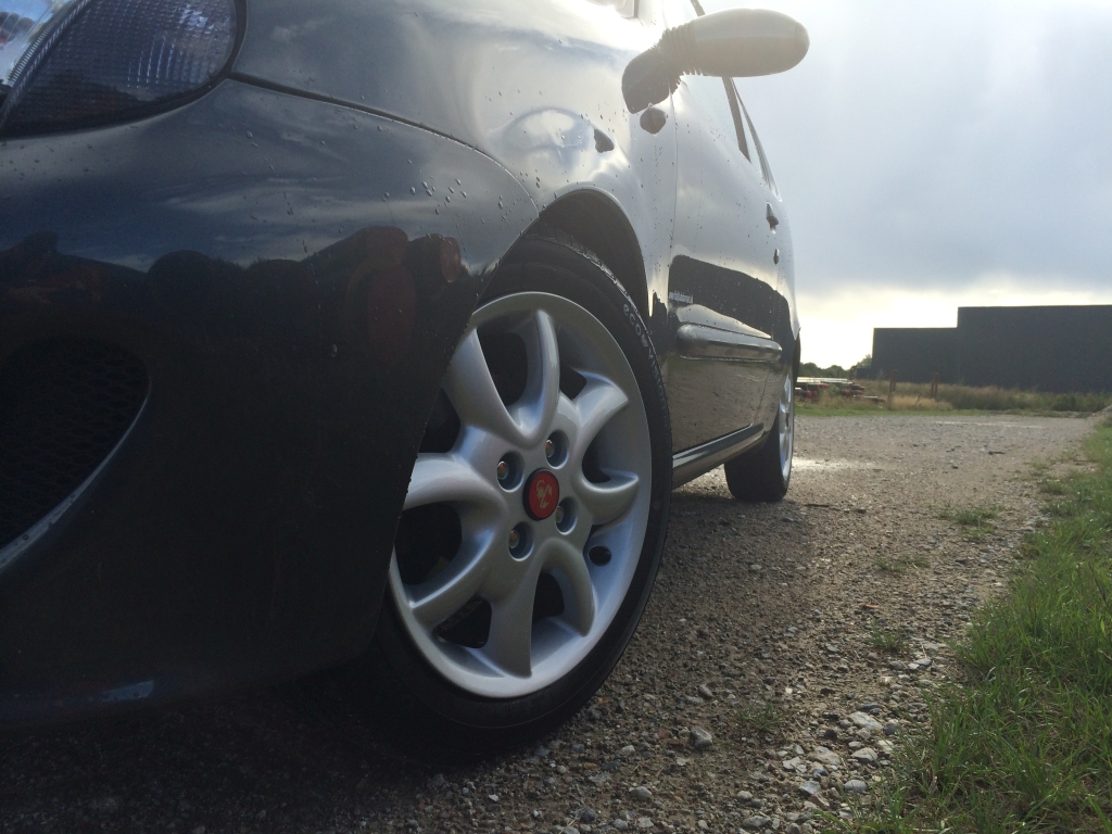

The Ovation tires were the cheapest compromise I could find to get the Abarth rims fitted. I could only get four year old 175/50 Pirelli's at something like €150 a corner which they aren't worth to me and 195/45 on 5.5" wide rims is just wrong.

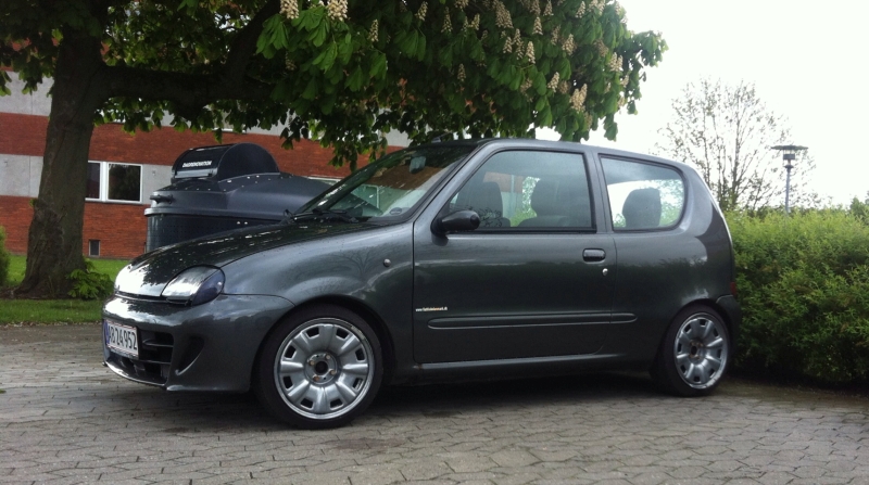

The 165/45R15 Nankangs where stretched over 6.5" and combined with ET22 all around, the car would suddenly oversteer, e.g. the rear lost grip with no warning whatsoever. I think it was due to a combination of compound, stretch, offset and unevenly matched springrates (front: HARD, rear: medium).
The car went sideways while I was driving semi-hard but didn't spin out because I'm that good... er, lucky! :eek:
The new profile and offset provides better feedback and the car now understeers more. In fact it does't seem prone to lose rear-end grip at all and I have access to a big, private parking lot where I can go find out under safer circumstances than on public roads.
The Abarth rims are temporary till I find 'the right set' of 6x14" rims to which I'll fit 195/45 tires of a much better quality. Till then I'm aware I shouldn't push it... so I won't!
Once I find the right rims I'll sell the Abarth ones. They're only getting rarer as time passes which is to my advantage as far as selling them is concerned.
I'll buy a set of new springs as well to make sure front/rear match better. Just can't decide whether I should go for the Weitec ST/KW 40/30, KAW 60/40 or be old and settle for H&R 35/30 as the latter to my knowledge is really good quality, i.e. proper progressive springs that are evenly matched and should match my Koni dampers quite well.

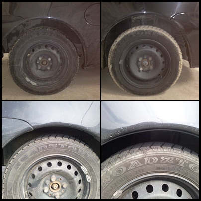

Eibach 30/30 springs are out of the question. Just found a photo of a Sei with these springs combined with 155/70R13 tire fitment which have a slightly larger diameter than anything I consider an option.
The photo is pretty self explanatory - stock to the right.

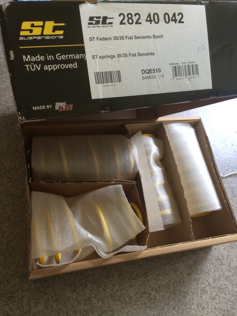

I've just ordered the ST/Weitec/KW 40/30 springs, mate. :)
I'd go for Koni shocks or the complete ST kit in your case. If you can wait till I've fitted the new springs and tested the thoroughly, I may be able to help you decide.
New springs on stock shocks are a pain and not worth it.
As mentioned earlier, my Sei has two different sets of springs, front/back. The KAW -60mm in front are HARD and quite low. The rear ones seem softer and are either Weitec or Cobra/Ventura. Previous owner can't remember nor find the papers and he's mentioned them all, lol!

Springs arrived today which means I can get going, hopefully tomorrow. Looks like my review will have a twist in a more moderate direction, though. The springs I've received are -35mm ones as opposed to -40mm/30mm as advertised.

So, tight Koni Sport shocks on Weitec ST -35mm springs it is, then. Add to that some of the hardest ARB bushes available! :D
On the bright side of things:
Can in fact end up with a good compromise between sporty/comfy with acceptable body roll AND be nowhere near having problems with the future 7x15" wheels and 195/45 profile tires.
Kind of tempted to fit a stock exhaust, for now.

Gave the car a wash and drove out for a little photo session. It started raining on the way to my location... so much for washing the car! :p At least I got rid of the leftovers from the duct tape and now the side strips are in place.
Gave the tires a bit of shine, as well. Good thing I gave the rims a slight polish and wax when I fitted them - brake dust wiped right off. (y)
