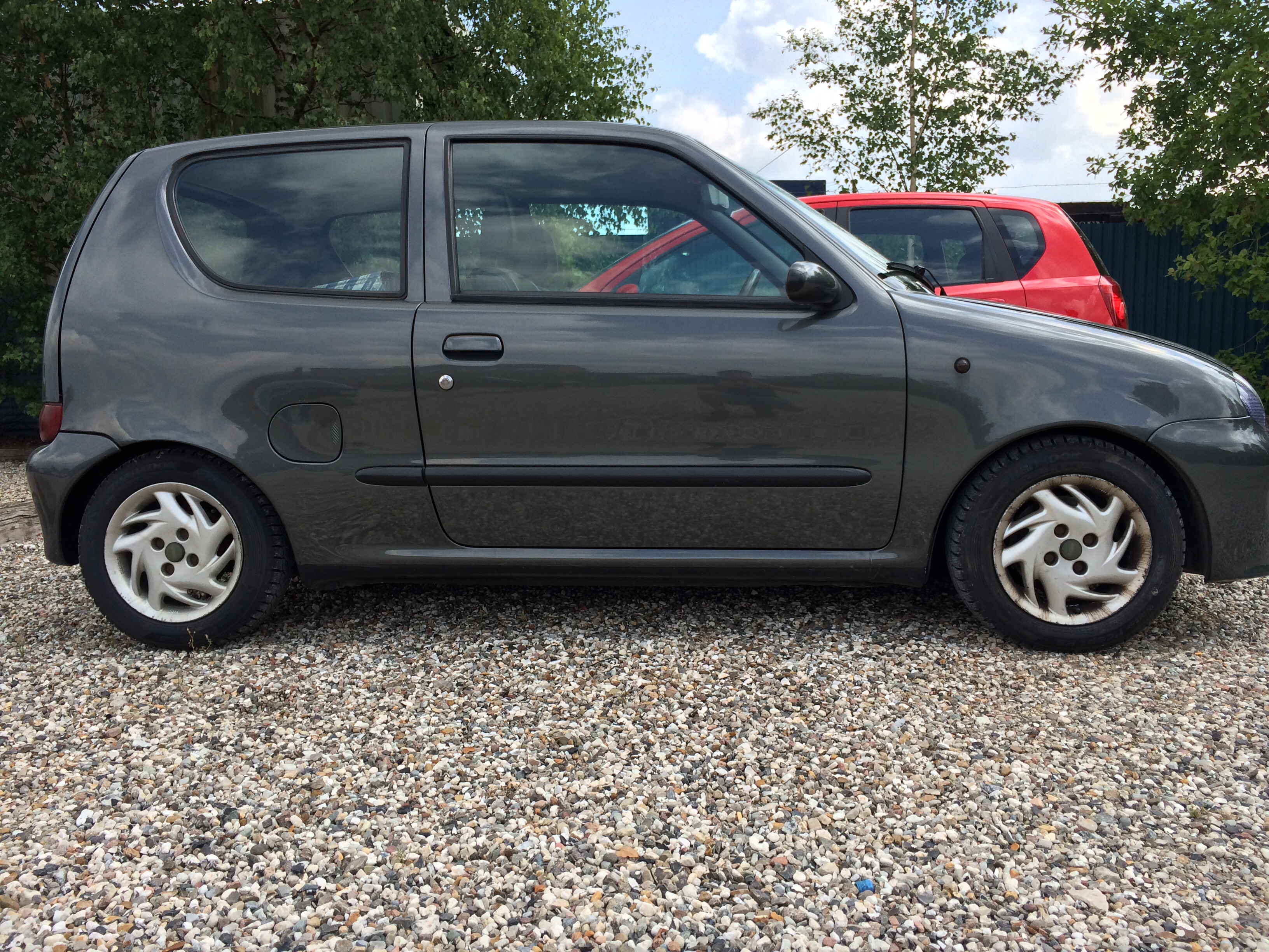

Hi! My name's Jesper and I live in Odense, Denmark. 33 years old and I've been hanging around in here since 2006, mainly lurking in the shadows.
Back in 2005 I bought a money pit of a Sei and now I've gone and bought myself one, again. Same colour, different everything apart from the money pit detail.
I couldn't resist when I got this offer from a acquaintance of mine whom I got to know when I had my first Seicento. He's a good man - I think he just lost his patience and reprioritised to focus on his family and business rather than pouring funds into something which will only depreciate further.
More photos will come at a later point, so this is merely an introduction. CBA to was and polish it, yet - too much mechanical stuff needs to be done.
The engine and gearbox have done 99.600km at this point and nothing apart from brakes, cooler and a few cables has been done, mechanically since 1999 and it has only been driven occasionally three Winters.
Underseal was done years ago and will be done again before I store it for the coming Winter.

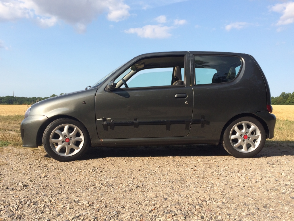

And here the tiny one is on the Abarth rims - looks really good methinks! But me also thinks nothing's anywhere near the charm of the Abarth rims! ;) Forgot to fit the yellow, Abarth centre caps. :eek:
Gives an impression of how low these springs are and to say the ride is hard is like calling the Pacific Ocean 'damp' :p
I'm looking at switching to a ST 40/30 setup, instead. I was seriously considering H&R 35/35 for a while, but it seems these are only made for the non-Sporting models. :confused: A ~15mm drop from stock Sporting seems silly. On the other hand, I'm building a sleeper... ARGH! Decisions!
Fresh wheel bolts all around, 40mm long. Had to shorten the rear ones about 2mm. Spacers... spacers... really want spacers but can't justify a set this year, but will likely end up widening the track 50mm in front (2x25mm spacers) and 30mm rear. Purely for looks, to be honest.
Major difference in turn-in and steering response going from the 155/65R13 to 165/55R14. Still very nippy and it's now necessary to put an effort into activating the ABS as opposed to the both taller and narrower Winter-compound.
