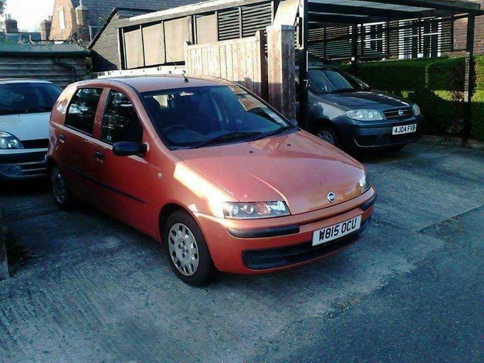

My second punto after an old 1.2 ELX finally died on me. Dunno why but I still love the them! Maybe because it was on of the last genuinely small hatchbacks.
