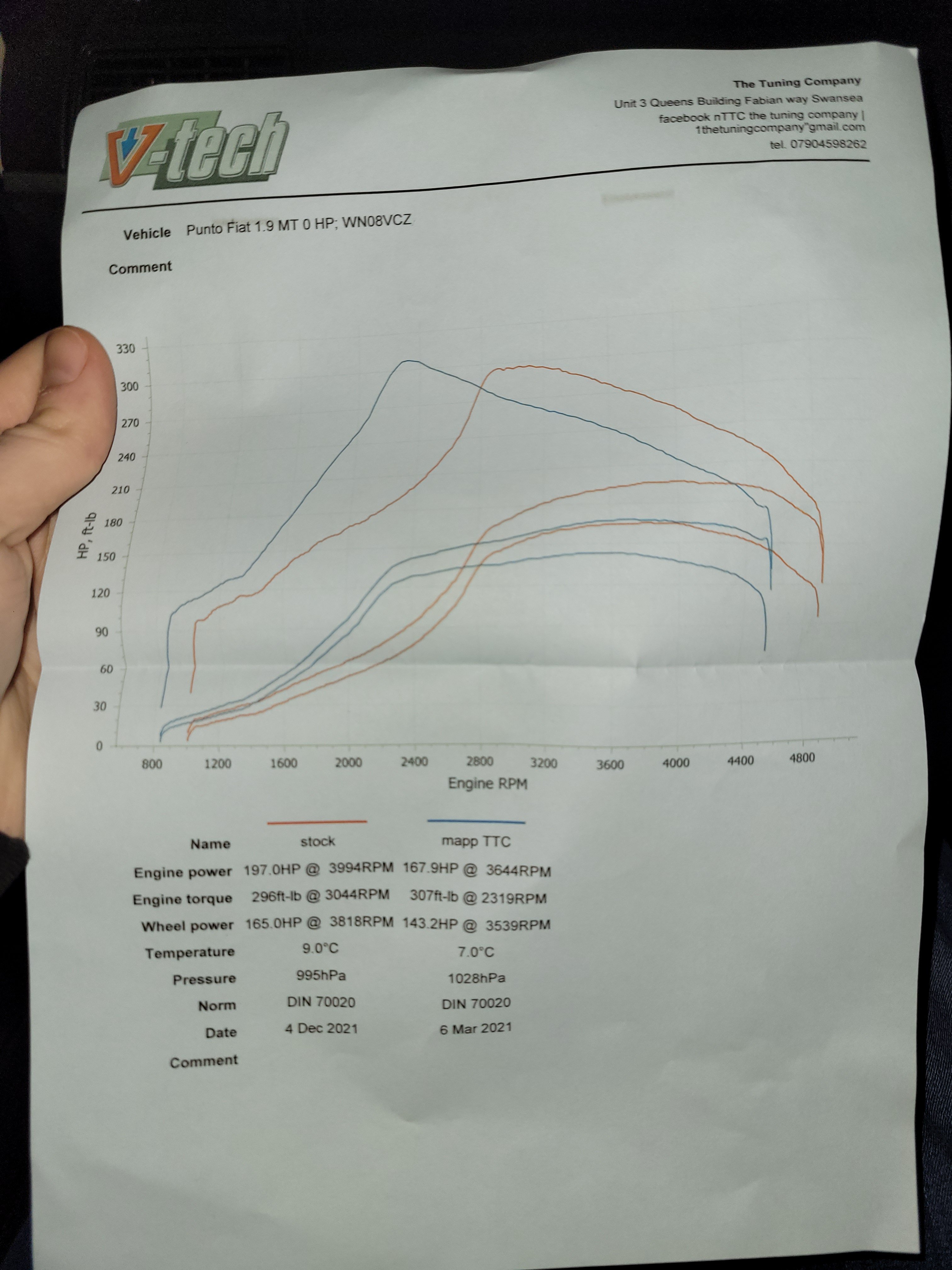

Got the car back! made 197BHP and 165WHP. Will upload print out too. Some good news and alright news. as for the good news, soon as i get a decat and an astra 1.9 intake, it will be mapped again and more power!! alright news is goodbye to air con but i can live with that! will update this thread again as it hasnt made the full potential of power with the hybrid yet. still more than happy with the power though!
