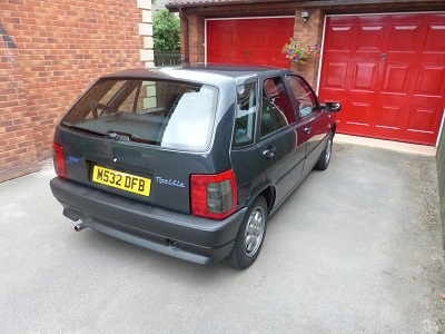

Finally managed to take some photos after getting back from holiday and starting a bit of work on my Tipo. So far have concentrated on getting wipers and washers working properly - front wiper arms repainted and fitted with new Bosch blades. New rear wiper fitted and washer tube blown through to clear blockage, replaced faulty non return valve. Also took off front windscreen valance, cleaned out what looked like years accumulation of pine needles, stretched rubber seal using hairdryer to close large gap at ends.
This week, have clayed bodywork and used Chipex kit to touch up paint chips and road rash, followed by full waxing. Think it looks good for a 21 year old car, despite the colour not being one I would have chosen. Would you believe V5 says it's green? Going in on Thursday for new clutch and full underbody stripping, waxoyling etc. then alloy wheel refurb before coming back to me to start systematic overhaul of everything else. Repairs to worn and torn driver's seat covering are also on the list when my local upholstery man can fit it in.
Loving every bit of it so far!

Thanks for the compliments. Hope the underside doesn't reveal any dark and rusty secrets! Colour code is 624 Greenstone Metallic. It looks like a dark grey with perhaps a smidgeon of green in the mix. Seems greener when wet or in shade. It is growing on me, honest. Thinking of getting some red bumper stripes to give a bit of colour to the black slab effect also having the alloys done in silver instead of grey which should look brighter. Fitted new head unit today so can play my cd's. Removed and thoroughly cleaned rear light fitment which cured intermittent no show of n/s indicator. Looked sound inside rear wing but will definitely have bumpers off as suggested.
Any good ideas for re-covering frontseat would be most welcome. Rear and passenger side should be fine with a good clean but cloth is well gone on driver's side.

A very heartening sight and well done. Whilst the bumpers can look nice with a half colour on, the all grey bumpers on your example are certainly pleasing to my eye, and generally greys suited a Tipo What method did you use to blow through the line to clear the jet?
Thank you for your kind comments. I used nothing but good old fashioned lung power! Took off rear wiper and straightened tube at each end then just blew hard. Pushed last bit of crud out with blast from newly cleaned washer bottle and pump motor with end jet still detached. Works fine now. Couldn't manage to get washer bottle out of car without removing wheel arch liner and/or front wing but syphoned it empty and flushed clean quite successfully. Meanwhile, underbody restoration progressing slowly but surely at Allitalia Wrexham. No holes or unseen rot but think we only just caught the subframe before surface rust became terminal. Fitting new trailing arms and brake discs while at it. Will post some pics asap.
I could never have imagined that worked. But clearly it does ! As per BlueJohn says, the back of the boot floor at the corners and rear valance is a rot spot, as is behind the rear wings. Look forward to seeing more pictures and updates. As you say it's more grey compared to green, as I think I saw it for sale, and IMO grey always looks good on a Tipo + slab sides even better.
