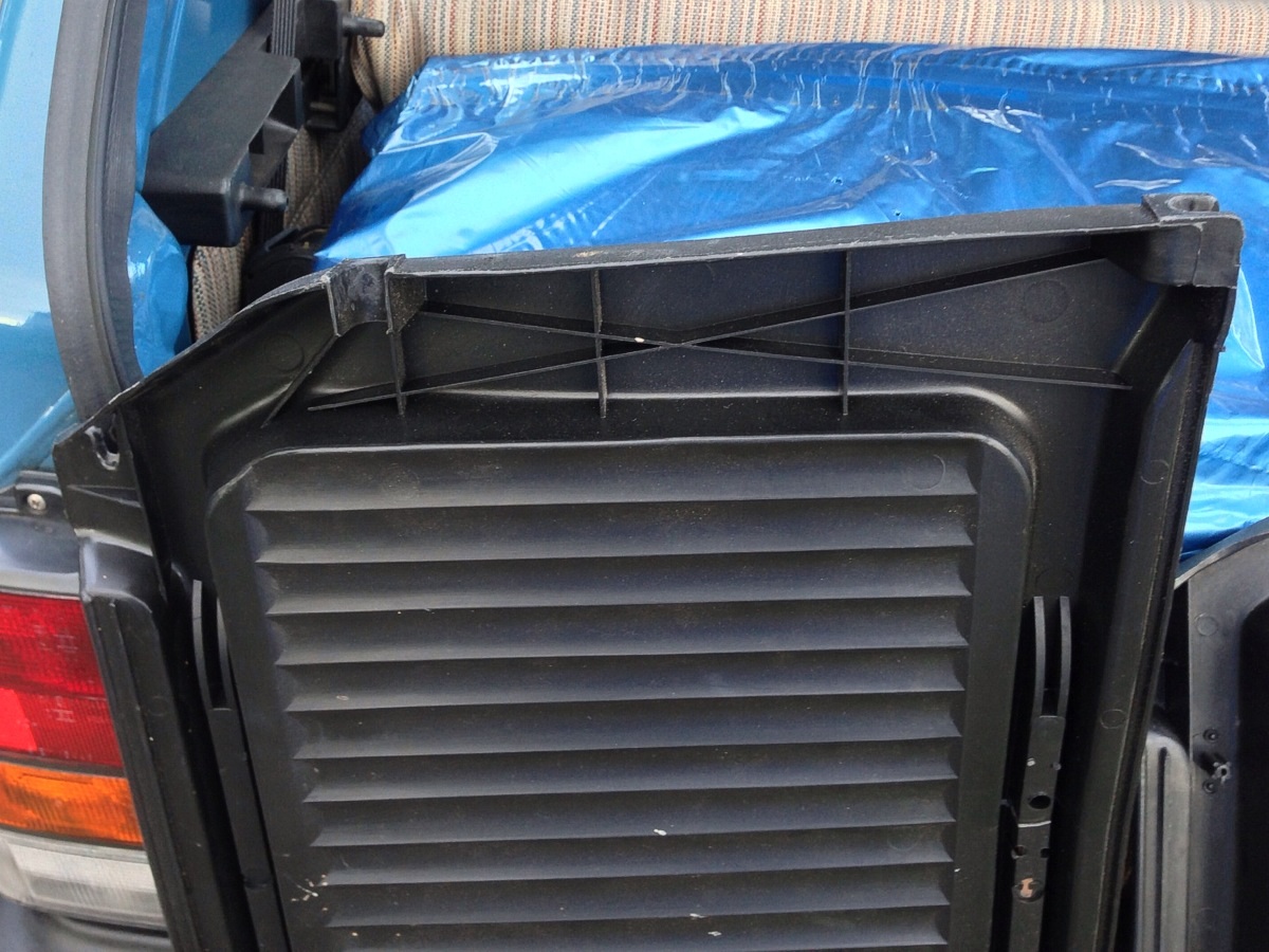

The shelf that Pippin came with was badly warped and cracked... -- here, in the middle...
...and here, where the metal reinforcing bar ended (at the bit immediately behind the back seat...):
...which is why I was looking for a replacement.
It's not difficult to tell which is in better condition, is it...? :p
However, if you look closely enough, you'll discern slight differences in shape and detail -- although the overall dimensions are exactly the same. (y)
One of the key differences is the lack of square-profile metal reinforcing bars along the front and back; as well as these strange 'hollows' -- all of which are absent from the replacement.... :confused:

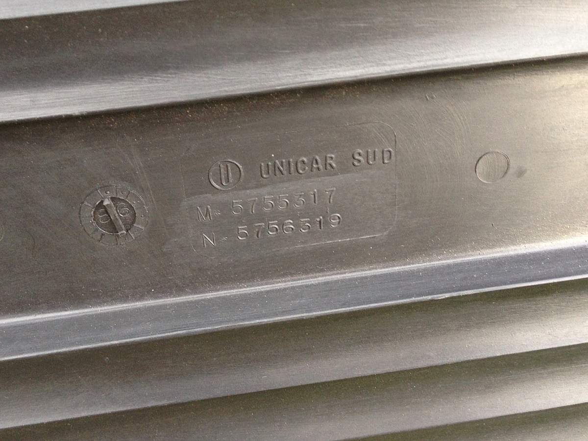

Interestingly -- to me, anyhoo... -- is the fact that the 'new' one not only has a date stamp on it of 1986 (whereas the original is from Pippin's year of birth, 1990); but also a maker's name:
The original is devoid of any hint that it was a FIAT item. :confused:
The original also features a lot more reinforcement -- not only with the bars, but with the way it's moulded. However, this has obviously not worked, as -- as stated above -- the shelf has cracked and warped very badly (as well as faded...). :(

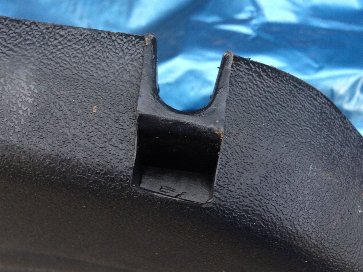

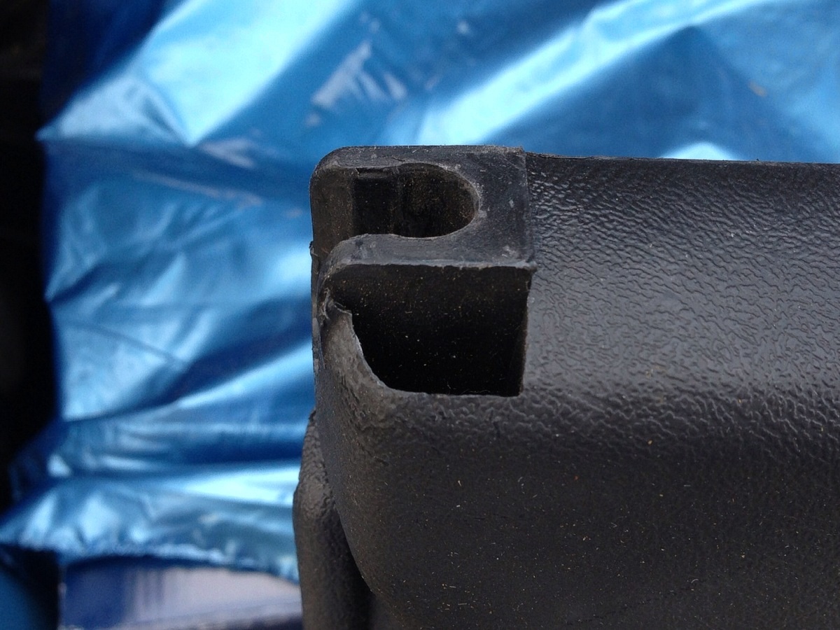

Here's the edge of the 'old' (original 1990) one...
...and here's the same detail on the 'new' (replacement 1986) one:
I do therefore wonder if the 1986 one is the same as a Mk1 shelf; but the 1990 one was revised for use in the 750L...? :confused:

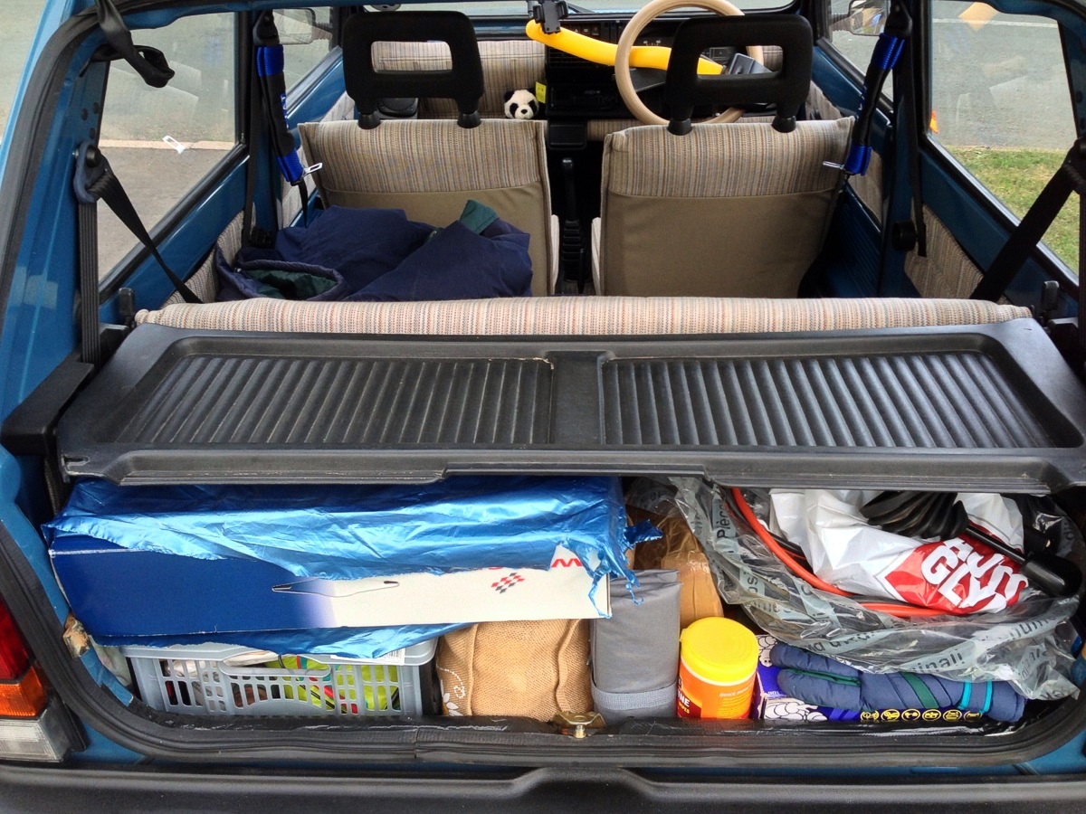

Anyway, as I said, it fits perfectly; and lies perfectly flat! (It only looks like it sags, here, because the back seat needs new foam....) (y)
Nice gearstick, there, isn't it...? :D
And, yes, I know that the boot is too full. But I had emergency kit for MITcar in there; as well as overflow from the Punto boot -- emptied so I could, if necessary, collect doors for VmanC; and a 750 interior for Most Easterly Pandas.... :eek:

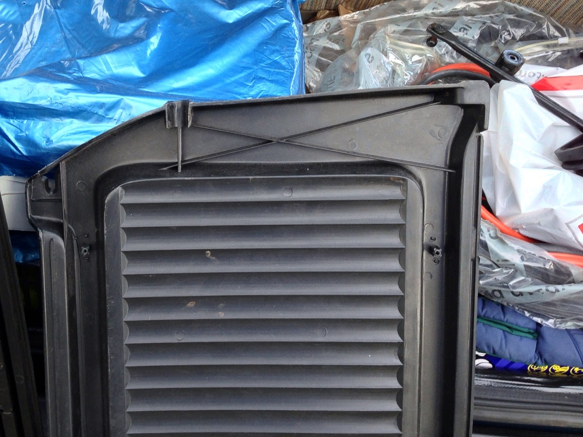

I still don't know, though, why the 750 shelf comes with slots for strings or rubber 'cords' to lift it, when the back door is opened... -- as I've never seen them in situ. (Answers on a postcard, please....) :confused:
They were available, we brought some back in 2000, don't know where they've gone though and never fitted in the tailgate properly.
Come to think of it, I think they might have been for the mk1, I vaguely remember commenting about how they looked like they'd fit the tailgate of Charlie when purple haze brought him. I think his parcel shelf looked the same. Palio should be able to confirm.
I tried the standard Mk2 strings: they fit fine in the little holes in the hatch door; but don't quite slot properly into the shelf. The rubber doo-dads fit the shelf better; but, as you say, have no corresponding slots in the door. :confused:
I think I shall therefore stay string-less. The Mk3 has no strings attached (boom-boom-tish...); but then it has no holes for them, either.... :rolleyes:

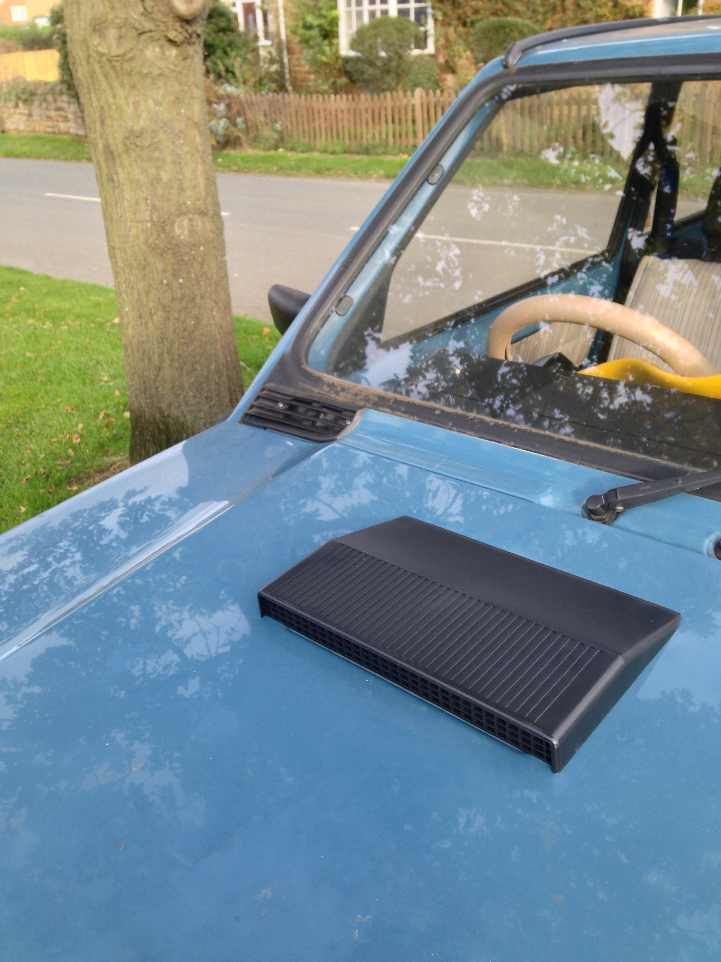

Pippin's not had a lot of love, recently: what with me being ill; repulsing Vogons; the arrival of Hal, etc.. However, god bless him, apart from a little initial fuel starvation, he started, yesterday -- after a month stood idle -- at the first turn of the key...! (y)
As a reward, I cleaned all the dead oak leaves out of his scuttle and bonnet vent, and treated him to this...! :)

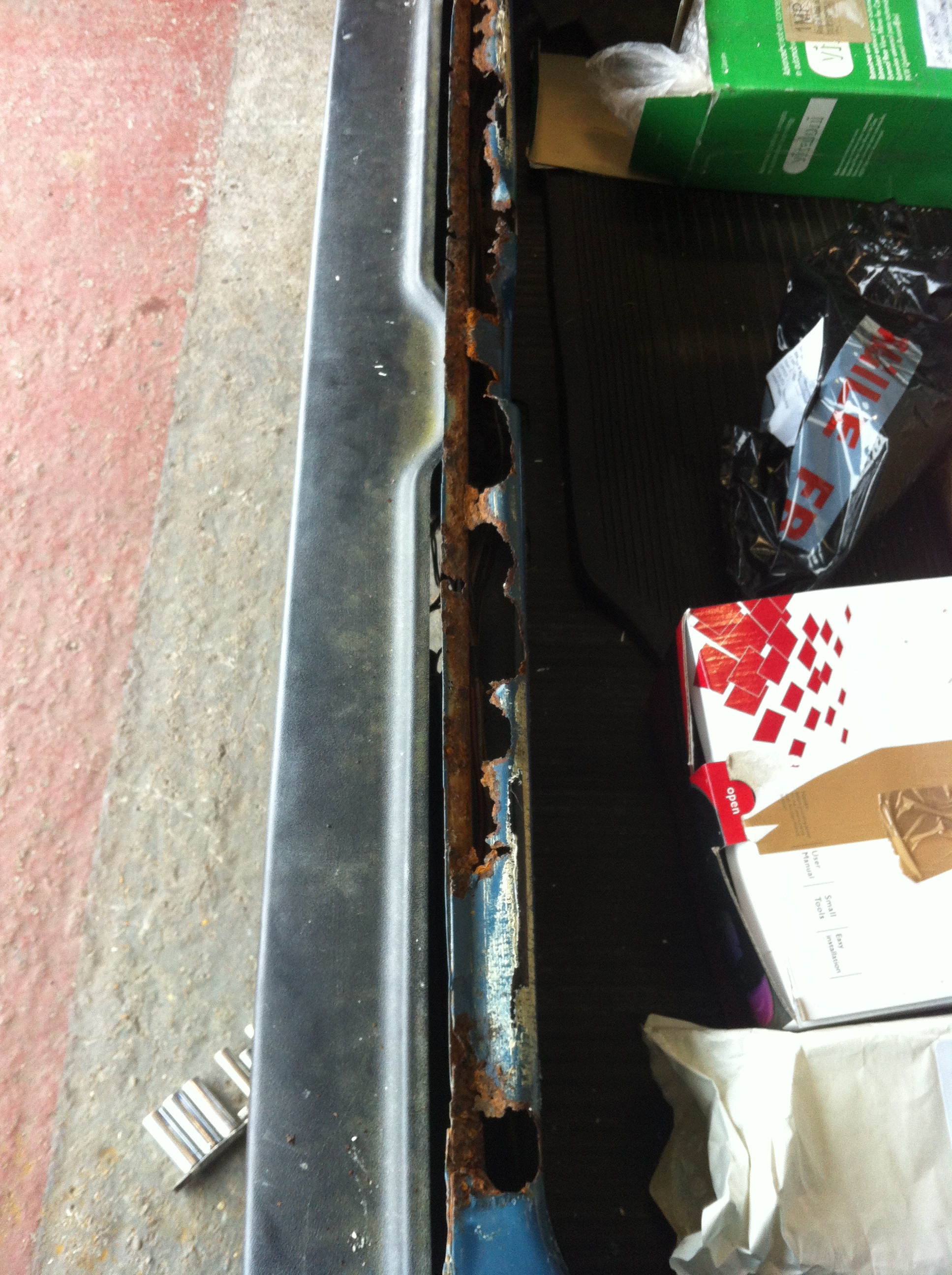

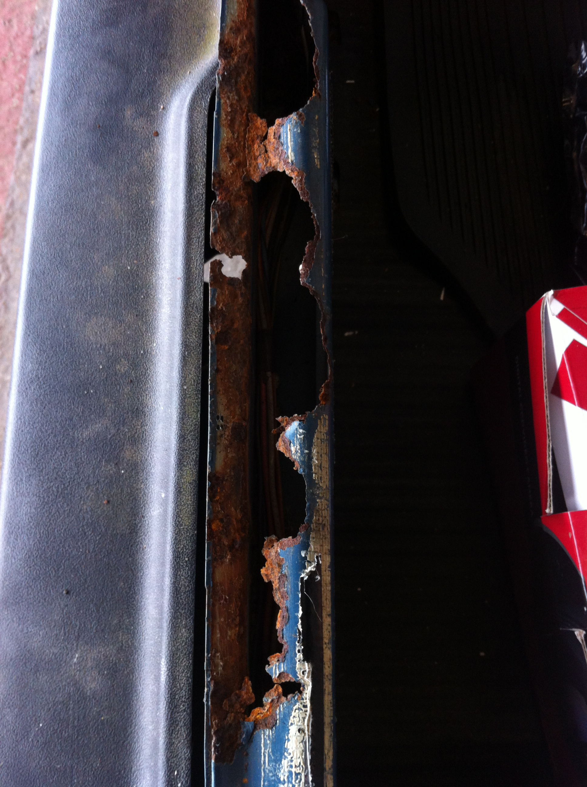

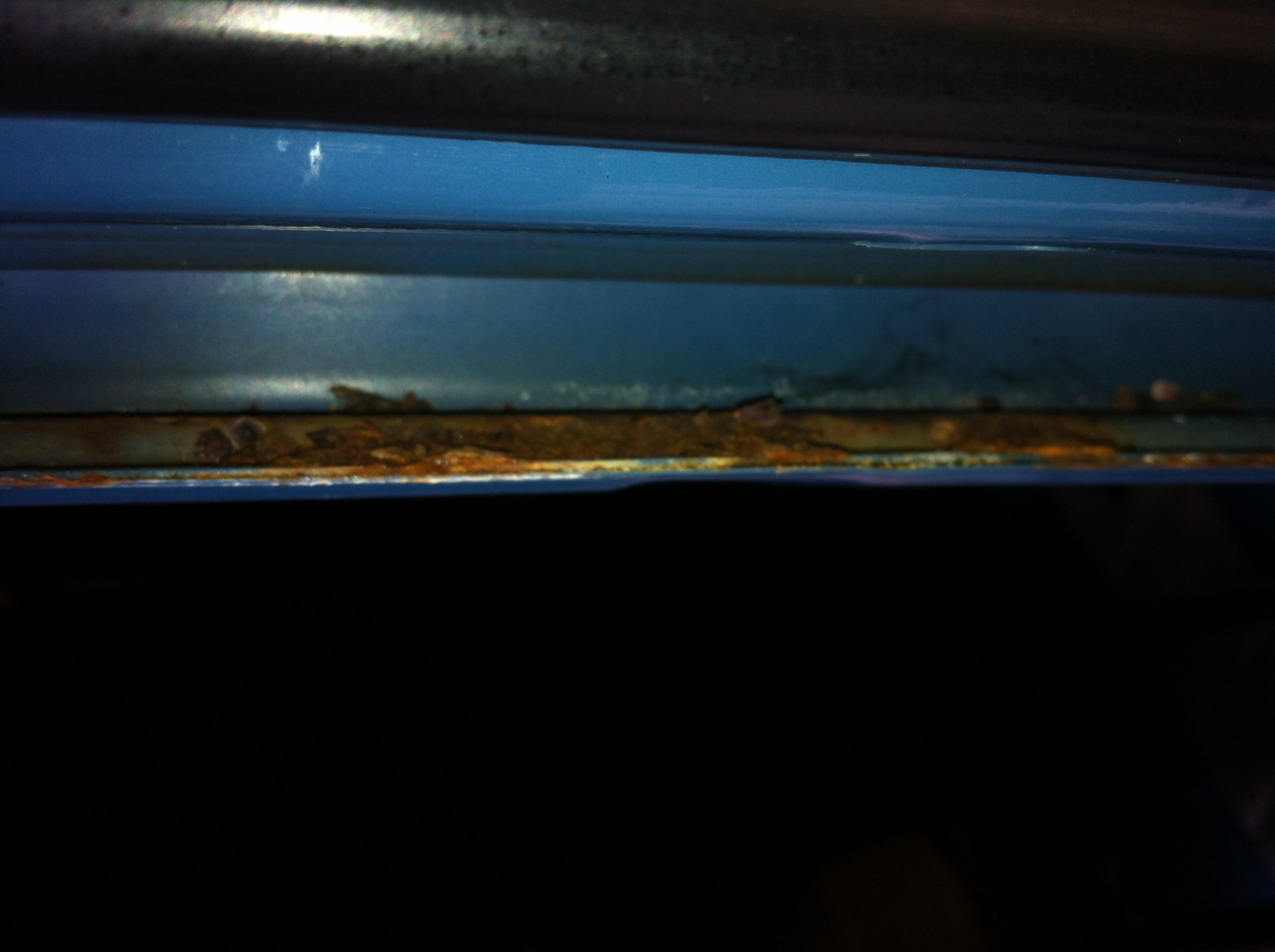

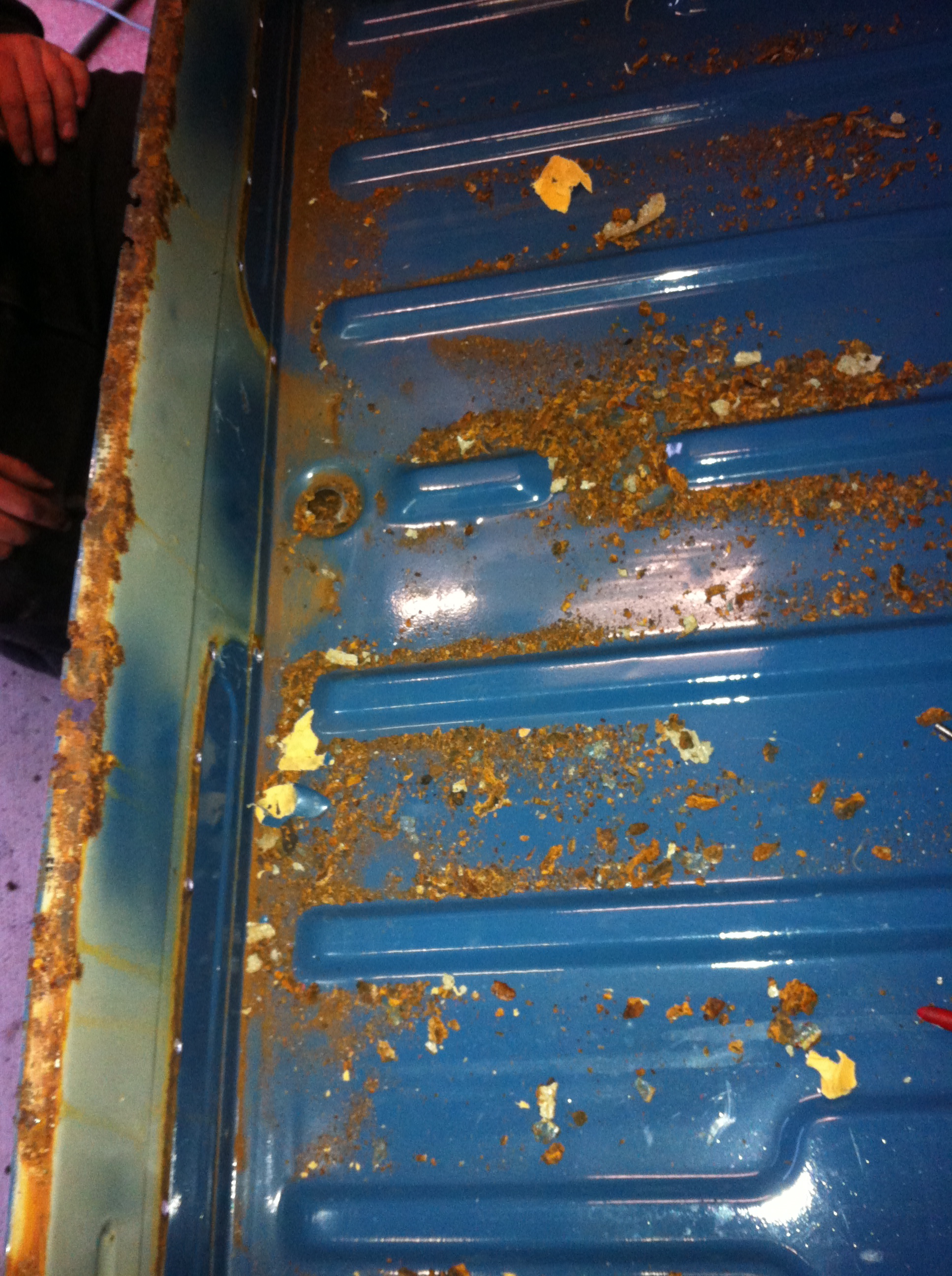

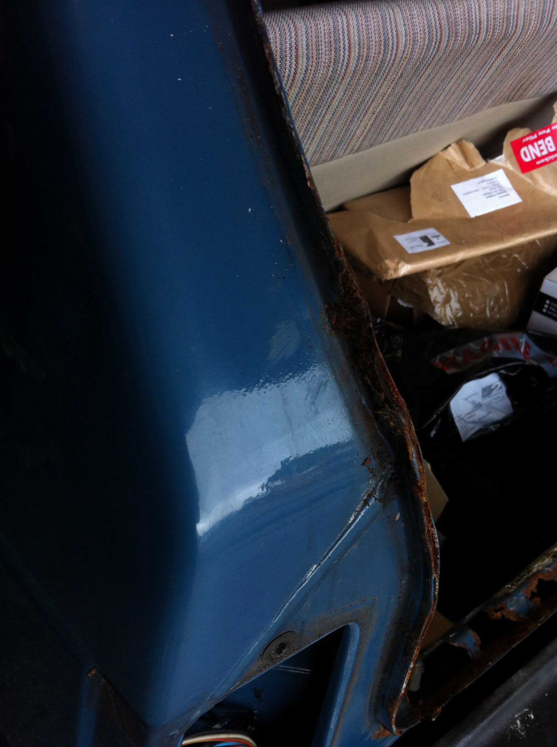

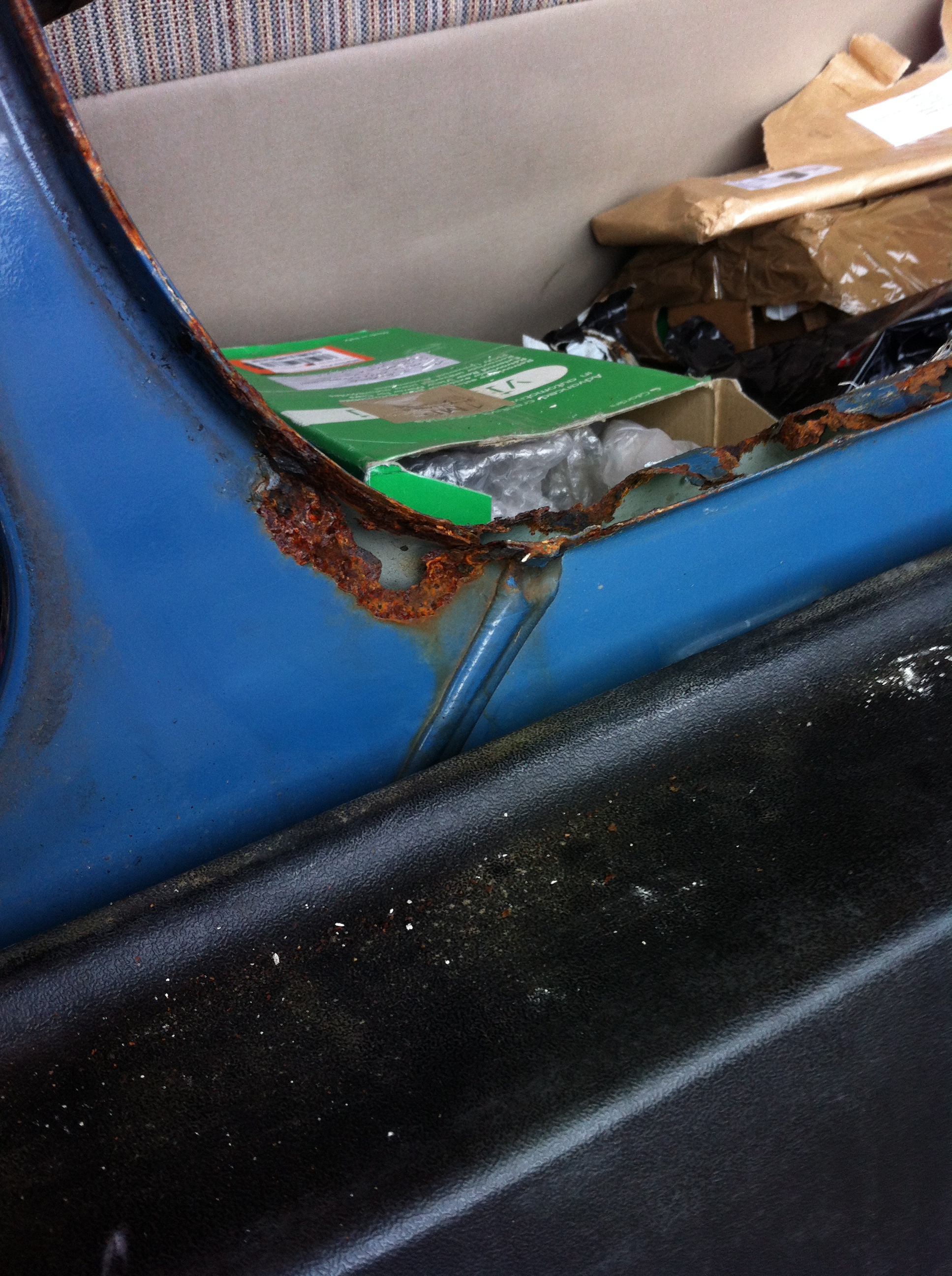

This is the state of the rear panel under the tailgate rubber and three feet of duct tape, with a close up of the worst bit.
There is also a little rust at the side and top edge........

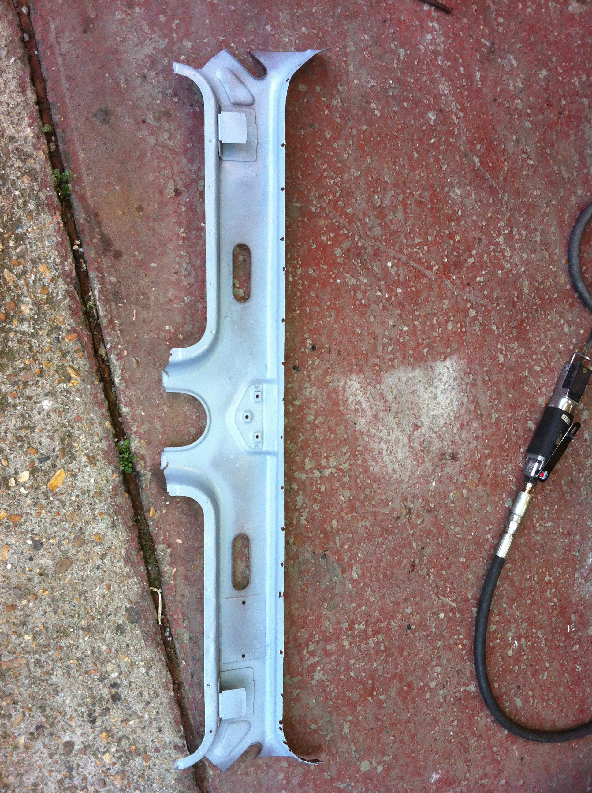

The only way to tackle this properly is to cut out the inner rear panel, repair the outer panel, then weld in a new inner panel. The rust at the top is not serious and can be sanded off, treated and painted. I'm pretty sure we won't easily find a new inner panel so I've cut one from Dora the donor Sisley, it's surprisingly rust free given the condition of the underside!.........
It's been painted with weld through primer and is now ready to fit. The old panel on Pippin has also been cut out........
