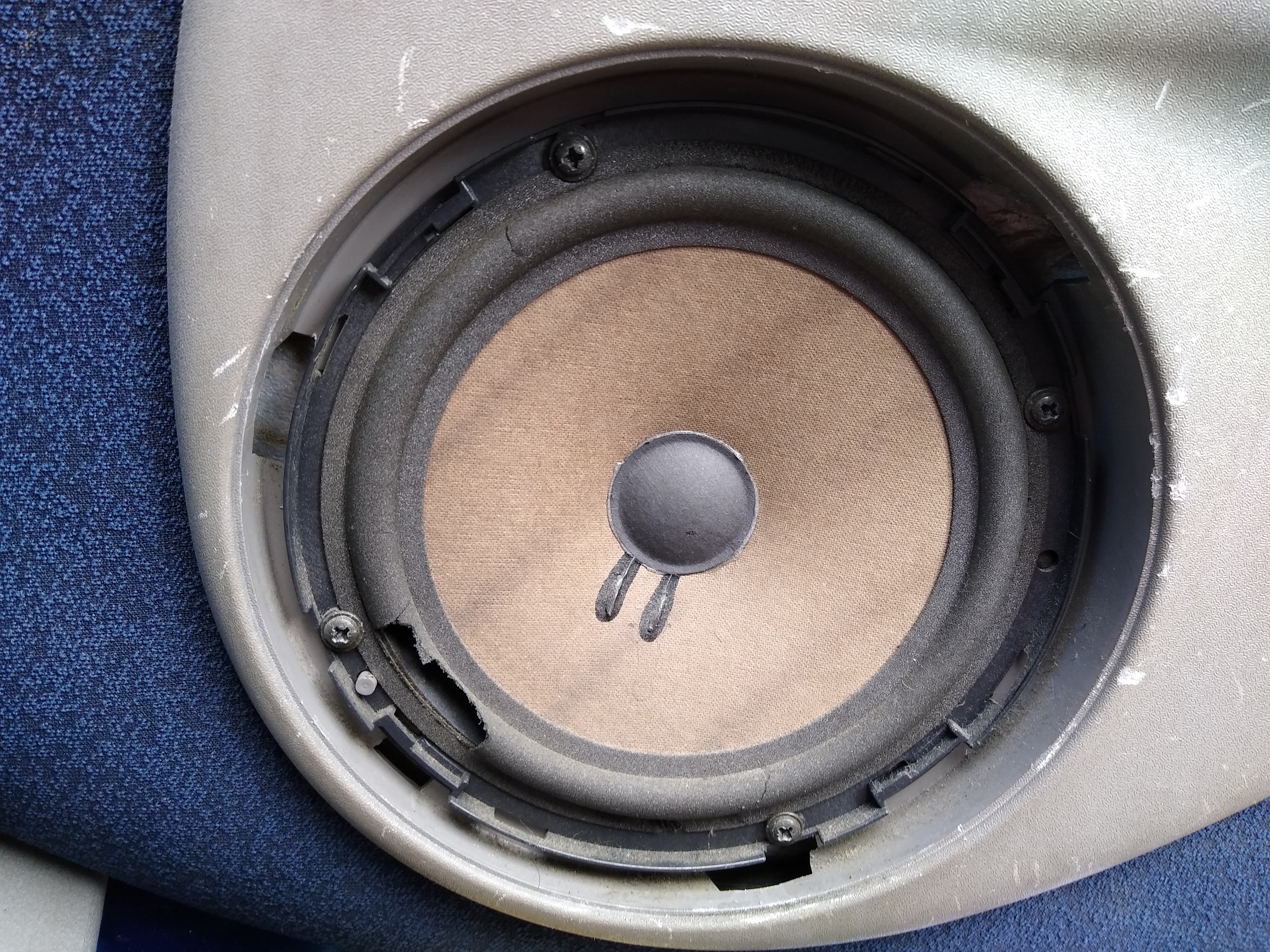

Got an annoying vibration from the front drivers door speaker this week and when I pulled the grill off for a look it appears that the foam around the cone had crumbled.
If anyone has a speaker for sale,let me know.
If it’s the same as a 2013 Punto (quite possibly by the looks) you can have my old ones for price of postage, I can send some pictures?

I've dug them out of the loft and I'm pretty certain the speaker is the same but the surround mounting appears to be different, it could be possible to separate the driver from the mounting and swap them over? Let me know if it looks possible on your broken one, if so I will PM you.
Hi Didge, unfortunately they look pretty much sealed together on my ones and I'm not confident I could separate the driver from the mount without damaging them

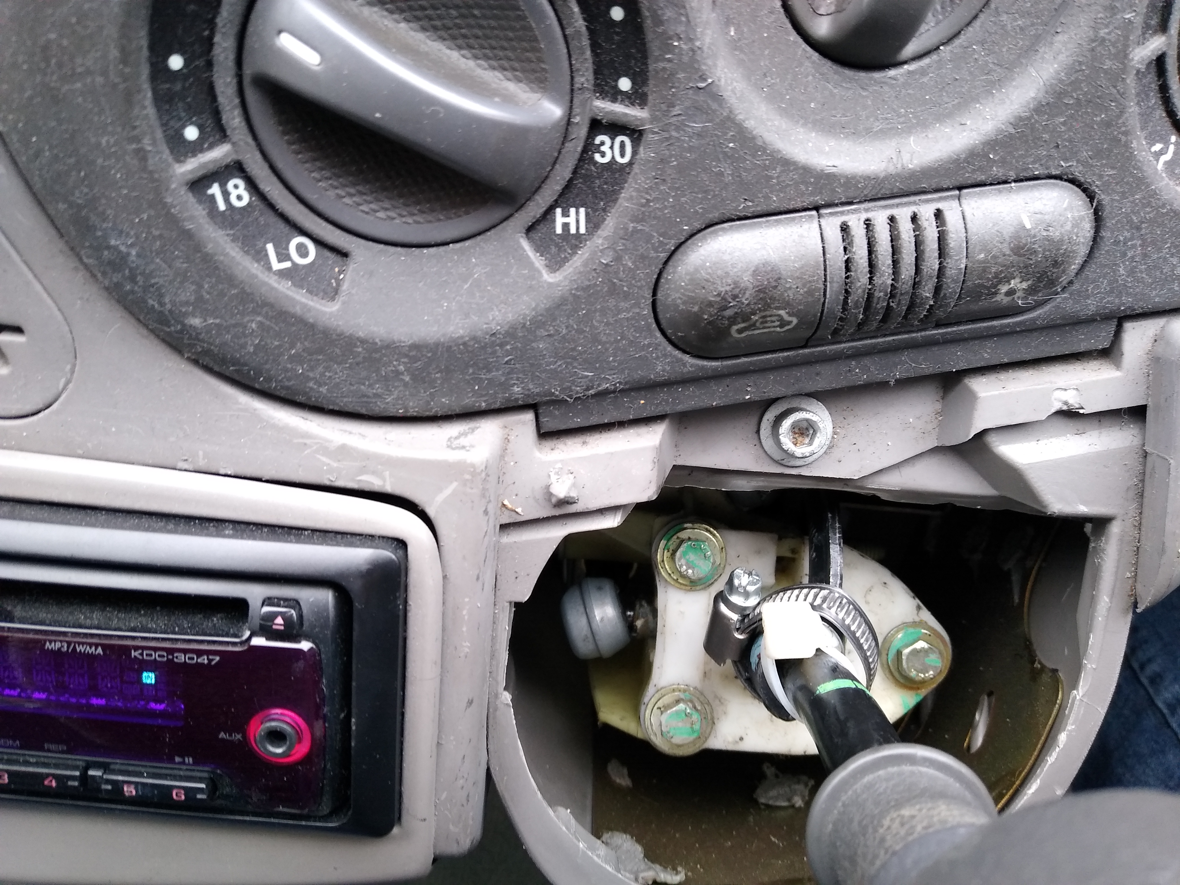

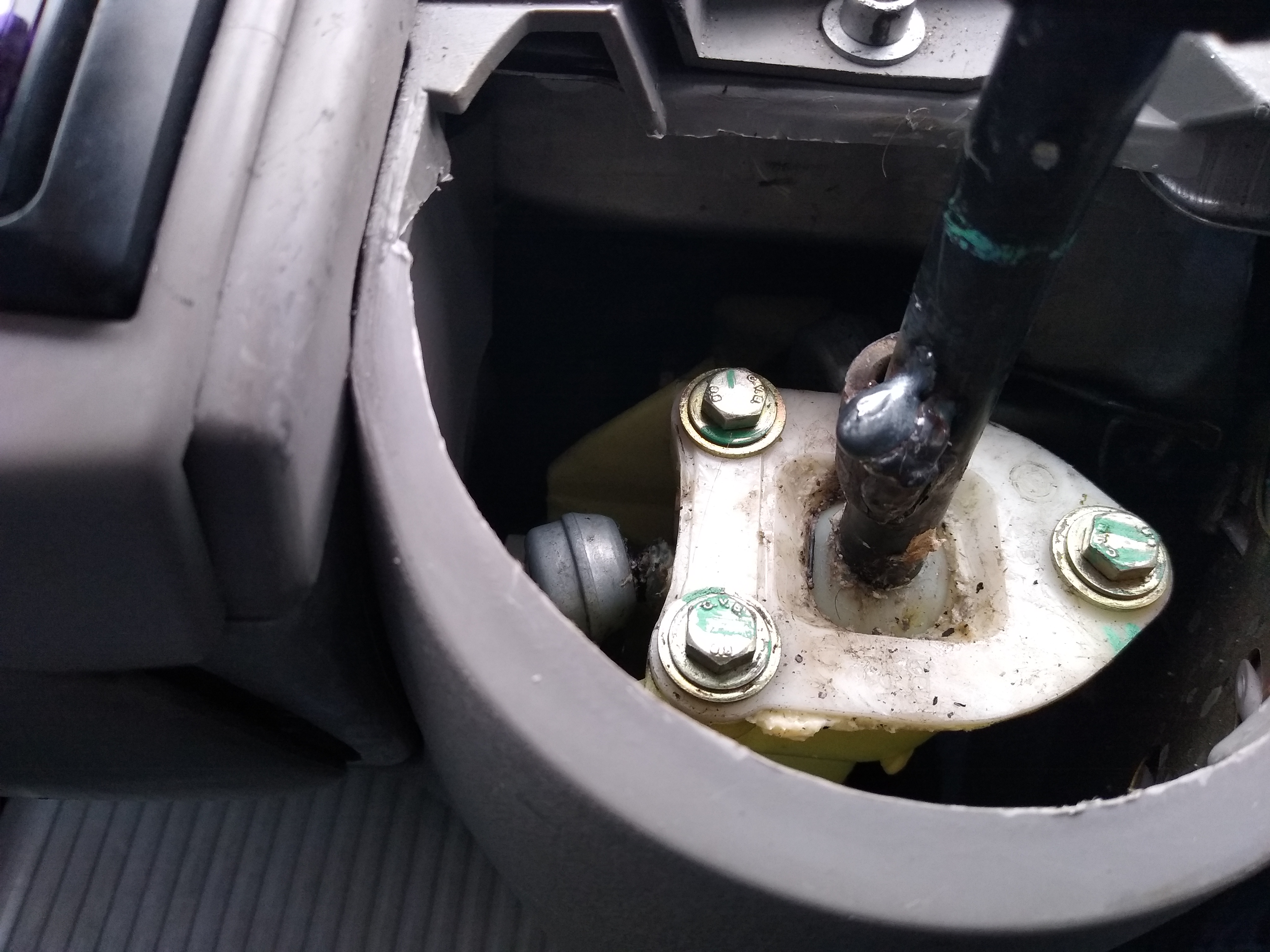

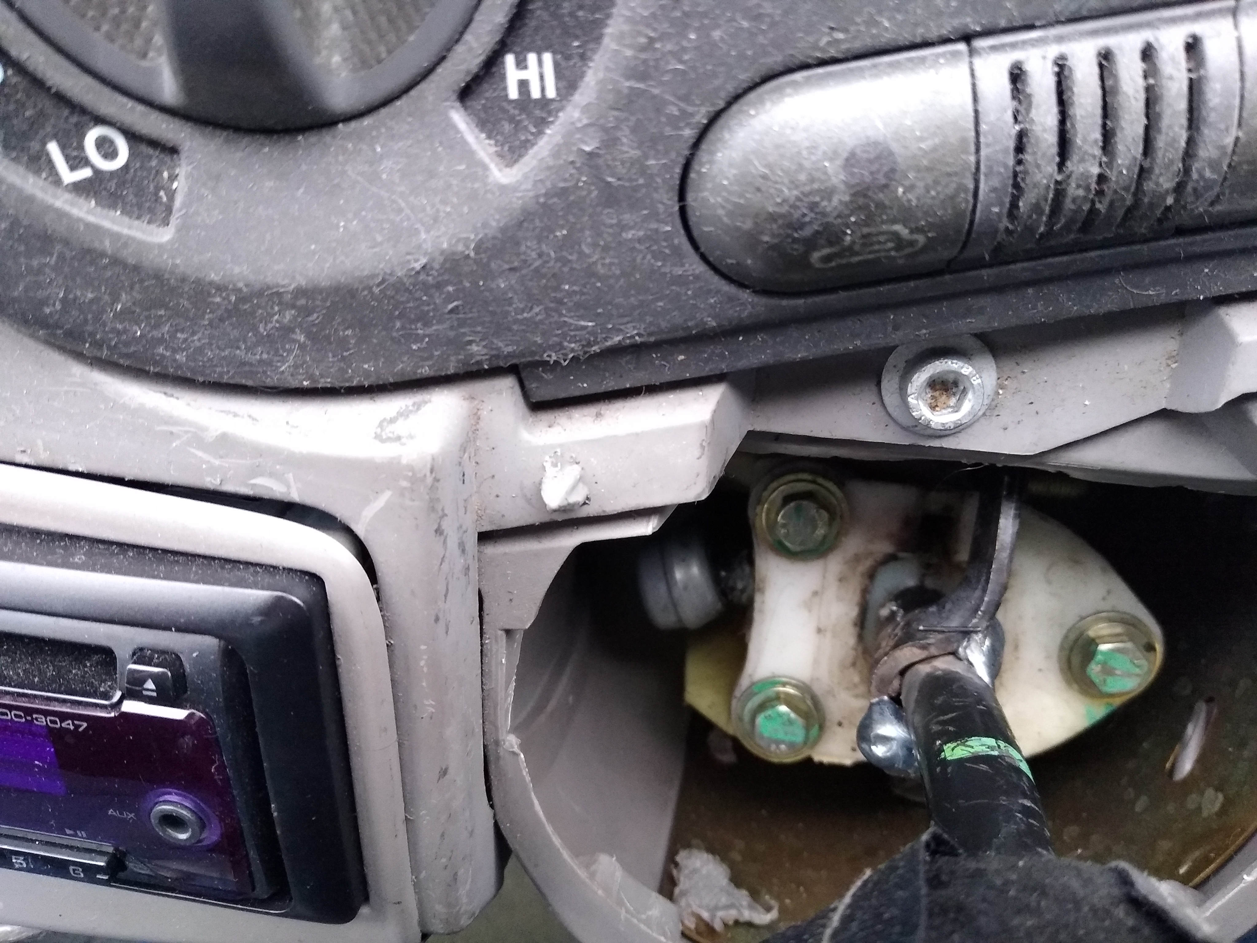

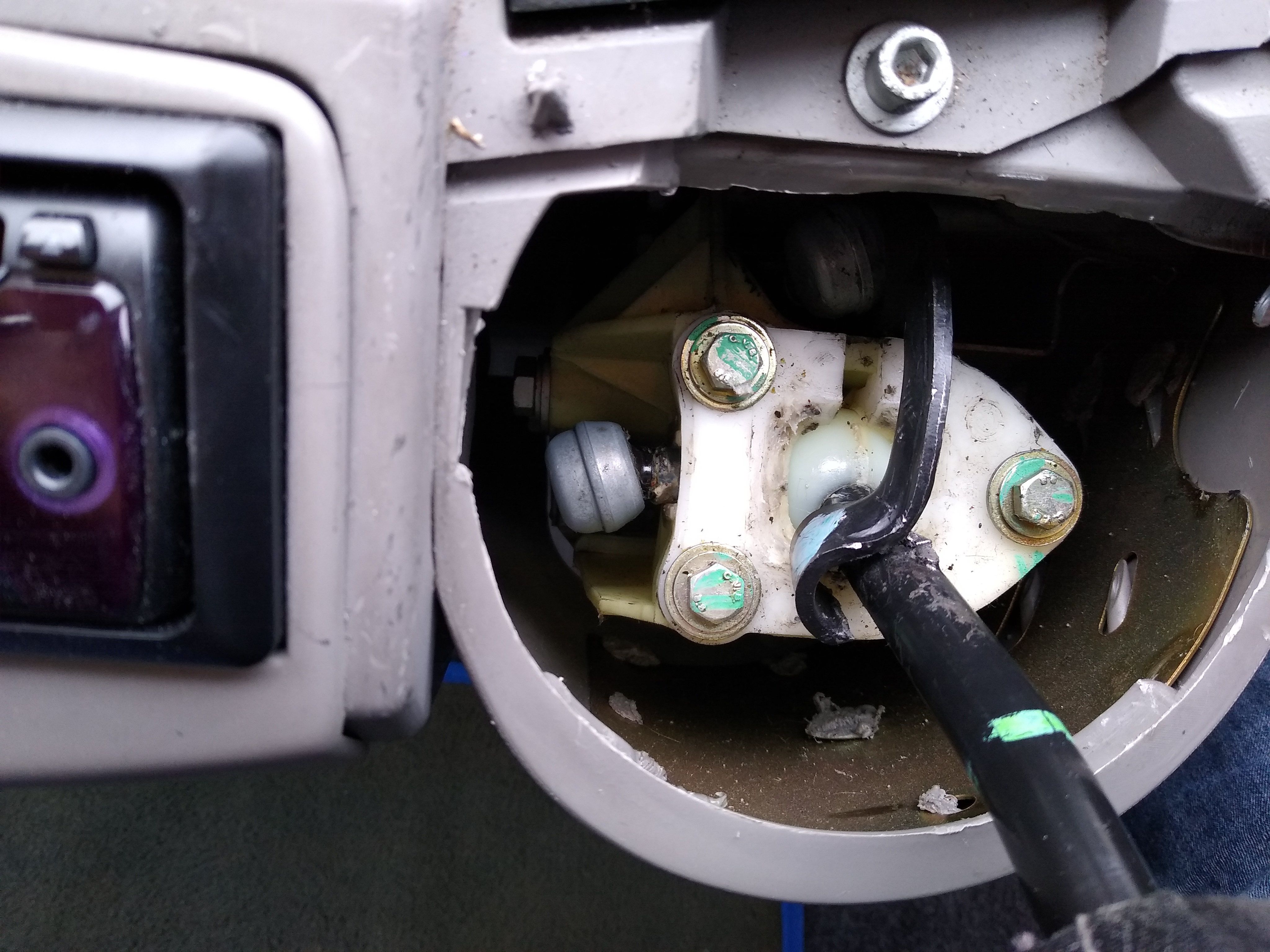

Well,it had to happen eventually..... Glopsy left me stranded last night.
After getting back into it The gear lever went sloppy and she was stuck in reverse and having looked under the gaiter it would appear that the cable arm has snapped off of the shaft.
I'll go back later today and see if I can bodge the arm back on temporarily with a jubilee clip to just get her home.
