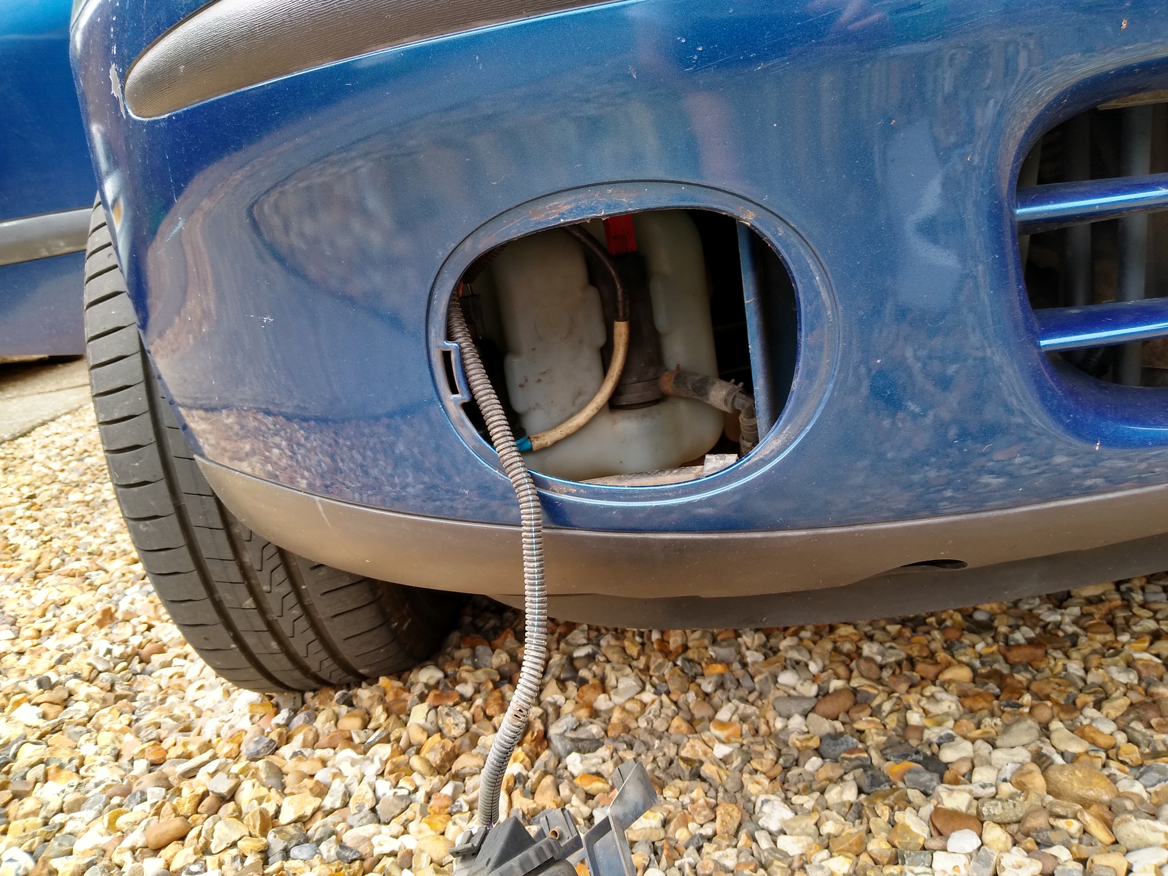

Got ab annoying job to look at today, my washer pump has decided to stop working properly.
I replaced it a few months back and it all worked but this week the only thing working are the headlight washers. With the lights off,the pump isn't being activated by the switch, so I'm hoping for a loose connection somewhere?
New pump arrived and fitted in less than 10 minutes. Still can't believe the last one didn't even make its first birthday!
