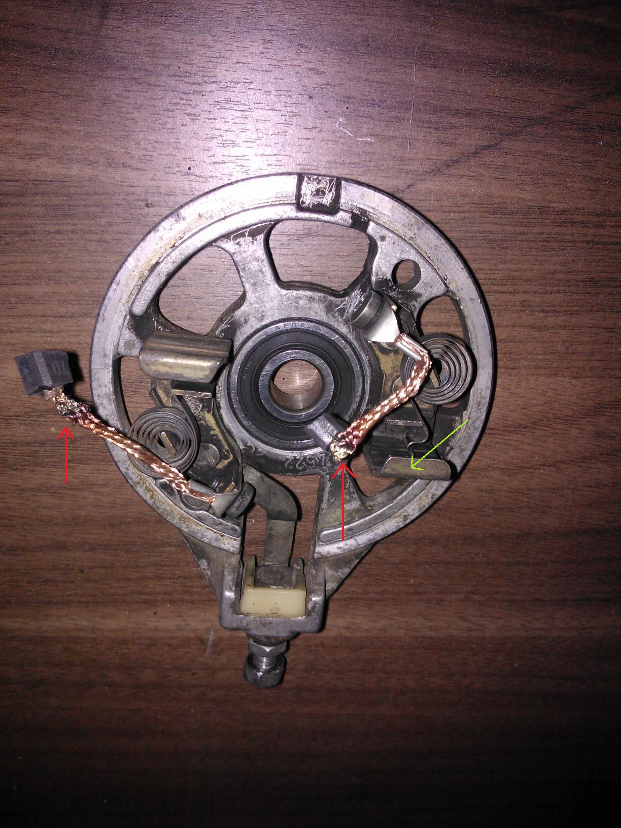

Check the pics. The brush wires looked like burned(red arrow). Should the brush wires be off the end plate, now they were in contact with the place were the brushes is mounted(green arrow)? Are the springs fitted correctly?
There should be no discernible wear after 150km except the bushes should become shaped to the curvature of the armature contact. Were the bushes new 150km ago? Are the bearings in good condition - play in the armature may cause premature wear.
Jep. New bearings no play. And new brushes. Cant understand. Why are the copper brush wires burned at the brush end? Do I have some break somewhere or whats the problem. What would you suggest to do, new wiring maybe?
If someone who understand, does the copper wire not be in contact with the metal were the brush "moves"`? Just wondering because this is the place were the wire is burned and maybe caused heat or something?
Jake,
I've heard of brushes wearing very quickly and your problem could be just that if you've used brushes made of very soft carbon compound.
Your tensioning springs are OK.
It is also not unusual to see a bit of sparking between the brushes and the commutator as they settle in.
One of the brushes will be earthed and the other connects to the generator output. In either case it doesn't matter if the bare wire touches the brush carrier because the brushes themselves are electrically conductive. Have a look at the brush carrier on the active side and you'll see that the whole thing is separated from the housing by an insulator.

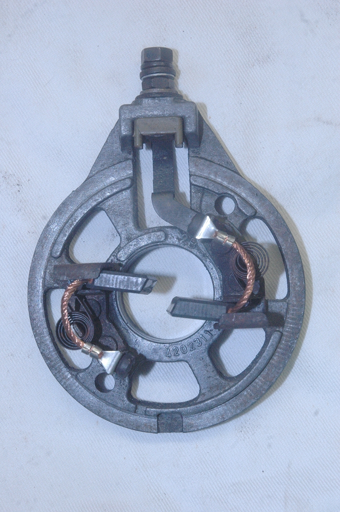

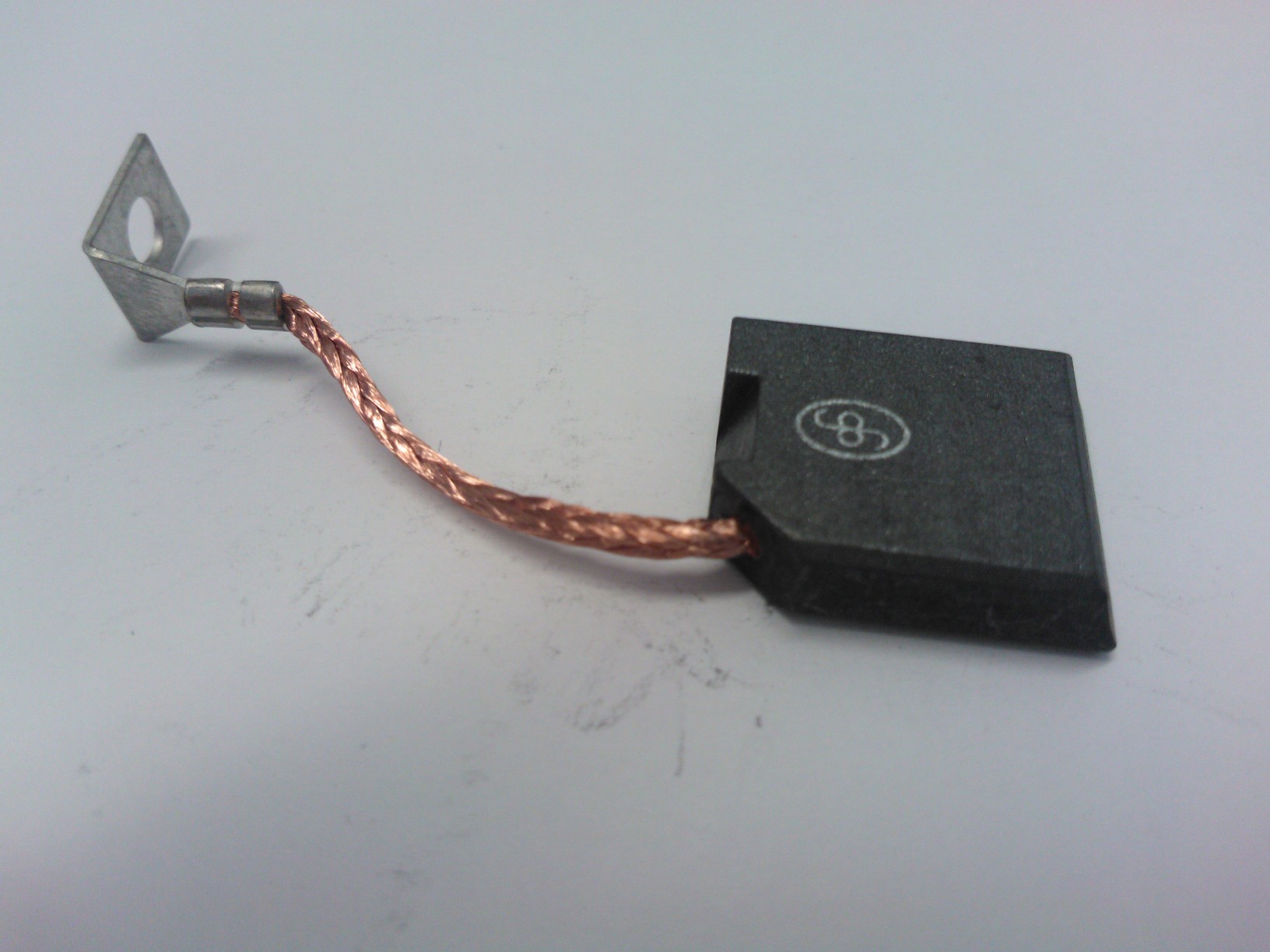

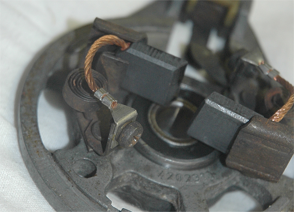

PS: I've attached a photo of my generator brushes.
Thanks Chris, good pics!

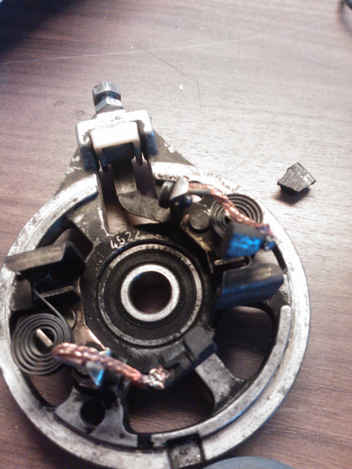

Here is the one i found on my local shop. They said its marelli :).
But the wires why are they melted/burned? My theory, could the spring tension be to high-->lot of friction-->heat to wires? The brushes tolerates heat i quess but the wires not so much. And the wires were melted at the place were they were in contact with the metal(were the brush seats)? Too far thinking? :D
Because when I first mounted the springs I mounted them wrong(they had no tension to push the brush) and I turned them abit? :D
The picture :)
Some update info. The brush wires were not burned as I said previously. I checked in good light today and they are just abit worn.
So, the brushes have worn quickly, but the reason is not clear. On italian forum, people say that the communator should be very smooth(how to get it smooth)?
Now the gaps in the communator are about 0.8-1mm which are in Haynes values.
