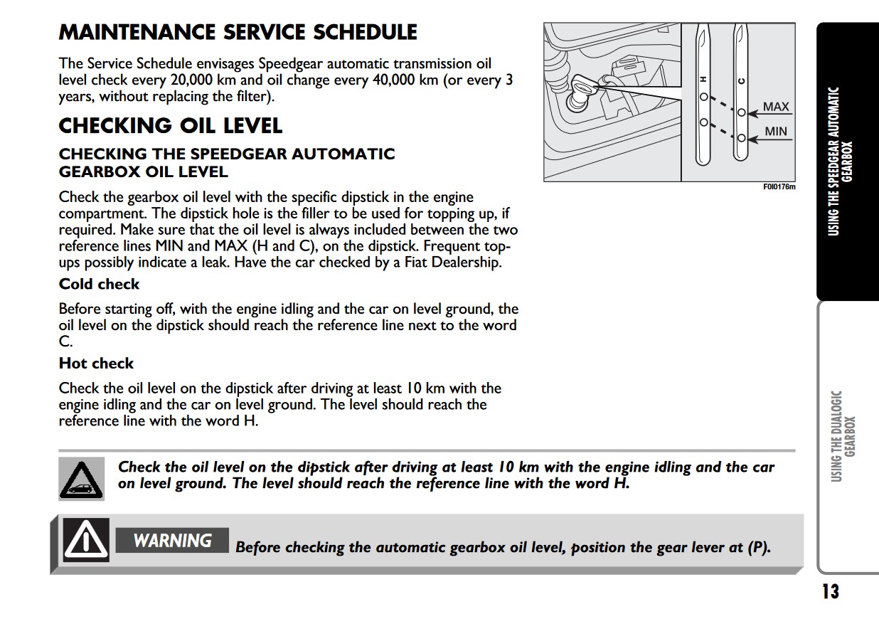

Hi, gearbox filler/dipstick seems to be just underneath the battery.
Speedgear manual is available to download here:
There's a guide to a Speedgear oil change with pictures here, hope it helps:

Thanks so much!
Hope it's nothing serious. Make sure you only use the specified grade of oil if it needs topping up :)
I was surprised to see Speedgear oil changes scheduled every 3 years / 40000km

Meanwhile, I won't be driving the car. Thanks to you, I was able to find the dipstick. The oil is low (though it didn't look catastrophically so) and dark brown - but also, I've started to hear a click in the gearbox when I touch the brake. I hope this does not presage doom. :-/
Sounds like it's due a transmission oil change. And I guess you're taking it to the garage rather than change it yourself?
If the level is a bit low, I would add a little oil to bring it up to level before driving to the garage if possible.
