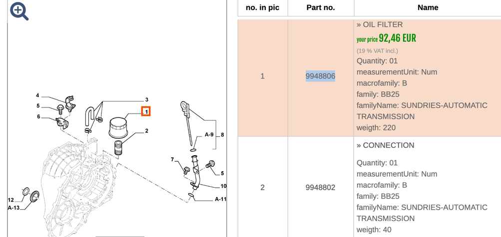

Officially, the required filter is Fiat 9948806, but at 92,46 EUR I highly doubt anyone reading this will actually purchase this filter.
So, look for equivalents. I went for Blue Print ADS72104 which has the same OEM number and retails around 15-25 euros depending on where you get it. I got mine on Amazon, but autodoc.co.uk or the like will stock it as well. I’ll admit I have not taken any of these filters apart to compare, so I do not have any particular preference as to which one is best – that’ll be on you.

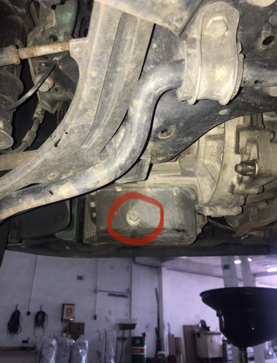

2) Locate the oil plug (as pictured on the left underside of the car, directly below the battery)

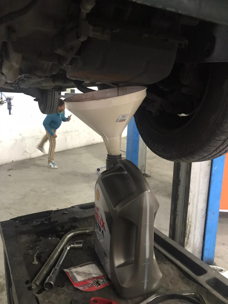

3) Get out the large funnel and stick it into the empty oil bottle
4) Stick the bottle with the funnel in underneath the drain plug and unscrew it with the 17mm. (as pictured). Take care not to lose the washer.
5) As you can see on the side of the bottle, I now know how much I’ve taken out

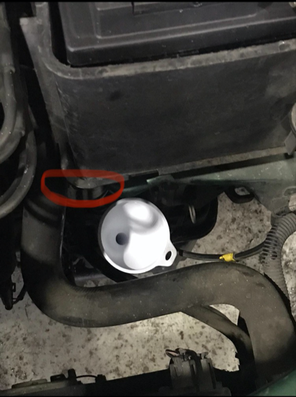

7) Lower the car and locate the external oil filter under the battery tray on the left side
8) Unscrew it with the oil filter wrench (put an old rug/bucket/the bottle+funnel underneath before). Space is tight, but you’ll manage!

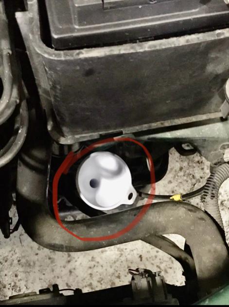

11) Lower the car and take the transmission dip stick out and replace it with the small funnel
12) Have a look at the oil bottle and check how much oil you’ve drained (in my case, about 2.8 litres)
13) Refill the amount you’ve taken out (2.8 litres for me) and put the dipstick back in
