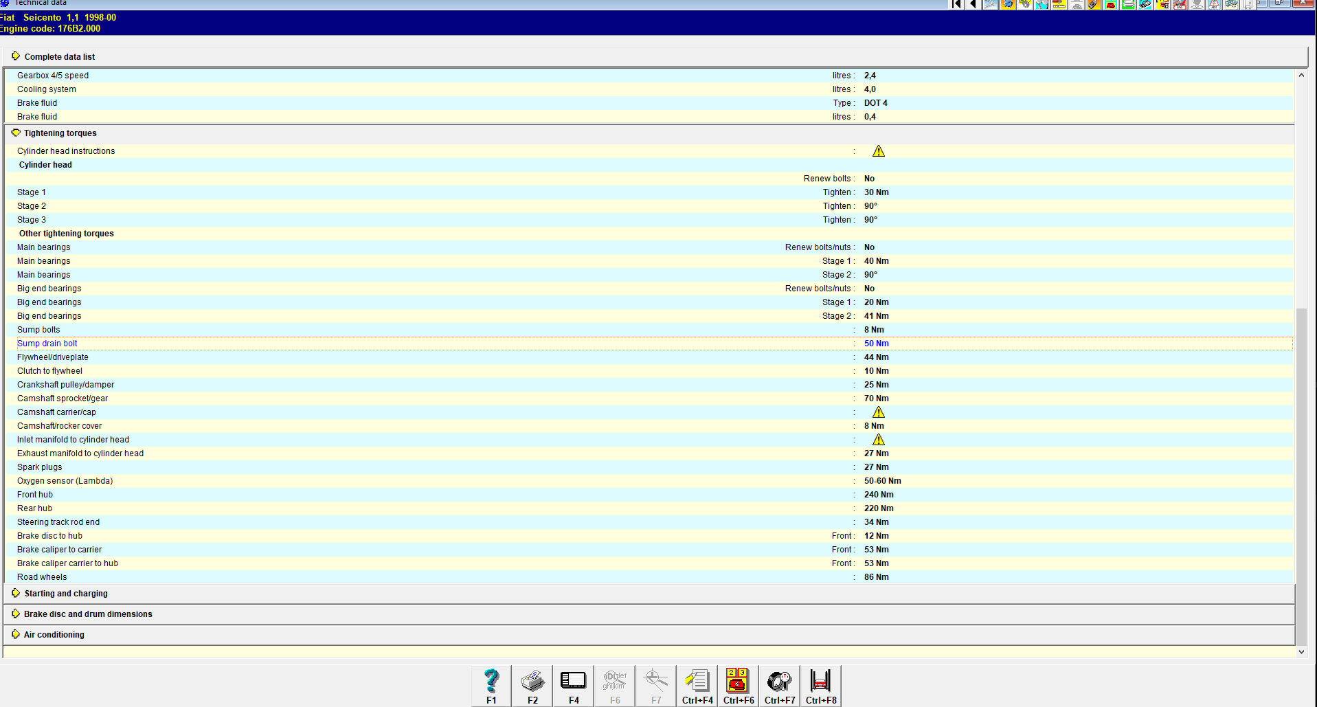

What are the Gearbox/Diff drain and refill torque settings on a Seicento 1.1 MPI 2002?
I've read 25 and 46 Nm. So I'm not sure which one is correct.
I did read that some one had cracked the diff due to over tightening the drain plug.
Thanks
This is the complete list from Autodata
