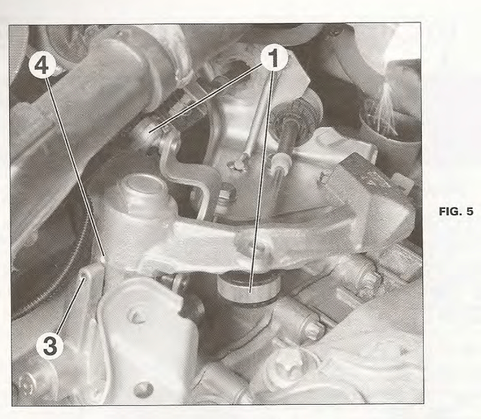

Thank you very much!, I found the workshop manual that says that I need to lock the transmission to avoid any gear shift, (image attached) says that I need to use a 5mm fitting, but I'm not sure if this is necessary, since it is not mentioned in the guide you posted.
Is there any video that explains it more clearly?
Thank you very much again!

I posted it on the right section but I didn't receive any reply, so I was trying to find other alternatives, however the guide postee by Koalar is indeed for Grands Punto
