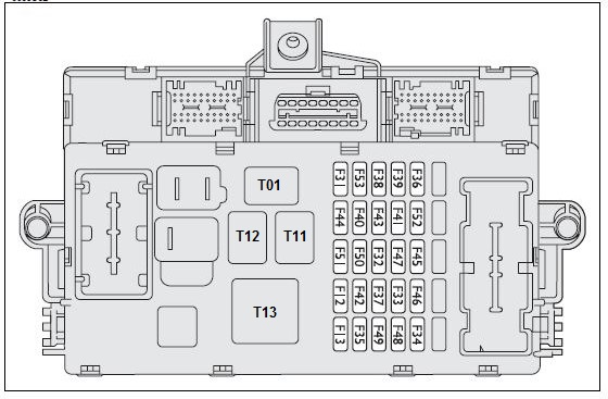

also there is two F31 fuses in the fuse box in the car........one bottom left and one top left....the top left is to bring the relay coil in
Top left is fuse F31 for the relay coil, bottom left is Fuse F13 for the left headlight dipped beam.
