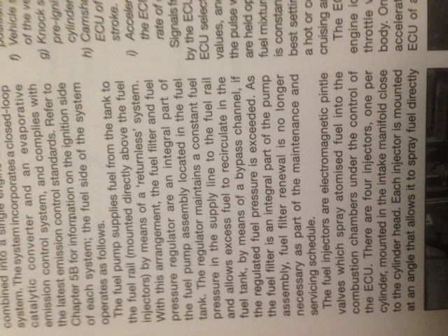

Info here
Info here
Thanks for the info. Looks like all the interesting devices are located in the
tank.
You wouldn't happen to know the operating fuel rail pressure?
I suspect between 40 to 45 psi. Not 18 psi which this car shows.
The pressure regulator looks like one of the goodies in the tank.
If I knew the proper pressure then I'd know my next step.
The punto is basically the same engine, must have a look over there.
Keep looking.............name of the game!
John.
Thanks for the info koalar.
Looks like the issue is with the pump seen better days. My guess would be that
its unable to hold pressure at all, because of contamination to the pressure
regulator or its non functioning.
At 3.5 bar (50 psi), is a big difference to the actual reading of 18 psi
(1.24 bar).
Whip out the pump tomorrow, and get a closer look at it in detail.
Again, thanks koalar for the info, much appreciated.(y)
I'll keep all up to date on the progress.
John.
