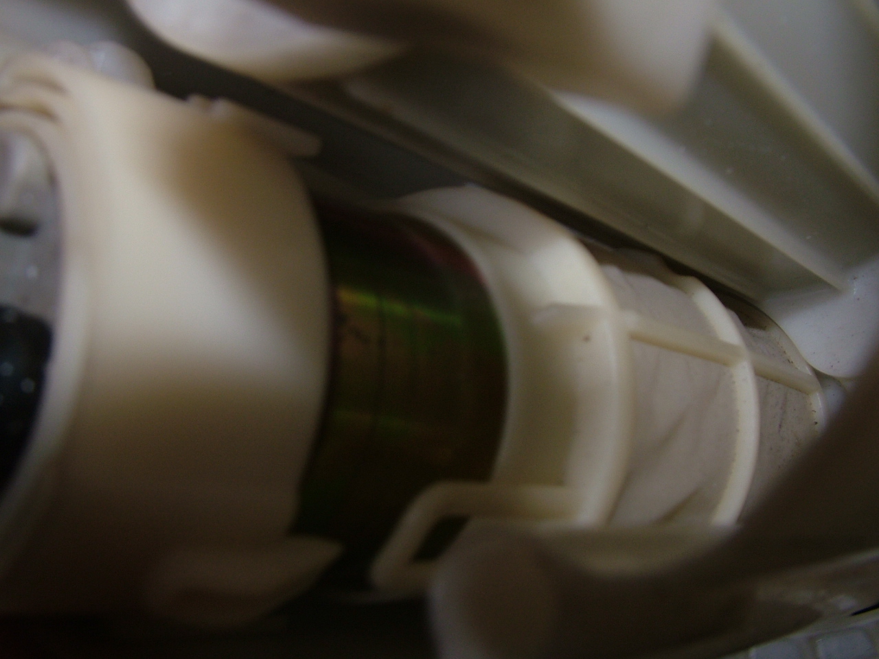

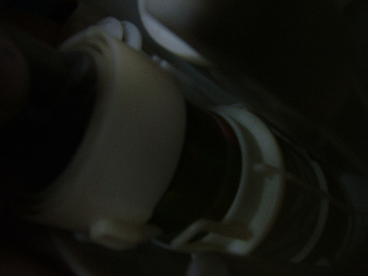

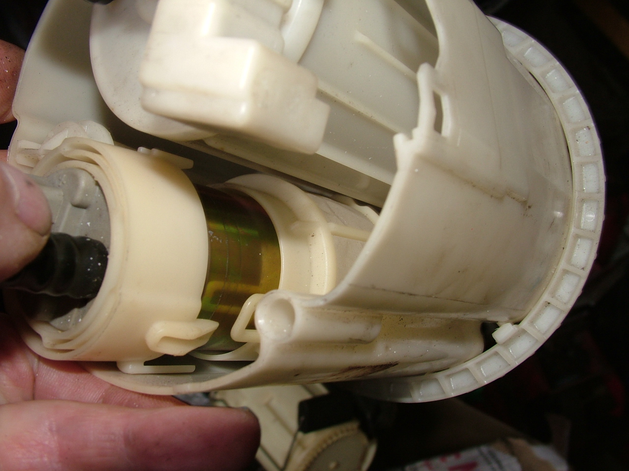

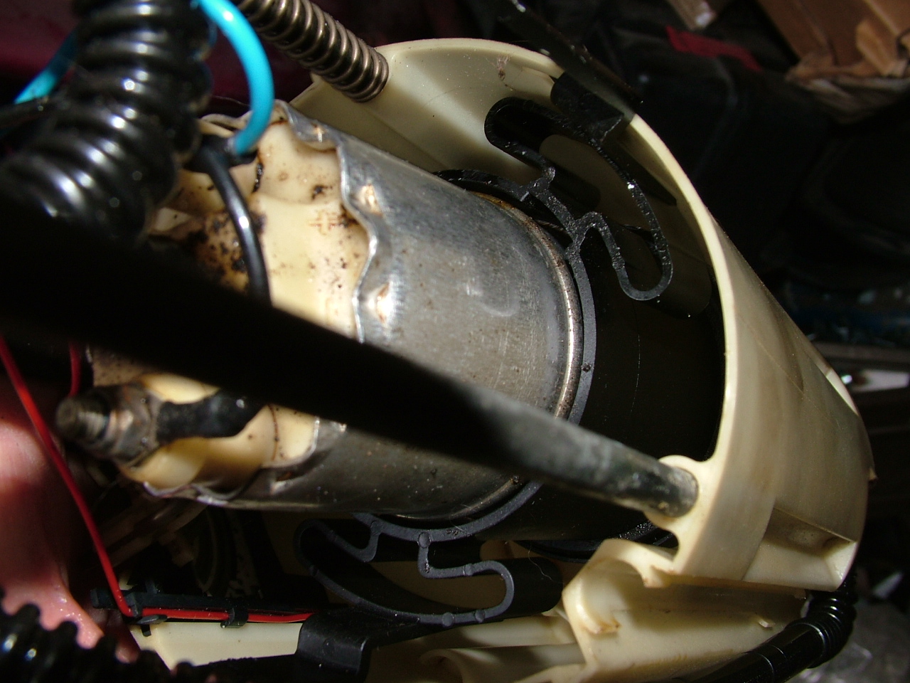

So yours is a petrol engine? I don't want to totally destroy these incase I want to use them, one was from a Fiat Doblo the other Fiat Punto. But basically the filter is what the actual pump body sits in and they are not normally serviced.
In the middle photo the pump body is at the bottom of pic. slide into the gauze filter part.
