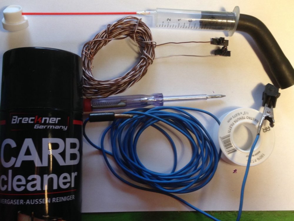

My recommendation: sort out what is the normal fuel pressure for that engine, if it's not 4 bar fix what's causing it (probably the regulator). Then, take down the injectors to see how they look and how they work. Having them on the rail, using a tester connected to the car, you can see them in work. Firstly, starting the fuel pump, see if there's any sipping from any of them and using the diagnose interface you can select each one of them to open and see how they spray and if is any sipping afterwards. If they need cleaning, you can either put them back and use a fuel additive injector cleaner (I used STP and was satisfied with it) or you can take them out of the rail and clean them putting carb cleaner under pressure inside them and intermittently connecting them to 12 V, using this kind of a system:
