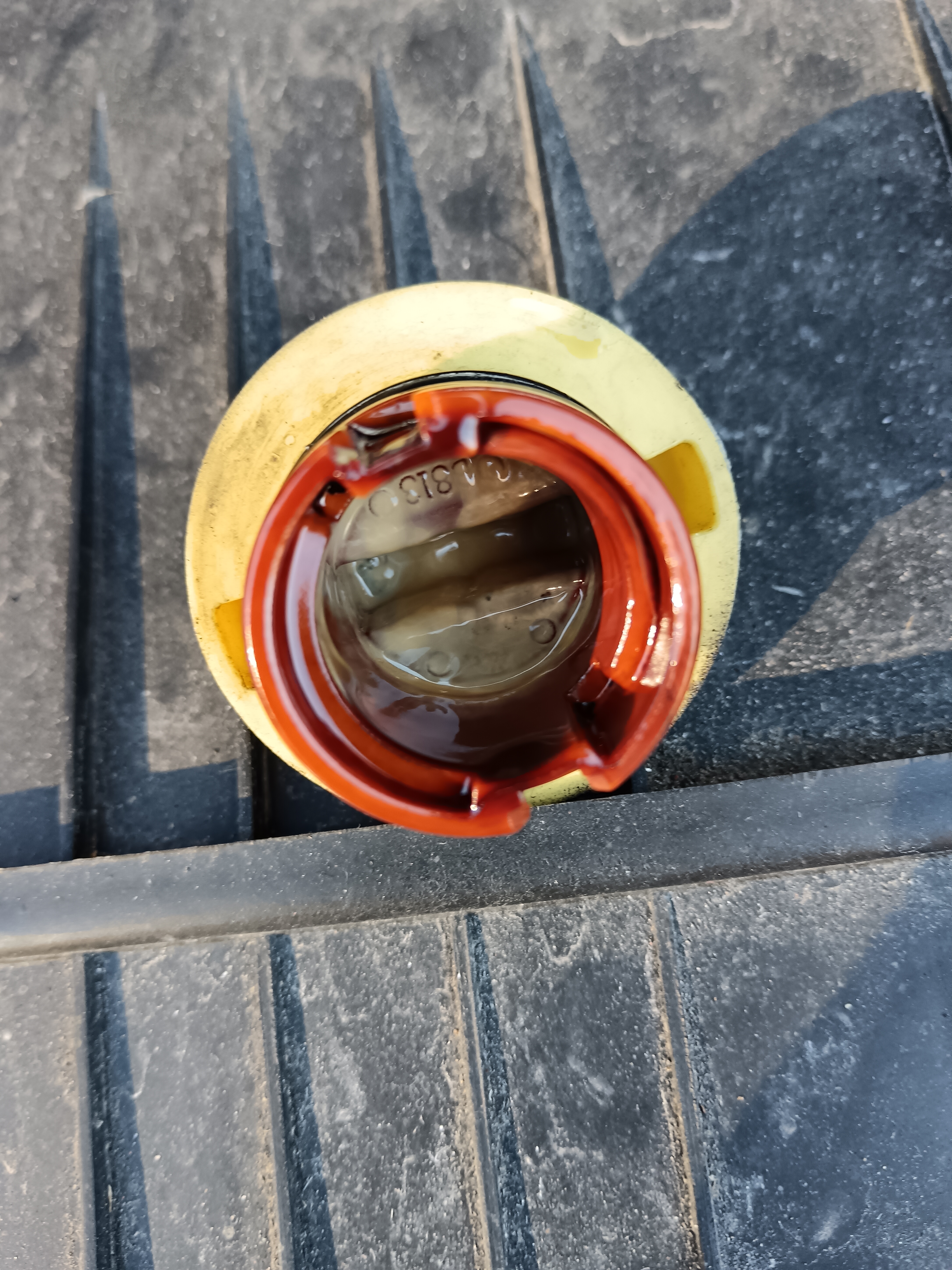

My 64 plate Twin Air lounge gets a small amount of beige coloured froth under the oil filler cap / top of the dip stick when I check the oil . Any body seen this and what it means ? I wiped it away but it comes back after a few hundred miles
The oil on the other end of the dip stick looks fine and doesn't seem contaminated and the engine performs fine . The water coolant level has not changed .

Hi 🙂,
Thats perfectly normal 👍
It's steam from Cold Moist Air in the cooler months Mixing with oil Vapour from the running engine, and blending this "Mayonnaise"
Pic of my 500's cap, and that does 2 hour trips..!

Thanks for the quick reply . Yes a bit like Mayo! It sounds plausible but how is the moist air getting inside the crank case part? Possibly from some condensation when engine is stopped in cold weather ? I can see your filler cap is not one on a twin air engine as no dipstick attached . We have two 500s with twin air engines in the family and the other one has not been effected by this at all . I am now thinking is there a crankcase breather/vent that I should check and clean ? Thanks
Not at all uncommon when its cold and wet ( last couple of months qualify id say!) check once a week and wipe out the cap , make sure the oil is kept at the right level, and check the coolant level is not dropping significantly! if you only do short trips and the motor is not at running temp for very long then it would be good to change the engine oil more frequently every 3k miles IMO! switch to a good quality 05w/40w around March time.
If you really want some re-assurance then you could get a block"sniff test"! kit to check there are no exhaust gases present in the coolant, just for your piece of mind!
Fairly simple. Hot air expands. This is released out of breather pipes in the engine. when the hot air from inside the engine cools down again after the car is stopped those breather pipes are able to pull cold damp air from the atmosphere back into the engine.

Agreed in fact it looks good. If you really want to be rid of it search catch can in the Panda thread.
