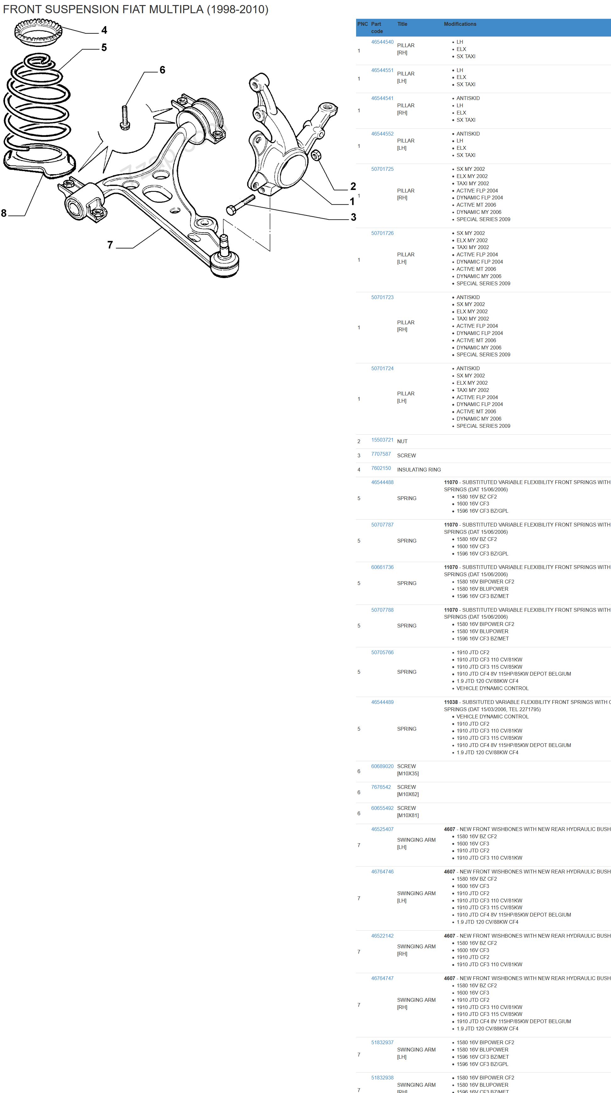

Hi,
Its not just you ! The bolts do tend to corrode into the alloy parts.
If you source fully threaded replacement bolts of a sufficient length you can cut to length.
Fiatdalys had a good online catalogue that you could find the part number you want and you can click a link to find other vehicles that part number is used on. Fiatdalys may not have that catalogue anymore.
J
Does this help?
