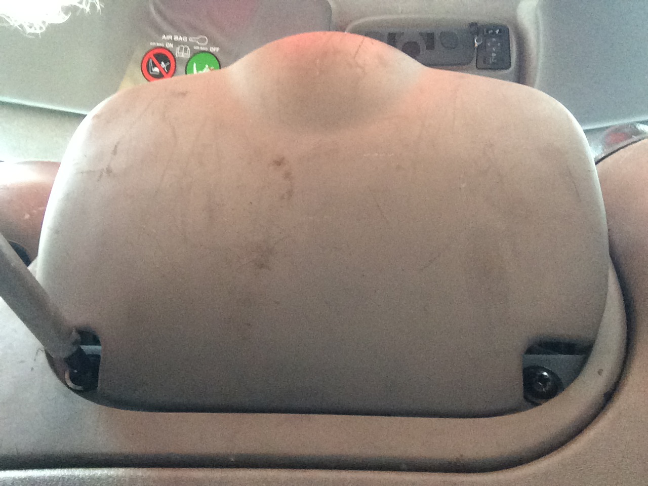

Two screws at the front of unit concealed behind buttons...pop thes off...then 2 more behind volumetric sensor. Getting this off Is the tricky bit.
There is a screwdriver/prising slot to the right...this isn't to prise but rather to put in a driver and lever the unit to the left...stick a finger up where the cluster for the mirrors was and shove down the volumetric unit...needs a bit of oomph...plane sailing after that.
You need to pop off the back of the light unit to access bulbs.

I bought an old Diesel 1.9ELX GTDin April from Gonnella Bros in Catford, London SE6 and tried in vain to get hold of a manual or Haynes to do simple jobs. Looking up on FF I could not find a string to remove the front light console (the interior light was not working). I had been tempted by the usual prise off with a flat blade screwdriver. Thankfully I did not force it after starting as found two screws exposed at the front and another two above the pull out volumetric sensor box. I attach images (I hope).
In the end the bulbs were fine so the problem may be elsewhere. The central id lights and rear boot light are working anyway so I think I shall skip it as the car will be banned in a few years time from London anyway in the ULEZ within the
