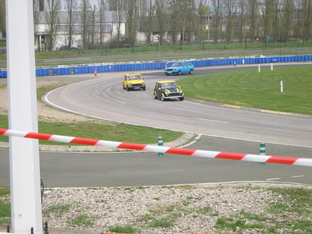

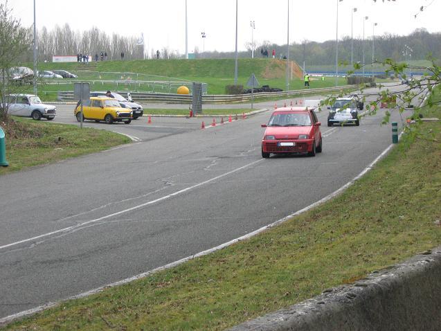

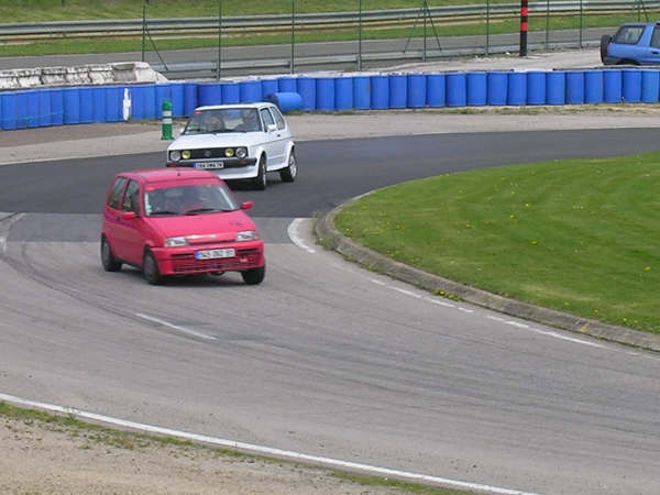

Some photo of the race track!!!!
The cinq was fabulous!!

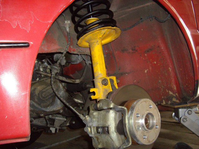

We restart our program for this year!!
we change our spring by other 30% harder!!!
difference of old and new spring:
The car is really better in this configuration! We just need to test on a race track!! :D We will do it in june!!(y)
