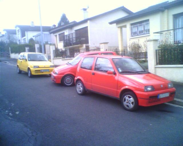

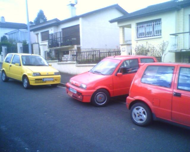

The work of this week end!!
We put our yokohama 185*60*13 on Uno Turbo Wheel! And we test !
In case of fire...:
We need change the form of the Cinq to permit the put of the new tyre
All my and my brother Cinque...
My cinque with new wheel and tyres...

The side profile is very high but given the internals of that particular Cinq, I can allow it! LOL
The modified bumper is growing on me, you could use another to join two slotted sections together so that they matched up and it would be lovely.
Keep up the good work.
Liam
They look like the very expensive Yoko's.
That video is goood, clearly a 16v turbo cinq is the best.
That thing is a weapon!

You're right! The tyres are Yokohama A048 185*60*13. Semi racing tyres! Bought in England!! ;)
It's the tyres which touch the car sometimes when the street is bad.
It must be better on a race track...
