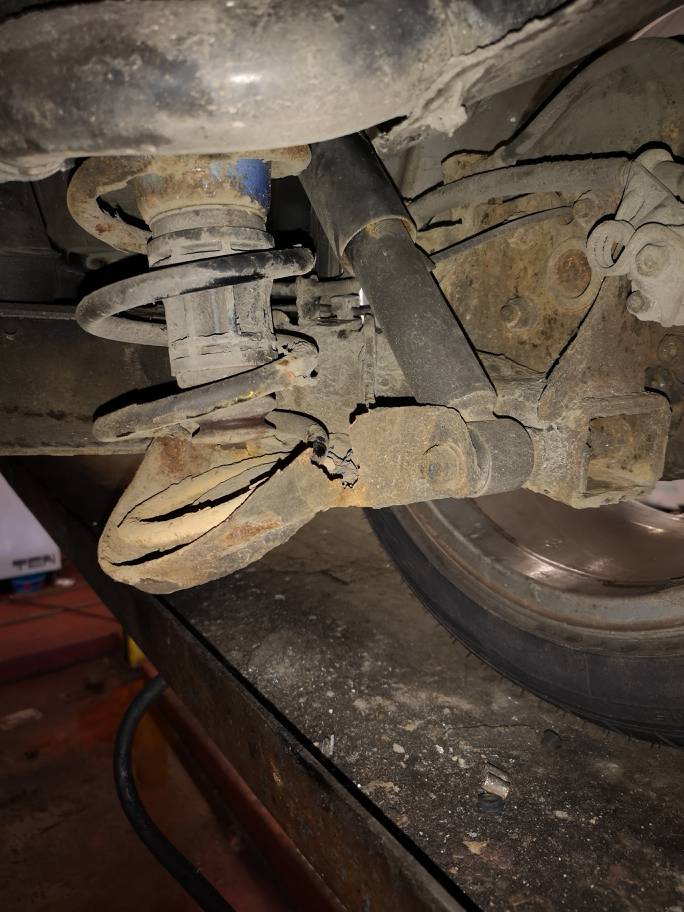

I might guess that the garage is suggesting you source the axle yourself because they know it's going to be difficult to find one without significant corrosion problems?
The garage is suggesting the OP buys a new aftermarket axle; they've even given him the ebay link.
At £119 +£20 delivery, it really makes little sense to go hunting for treasure in a scrapyard.

That's exactly what I was talking about as my "plan B" I'm especially interested to see that this one is talking about being made from "thicker" metal - +0.5mm spring pans, whatever that means. I take it to mean half a mil thicker than the standard jobbie? needs checking up on I think? - The problem with going this route is dismantling the parts you need to swap over from the old axle - like the brake back plates and hubs in particular. If I end up going down this route I'll be attempting to dismantle the old axle before ordering the new one. I'd be very tempted to source new bolts etc and just cut the old ones off with my angle grinder rather than struggle - and many on here have reported it's a very real "struggle" - with undoing the old ones.

I'm usually fully in favour of repairing old cars and keeping them going, but I must admit I thought this one could be beyond economic repair.
As others have pointed out, DIY the car could be saved for about £200 which I think is definitely worth it.
As it's all being done by a garage with new parts, it could possibly end up 10 times that. Then it's debatable.
On the positive side, you'll have a car with lots of new parts that won't need doing again (for 10 years or so...)
The issue would be - what else might need doing soon? Timing belt, clutch, front brakes, front wishbones, rear suspension, exhaust, etc.? Depends on the history & condition of the car.
Fired an email to them asking how much they think- depending on this will scrap or do.
as you say ££ debatable. See what they come back with. But as I said labour around £70 p h. So depends how long all this will take as appears the parts inc axlie cheap

I do believe near the coast I have had it a year. This is the 2/3rd MOT failure. This was part of the MOT before I got it which in hindsight I should have moved on!
Nearside Rear Suspension component mounting prescribed area excessively corroded significantly reducing structural strength Spring mounting (5.3.6 (a) (i))
This was part of the MOT before I got it which in hindsight I should have moved on! Nearside Rear Suspension component mounting prescribed area excessively corroded significantly reducing structural strength Spring mounting (5.3.6 (a) (i))

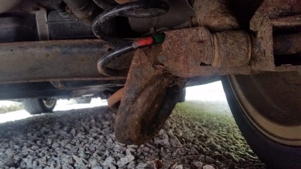

I have only seen a couple broken in pictures which looked more like weld fails than rot ?
be nice to see some photos of the rot.
Not the OP's:
Sorry for the graphic images of injured Pandas. An extreme example here:eek:: https://www.fiatforum.com/panda/441935-panda-axle-repair-6.html?p=4303672

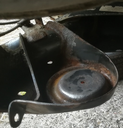

The worst rust on mine was in the same place, just inboard of the welds.
There was light pitting after 16 years on mine, important to catch it before it develops into deep corrosion and weakens the metal.
Not the OP's:
View attachment 219125View attachment 219132

Thanks very much for those pictures. They are a big help to me in assessing the condition of Becky's spring pans - which I would guess are somewhere in between those broken ones and yours.
