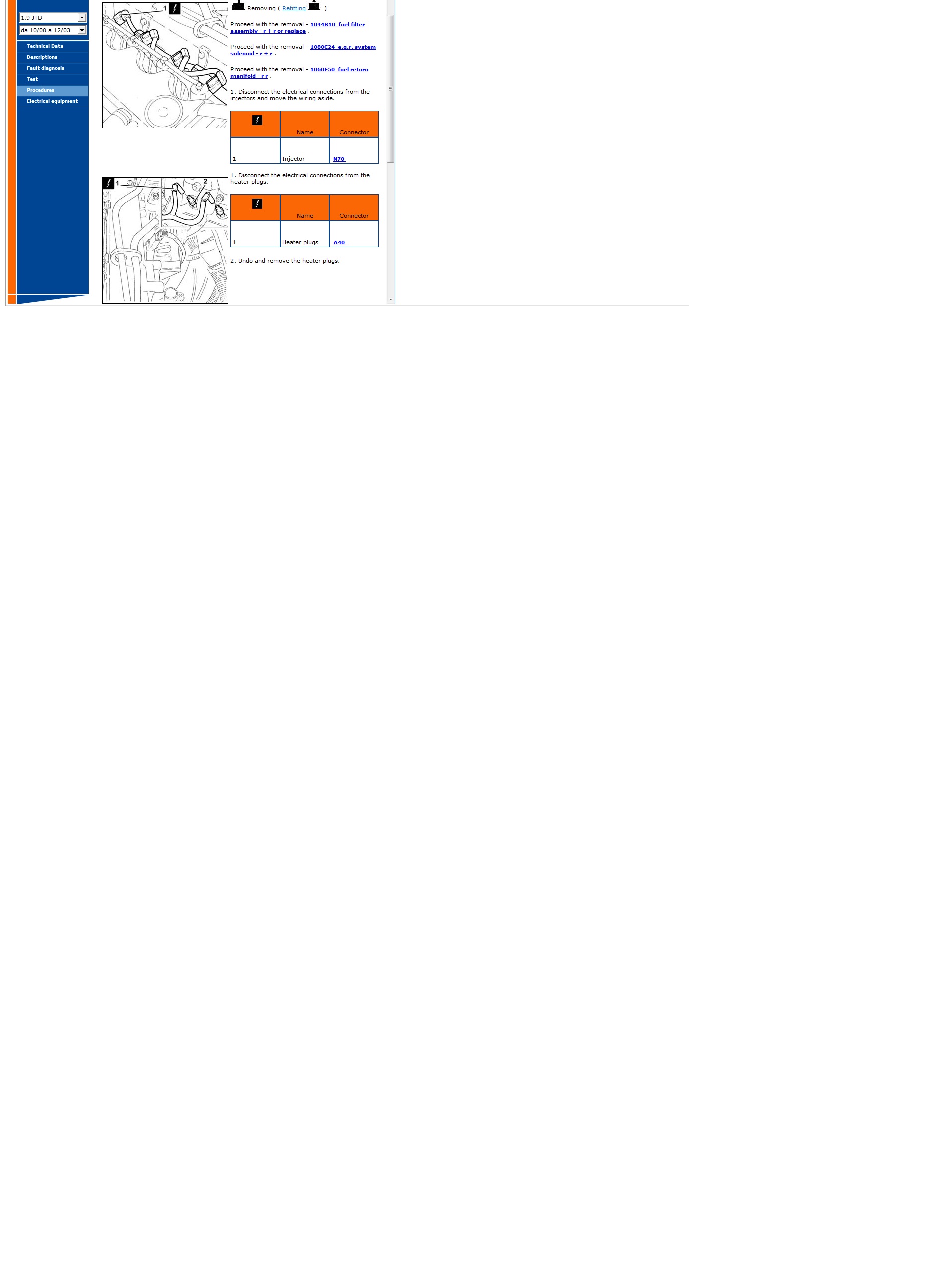

I'm struggling to even find the glow plugs, are they under the egr valve? Might have to buy a Haynes manual at this rate
Ok Ive had a look at the E Learn CD, I hope someone can shed some light on this but attached are the pictures which I think show the location of the plugs.
Looks like you have to unplug the injectors to get to the glow plugs, someone who has done this before may be able to shed some light?
I'll add the pictures below
