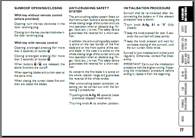

The switch you use to open the skyroof, push that in and hold for around 10 seconds. You should hear the skyroof moving slightly while you do it. Give that a shot and try it again. Chances are it'll work just fine afterwards.
Re: Sky roof not working
Might be worth pointing out that it's explained on page 77 of the Stilo Handbook that comes with the car under "Initialisation Procedure"! ;)
Really :confused:
Not in my manual there isn't
Yeah curiously there's a heavily-abridged version of the procedure described in the electronic copy that is floating around (as attached); not looked in my paper copy though so it may be in the newer manuals? I've never tried this one though, having only done the full open/close sequence when I had troubles...
