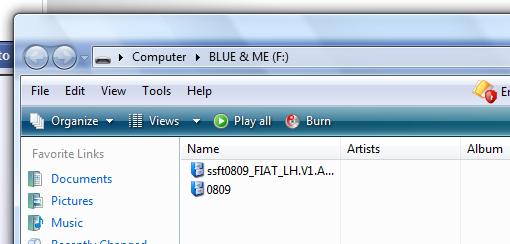

Can some one help me im getting the 'No English' show up when I push either the phone button or windows button and can't seem to update it. I am thinking I dont have the right files on the USB stick (attached Pic 1)
When I put the usb in the light is flashing to say it has power and that but it just keeps saying no english am i doing something wrong or am i not being persistant enough lol
I have had it working before but I dont know what happend
I have seen a couple of other threads on the no english and also relating to a usb error or something, but thought this one related to my situation.
Im sure i downloaded the right files and stuff
Any help would be great lol
Cheers
