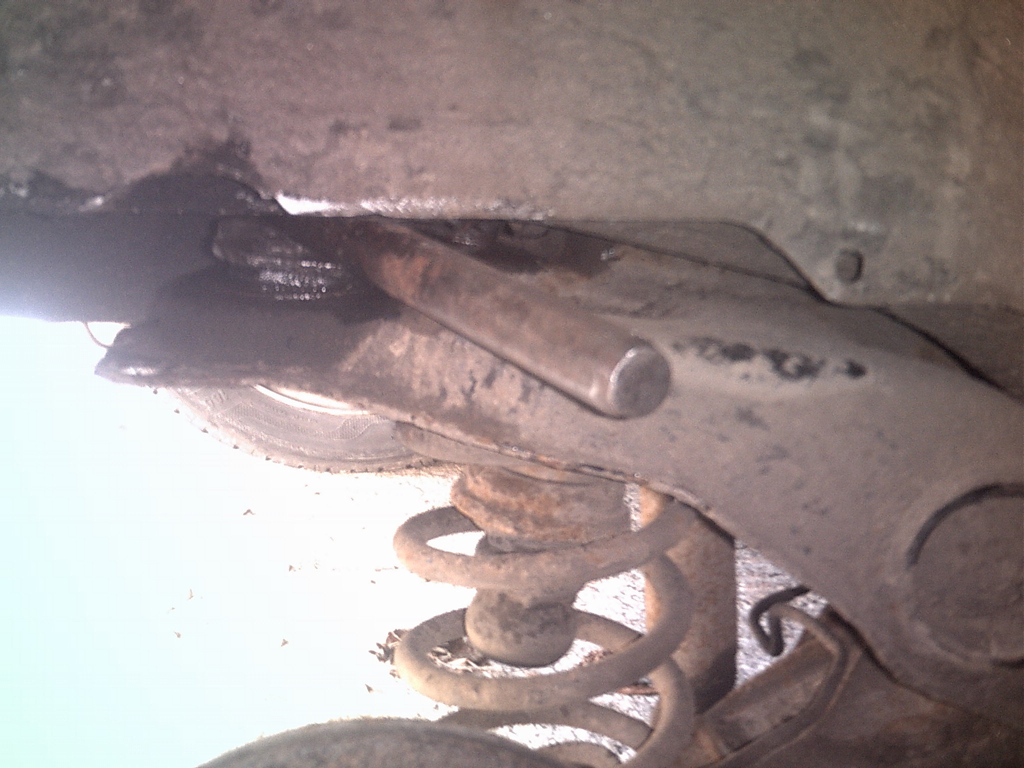

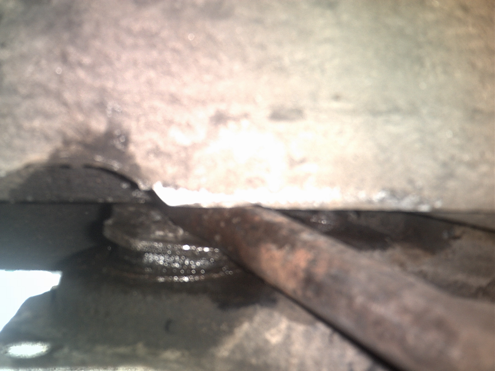

Working on the rear bush, bolt is out and bush is free from the top frame. Can't figure out which way it should come out now. Up or down? If it's up, how do you get enough space to withdraw it? I can't find anything about this in the Haynes manual, can anyone give me a clue?
OK, much easier to shift when both bushes are unbollted. Now do I need some sort of press to get the new ones in?:chin:
