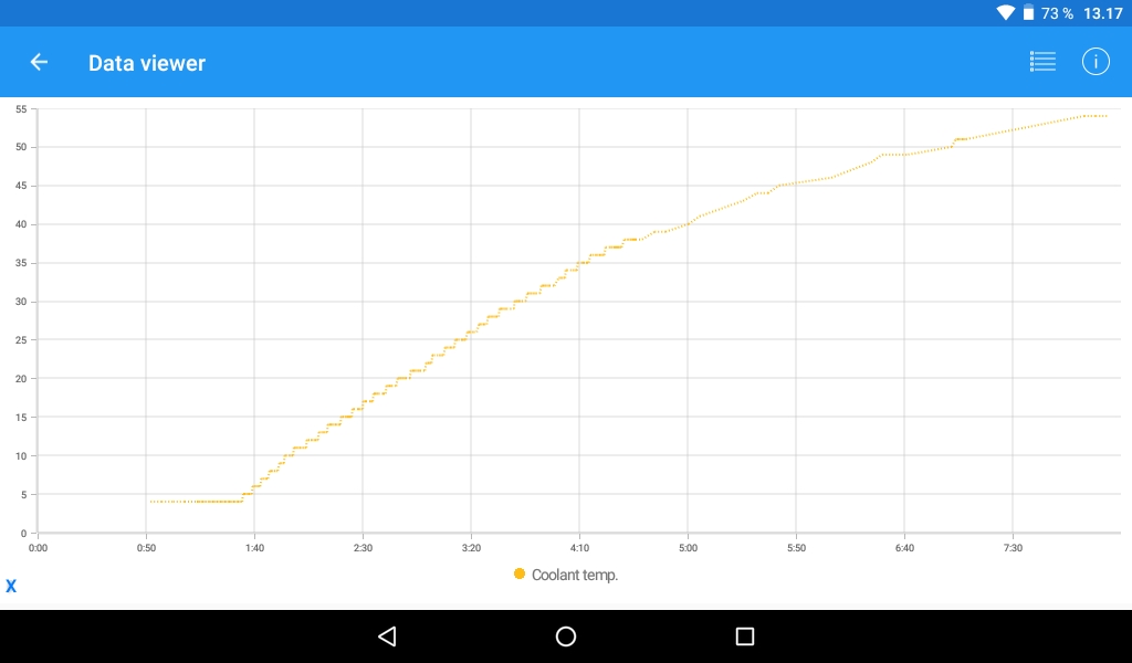

When engine cold before first start in the morning please use your obd reader and post what the ecu reads as the coolant temperature. Plus tell us roughly what the ambient temperature is where you are.

I didn't get the car to jerk noticeably and the coolant sensor reading appeared to be very consistent, starts from the ambient temperature 4 c and rises (see the attachment).

Very nice graph posted, thank you.
Coolant temp sensor looks to be behaving correctly.
Next time you go for a longer drive graph the coolant temp again and make sure coolant gets up to correct running temperature.
