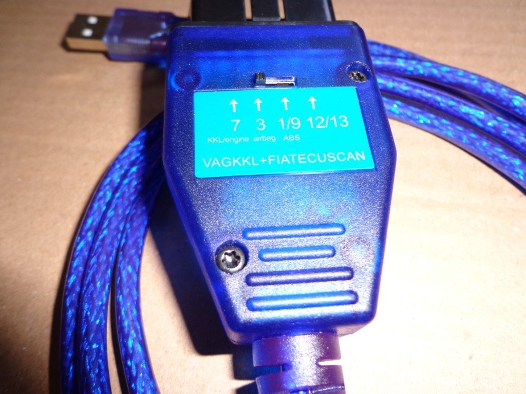

Hello I would like to buy a used multipla bipower cng 2002-2003 year and I bought Vagkkl interface cable:

My idea was that I hunt for the odometer km on dashboard, engine, abs and airbags but:

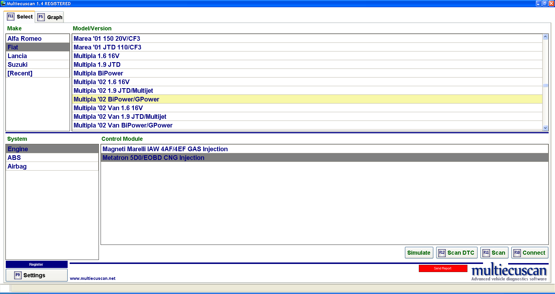

I played in simulation mode and in simulation in Multiecusacn 1.4 version I can only see engine, abs and airbags there is no dashboard and body (proxy alignment for example)
attachment.php
Do we have in multipla at all the dashboard, services, body, climate control and other system ecu options like on punto, bravo and other Fiat cars.
Or is this just it? Or its just like that in simulation.
Could I at all access in the dashboard and services if multipla have it at all, or do I need elm327?
In which places multipla writes the mileage odometer? And how can I access in all of them?
Please I need help, I need to understand this. Thank you.
