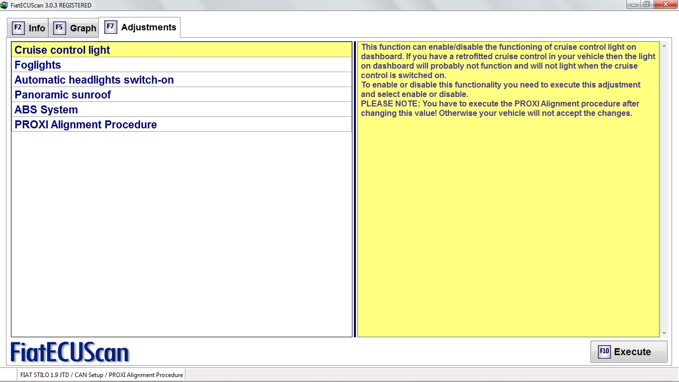

Also, can anyone give me a quick run through on how to activate the CC dash light, and would I need the paid version of FES to do this.

Where do I find this (sub menu etc..), I have the free version at the moment, and wont be purchasing this software until I have CC working. Will I be able to find it on the free version.

You need to be connected to the cars Body Computer(ECU) to access the CC light on function.

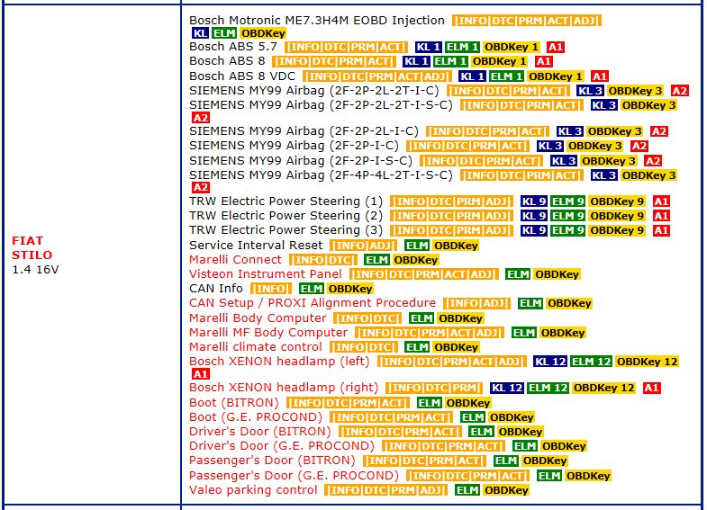

I've been playing with it this evening, I scanned for usable interfaces, found my ELM 327 v1.4 bluetooth adaptor, configured the port latency to 1 (far left on the sliders) on COM port 7 as the test was reporting a high latency, now the test returns ok, but I'm still not able to connect to the ECU? Have I missed something,
I've got bits per second set to 57600bps, on both the FES and the COM port.

You need the registered version to access "CAN Setup / PROXY Alignment Procedure" to set the CC light.
All modules shown in red type below need the registered version.

Ahh well that's not going to help, the fact I'm trying to connect to an ECU which requires the registered version. Cheers for that Davren, I thought I had access all the ECU's, but no ability to edit the setting without the paid version. Will have another try tomorrow with an ECU which does not require the paid version.
Registered or unregistered if you Scan for connectable ECU's(Modules) you should get a list of them similar to to this one. If you don't somethings wrong.
