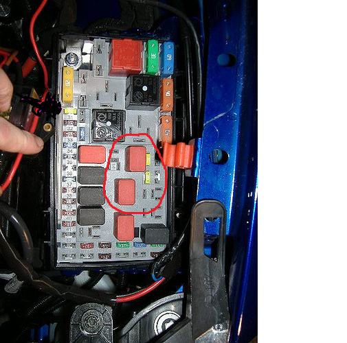

They have a starter relay in I have in a previoise post put a picture on it one of the small red relays in the engine bay fuse box fiat told me there wasnt one but sure enough there was I had the same issue just a clicking noise its a couple of quid fix
Thank the lord!! Can you send me exactly what i need to do and where to get the part please! Thanks alot its been driving me nuts

If memory serves me correctly its the two middle red relays, The dealer wanted £20+ each for them but I got mine for £5 each off ebay and I never had a issue after that.

You can do the job yourself the fuse box is located on the passenger side of the engine bay and its only two clips to remove the cover and you just gentley wiggle and pull the relay out and then just pop the new one in
