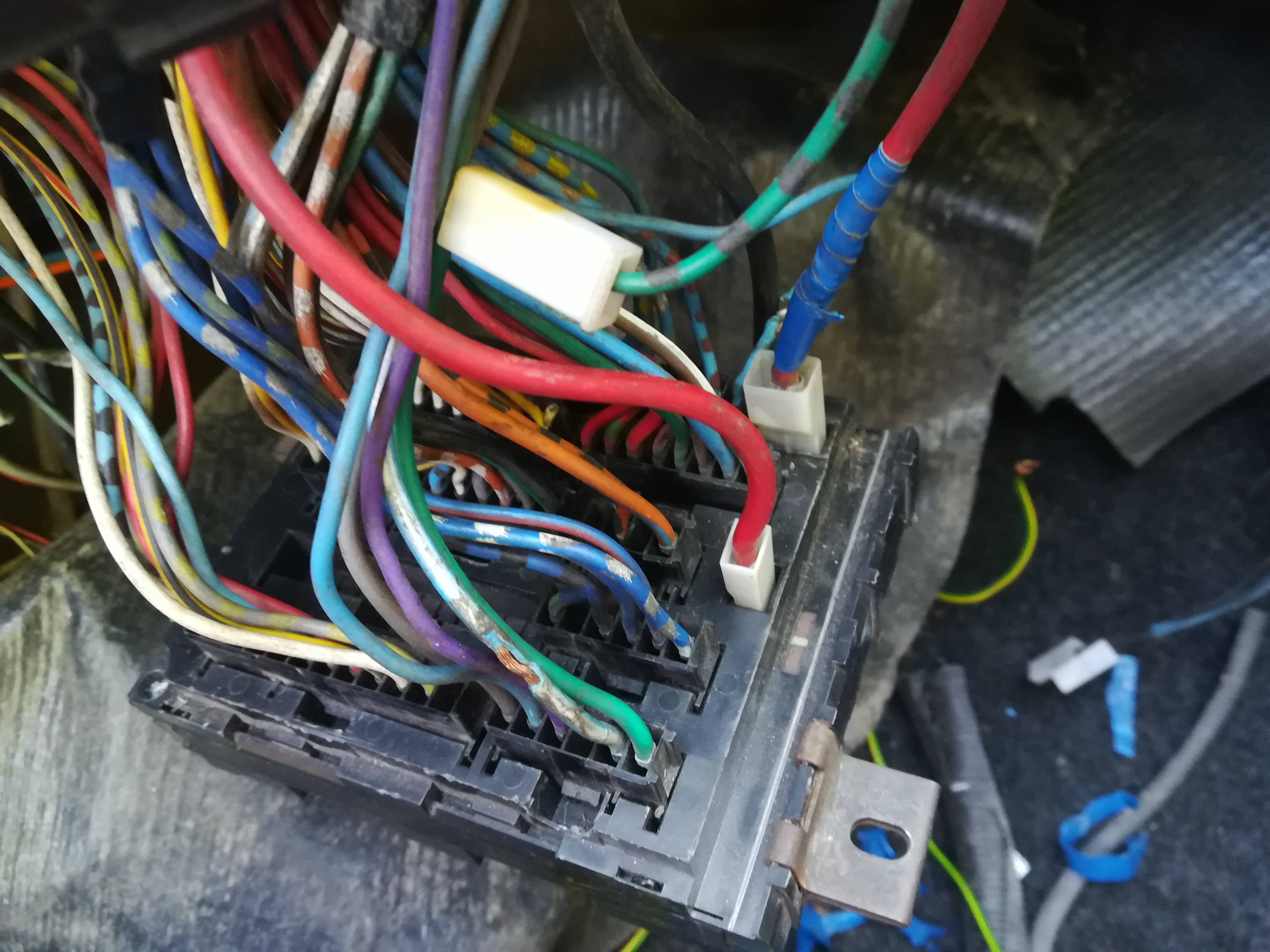

have just acquired a fiat strada abarth 130 with the wiring loom in a mess, can anyone tell me what connects in the connection hole near the relays on the front of the control unit fuse box.
also am I right in thinking one of the two power plugs(red wire) is the power from the ignition when the key is turned, where does this 12v source come from is it via a relay, any additional info or pics that anyone has would be useful, thks.

hi, thanks for the info..here are some pics of the fusebox, showing the connection hole to the right of the relays and the two red wires going into the back of the fuse box...the one without blue tape on is this a supply to or from the fusebox is it ighition controlled.

The big red single (with blue tape) wire on the top right corner in picture is the 12V feed direct from the battery +ve terminal.
The other red wire is a +12V feed from the headlamp main beam relay and supplies fuses 7 and 8. +12V goes from the battery to the relay (not in/on fusebox) and from the relay (when energised) to the fuse box.
The ignition switched 12V feed wire is the Light Blue/Yellow wire located next to the end Brown/White wire in your picture 2. In this picture top right is the red wit with blue tape. Directly below you will see a brown wire with white longitudinal while stripe. Move one with to the left of this brown/white wire. That is the ignition switched +12V feed.
