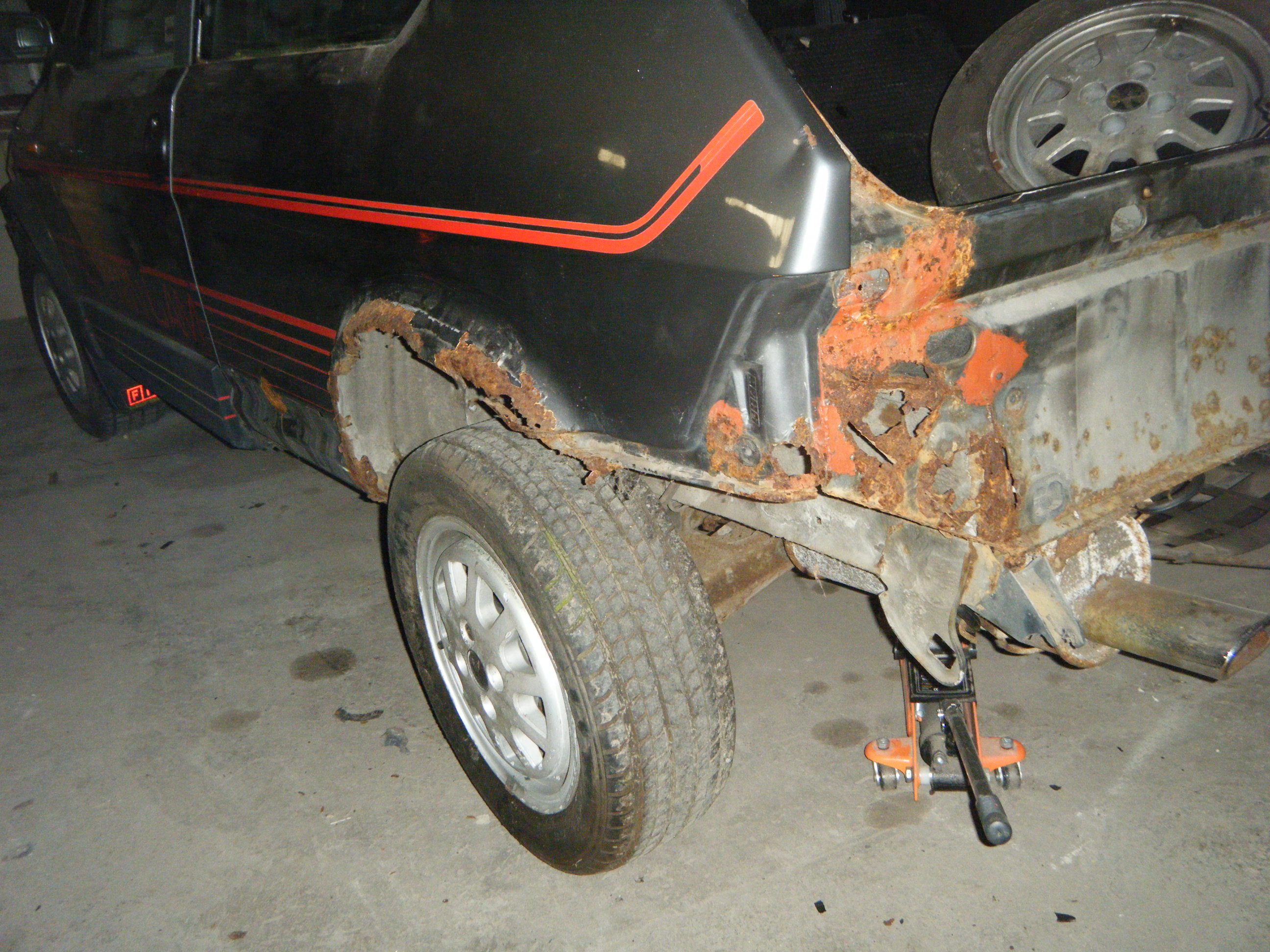

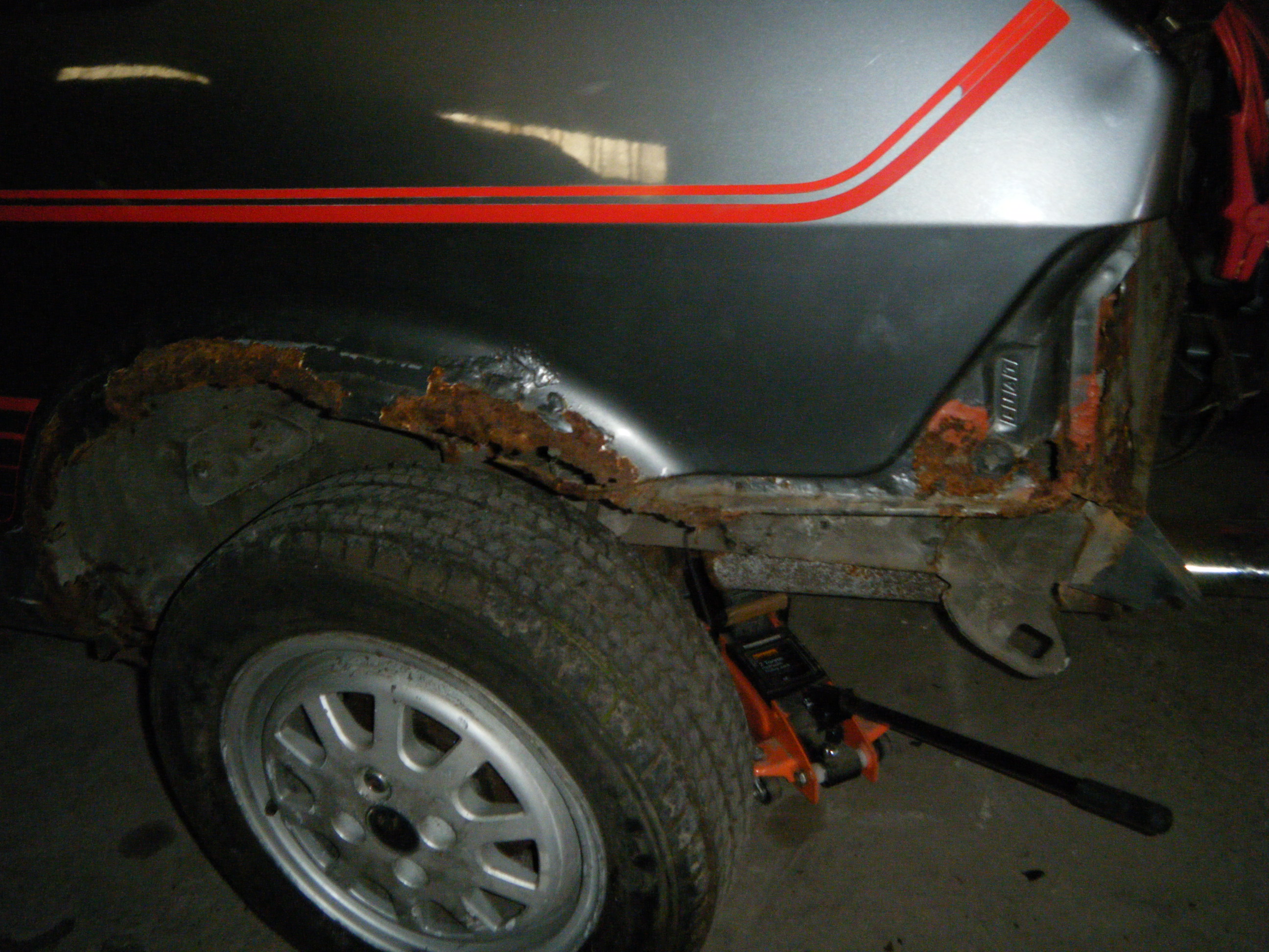

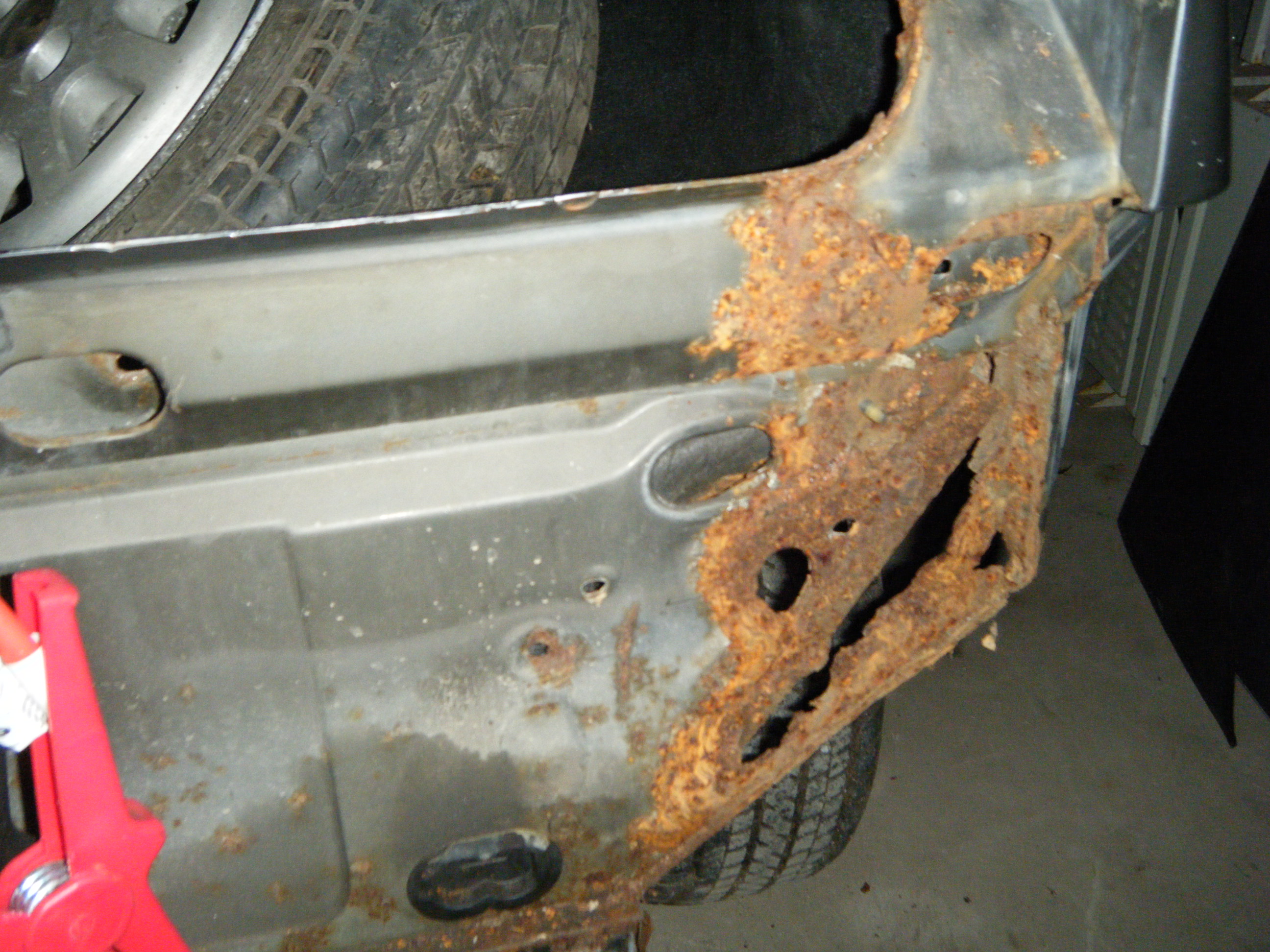

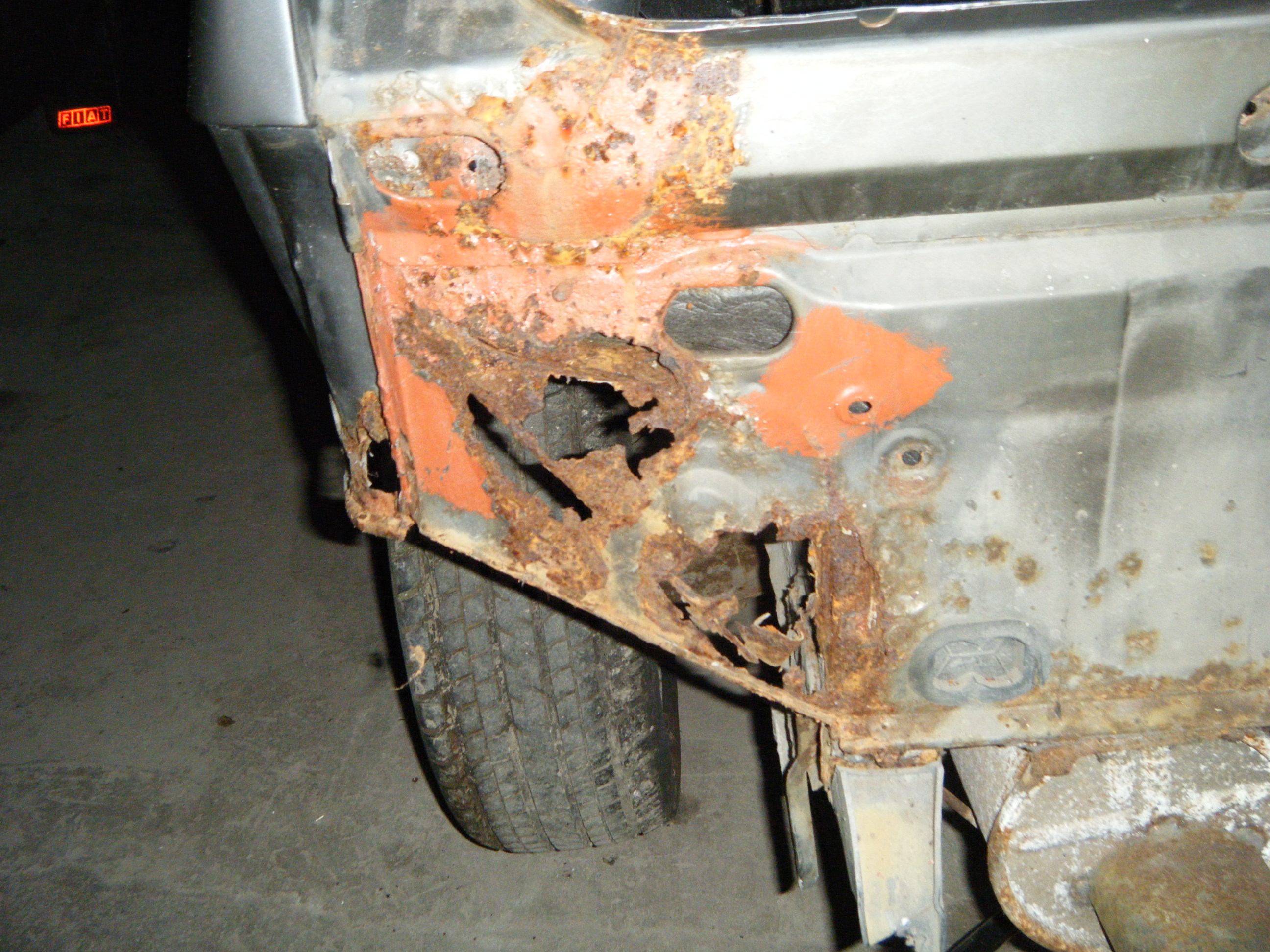

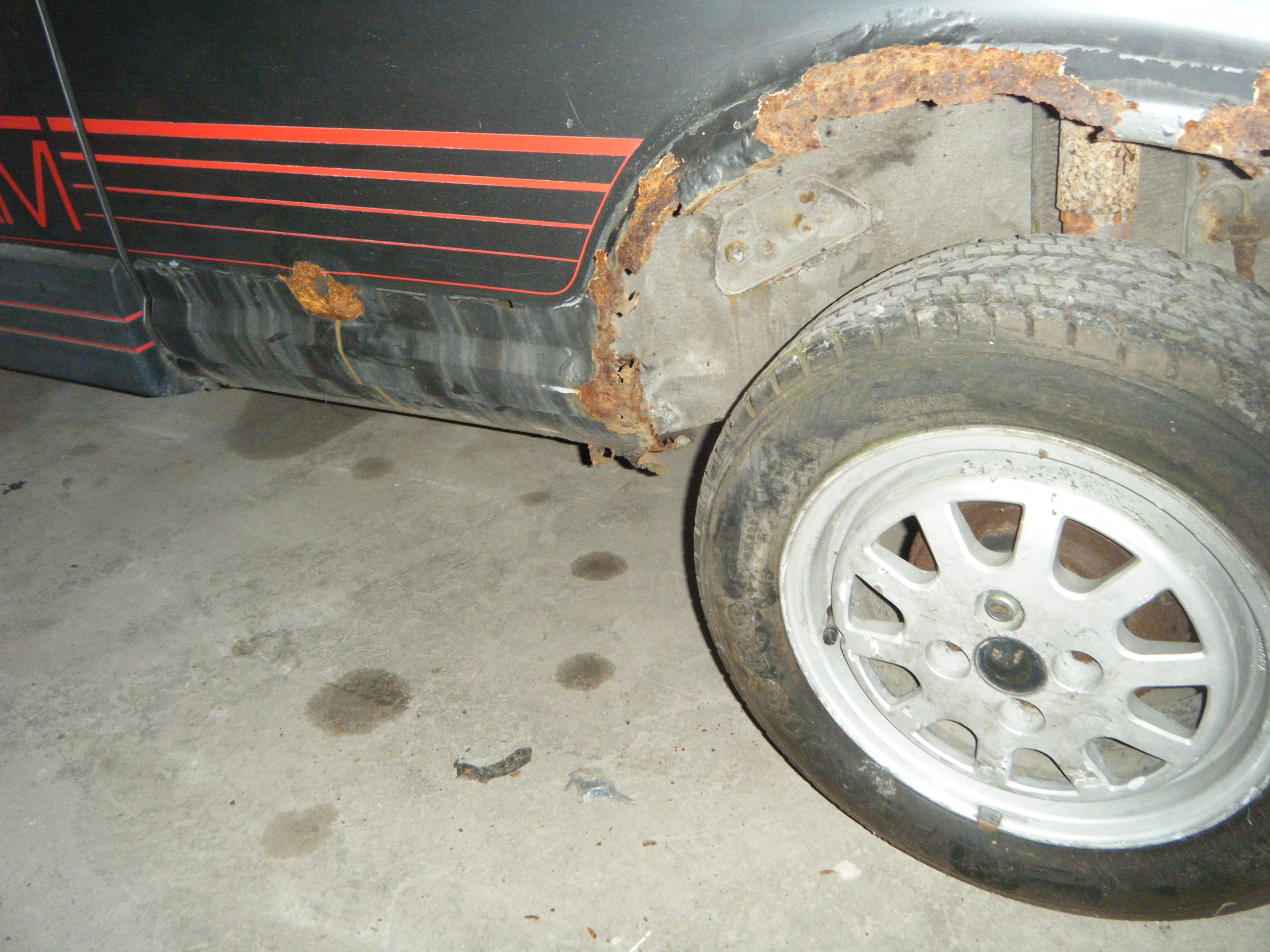

I got courage today and removed all the plastic mouldings from the rear of the car,The photos speak for the condition of the metal ---- the salt on the roads does have a majour effect.

Just to add looking at the pictures in 4 and 5 of the back panel with the two holes this is normal rust . It only needs a rear panel and behind the rear panel with the two holes it has a strenghten piece one on each side to stop the back of the car flexing . You can fabricate these quite easily .
