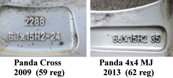

As in the supplied photo, people miss read 24 and 35 offset being nearly the same, but they're wrong. The 24 is actually -24 offset, so the wheel is 'poking' out of the car more than in. While the newer cross wheels are offset 35 and instead 'poke' into the car from the centreline So could never fit on my mk2 Cross.
I don't if anyone has looked at 100hp wheels but their negative offset must surely be 'more' than -24 to fit on the Pandas hubs or are the 4x4 axles alot narrower than the normal car?

I need to confirm but pretty sure the 100HP has ET 32mm.
If the wheel is sitting too far towards the suspension (large ET), you can fit small spacers under the wheel. If the ET is too small you will not be able to use wider tyres.

The thing is the cross has -24 offset to the 100hp's 32 offset, so there is a 56mm difference in where the wheels sit on the the hubs. At least at the rear, the cross's wheels are already rather close to the arches, so there is no way 100hp wheels could fit on :-(
I have considered spacers, but they do tend to gt a bad press, I would only need 5mm ones however to get the space required for 185 tyres which I cannot think would be too bad?
Spacers are fine for correcting a wide ET. They get a bad press because they are more normally used for cosmetic reasons on correct ET wheels.
You might need longer wheel bolts which can push up the costs especially if they are an unusual length.

It also has a hugely wider offset compared to the cross with the tyres sitting I think 50mm further out from the hub compared to the cross (-24 compared to 100hp +35 as shown in my picture).
This wide difference of where the wheel sits on the hub, leads me to think that minor adjustments to the track using a spacer will not have any issue wearing out the bearings, weather they weaken the wheel attachment is another matter however :)

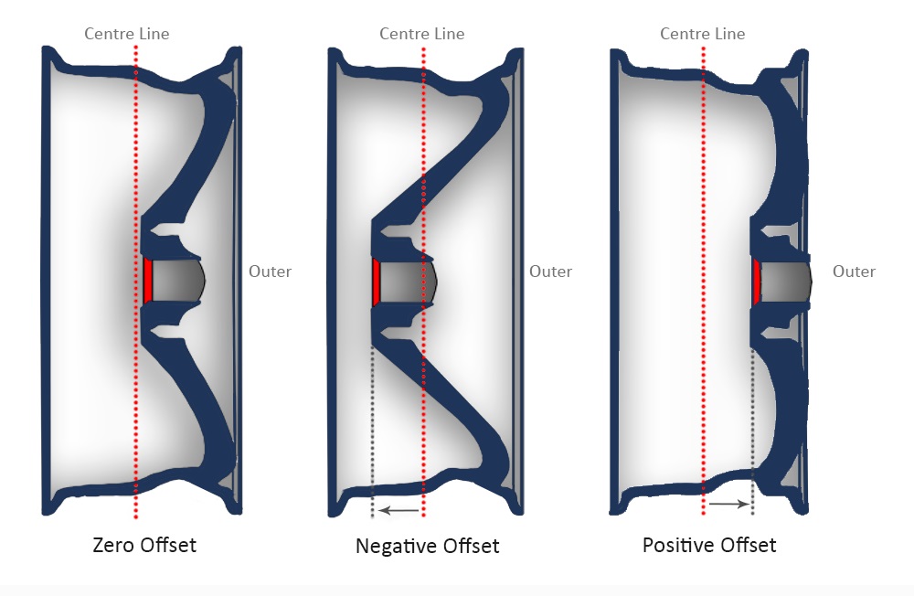

Have a look at this web pic on offset, it describes the same negative offset.
As with my cross which has the middle type wheels with little arch space, there is no way the 100 hp type wheels like the right picture would fit on :-( Much like I would want them too :-(

I am well aware what offset means and how it would look.
Maybe the wheels you are compairing are not made by the same manufacturer which would explain the difference in notating the ET (EinpressTiefe in German).
Negative offset is very unusual and mostly used on RWD widebodycars like a König W126 coupé Mercedes.
You could take out the measuringtape...
gr J
