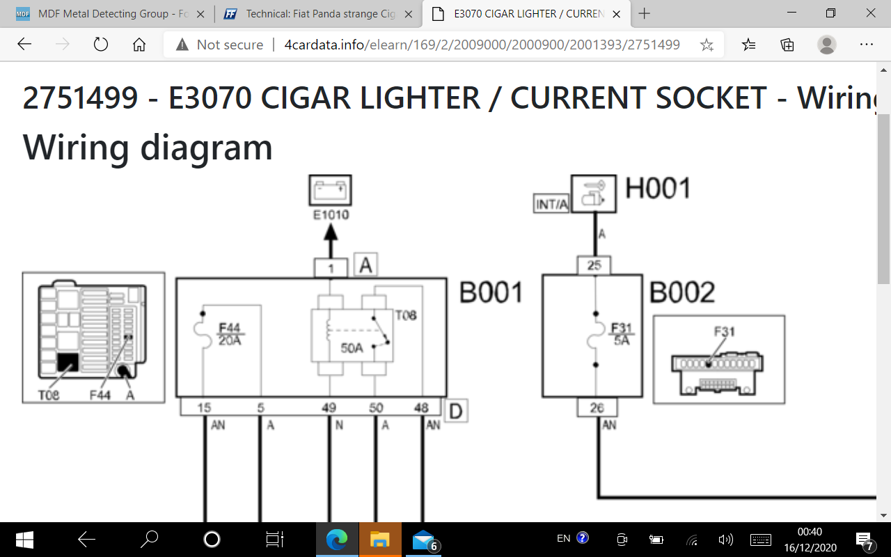

does the led come on with the headlights
they can be wired quite differently correct locations are in the owners manual. Also printed on the underside of the fuse box cover
heres one option
the link can be missing in the passenger footwell. not the case here as it was working
earth is under the bonnet Black box in the centre of the scuttle

So an update. Started checking the fuses and found that a 7.5amp (f49 I think) in the fuse box under the steering wheel was blown.
I replaced that and the cigarette lighter works, as do the lights behind the buttons above the fan/heater controls.
No idea why that fuse powering the 12v socket, but it is!!!
