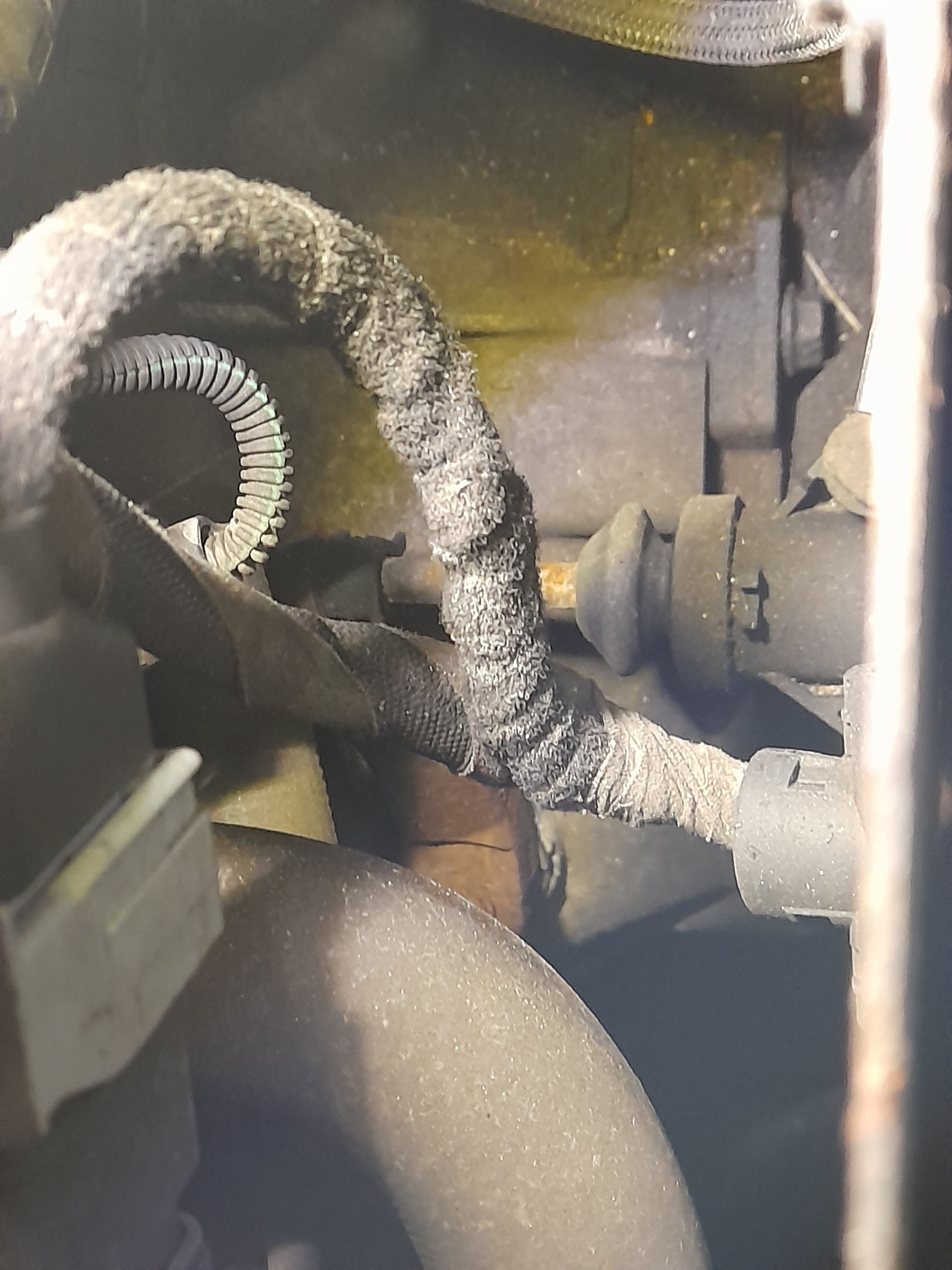

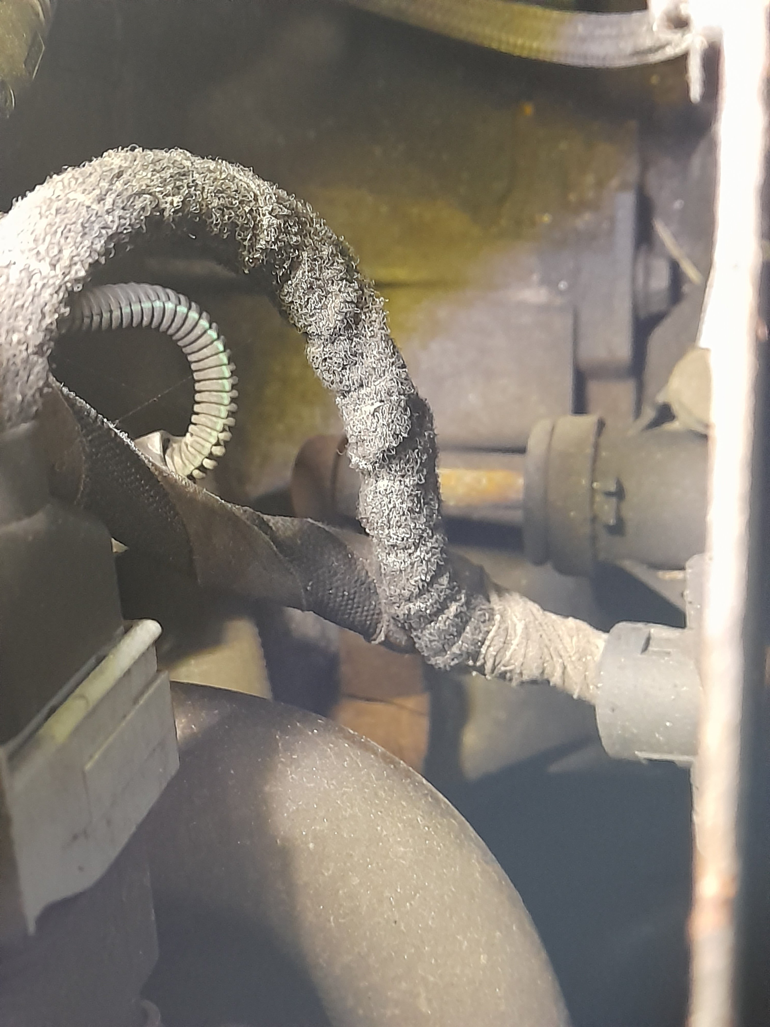

I couldn't get a tape/ruler on the slave but took 2 photos of the slave clutch pedal up and down, does the stroke distance look about right?

Looks like it is in photos
Here's mine working clutch
They don't move as much as you'd imagine
Looks 15mm in the video, 17mm rings a bell but can't find a post where I measuring more accurately than in the video
